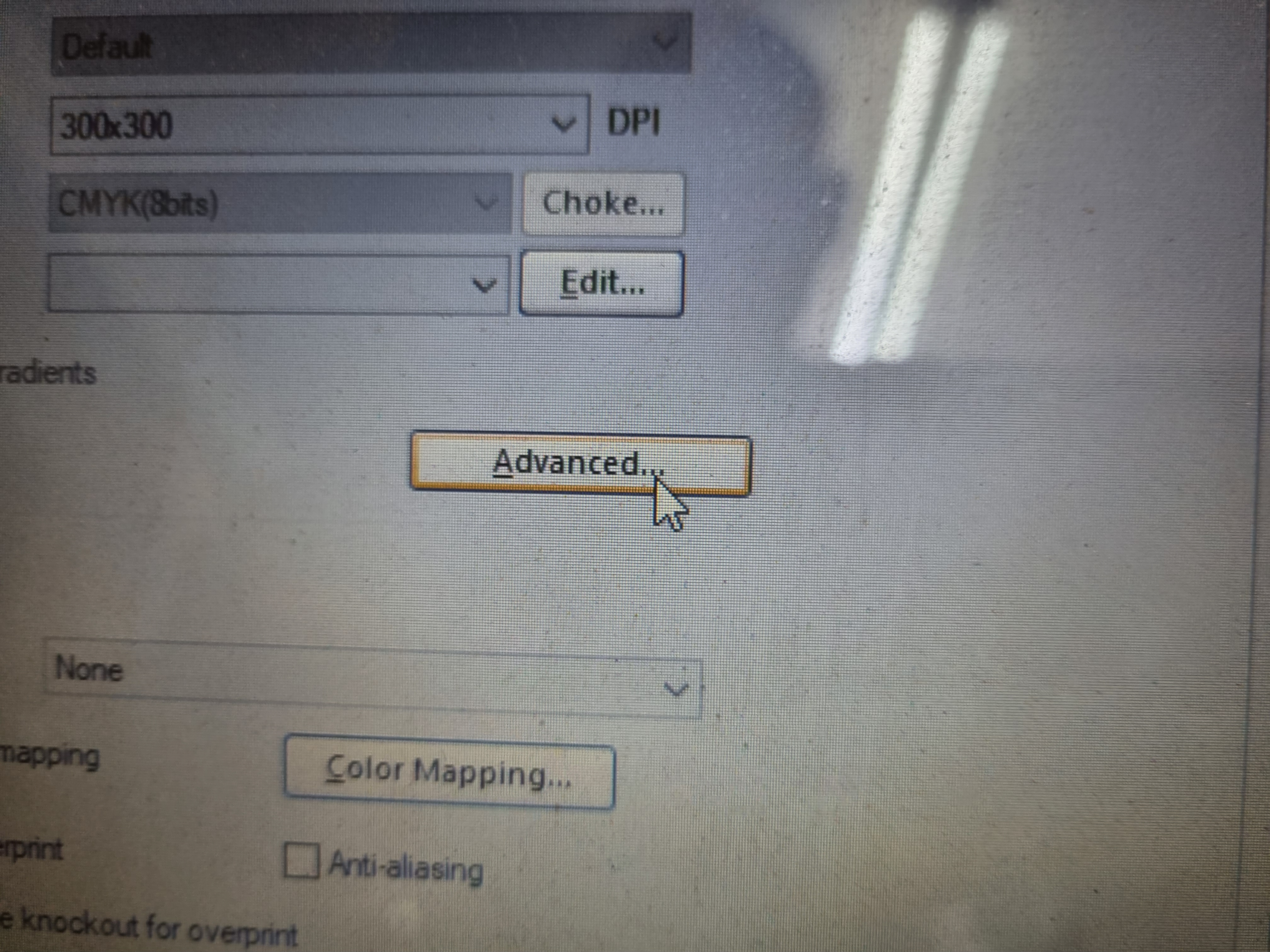

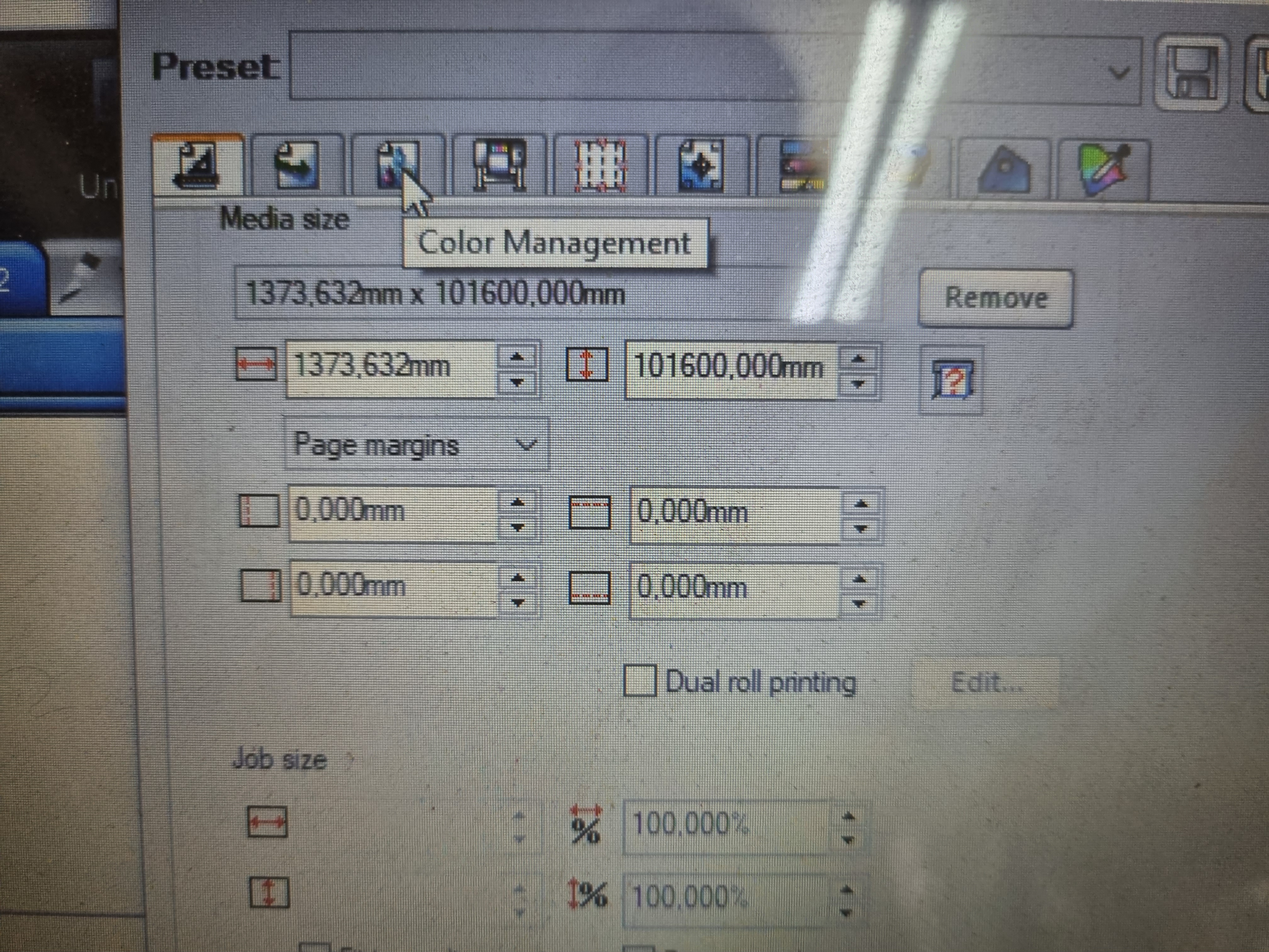

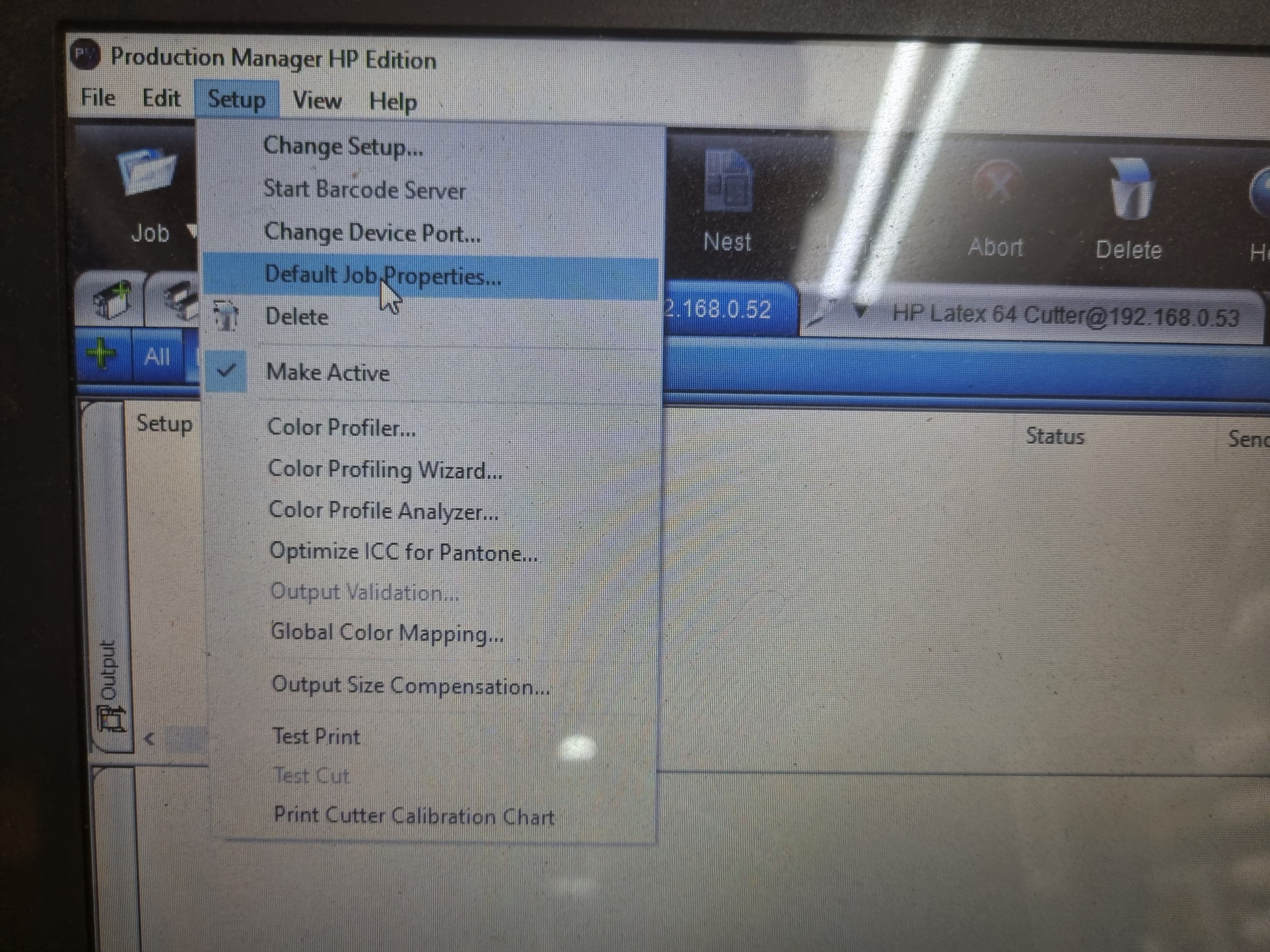

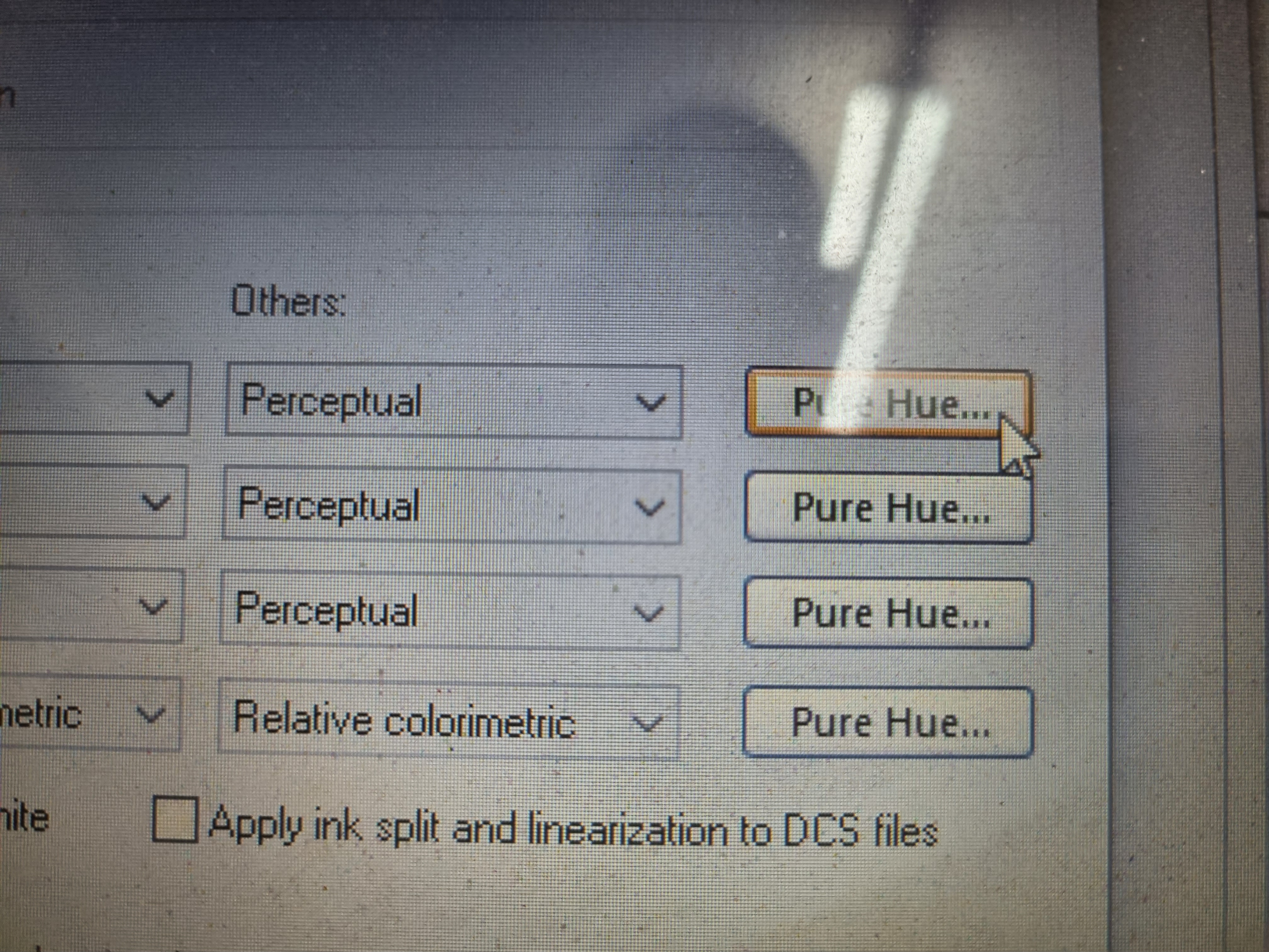

We had the same issues. it's got nothing to do with heads etc.... We ran 2 HP Latec 335 machines and both from new printed all greys with a purple hue.

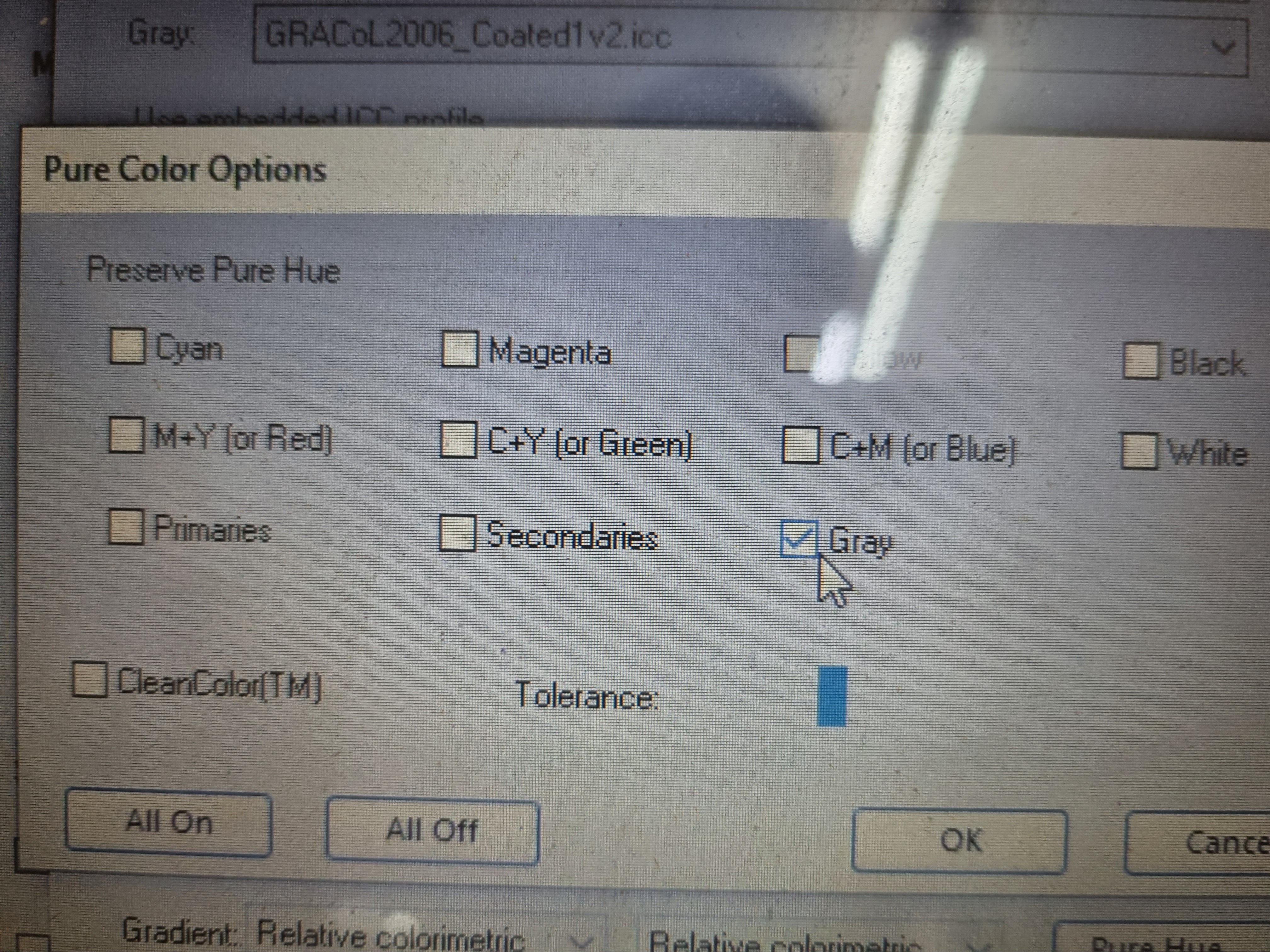

My workaround is: Take your generic front lit pvc banner profile and create a copy, create your passes you want to print 10/12/16... Adjust the temp and other setting accordingly and there you go. For some reason the banner profile prints grey the closest.
If the grey is still a bit out go to default job properties - colour management - advanced - pure hue - click the gray tab and move the tolerance slider to the right 20211019_171835.jpg 20211019_171844.jpg 20211019_171854.jpg 20211019_171906.jpg 20211019_171919.jpg

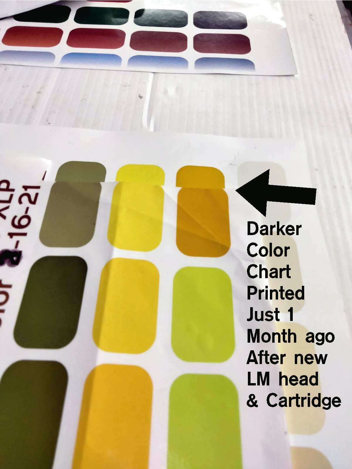

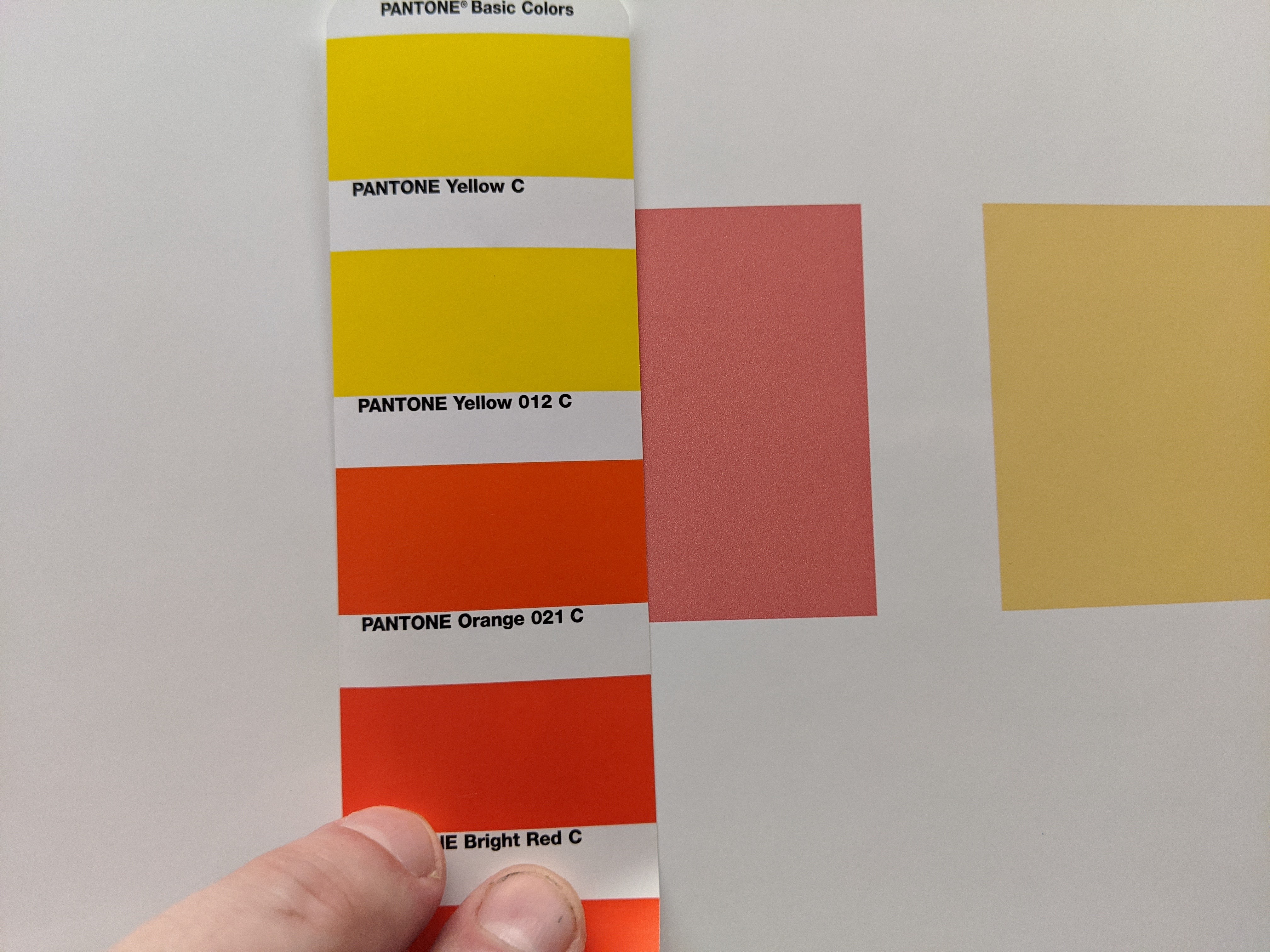

Now that I recall I did print a few yards of brown before I calibrated. My imitation gold color and reds were all coming out lighter than my chart of just 2 months earlier as image shows. After the shake them up maneuver my charts matched the earlier chart and my grays were quite neutral. My printer is 7 years old, I am not a new user, but you are correct the ink in the lines needs to be run through.

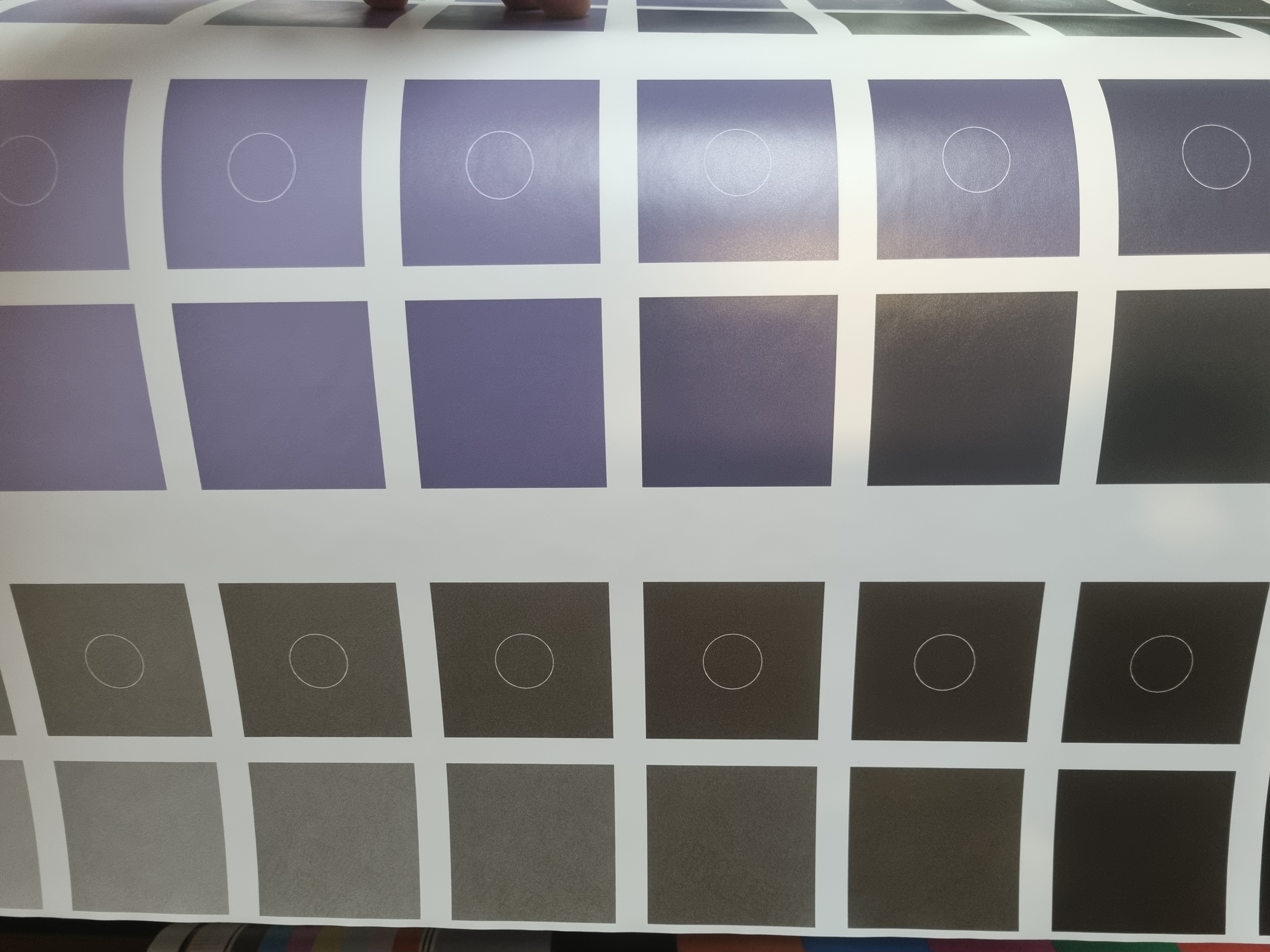

My HP Latex 115 is printing grays with a purple tint, blacks do not seem as rich as they were a couple months ago.
