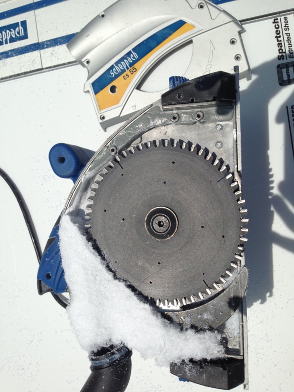

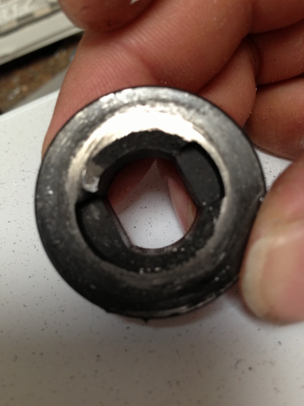

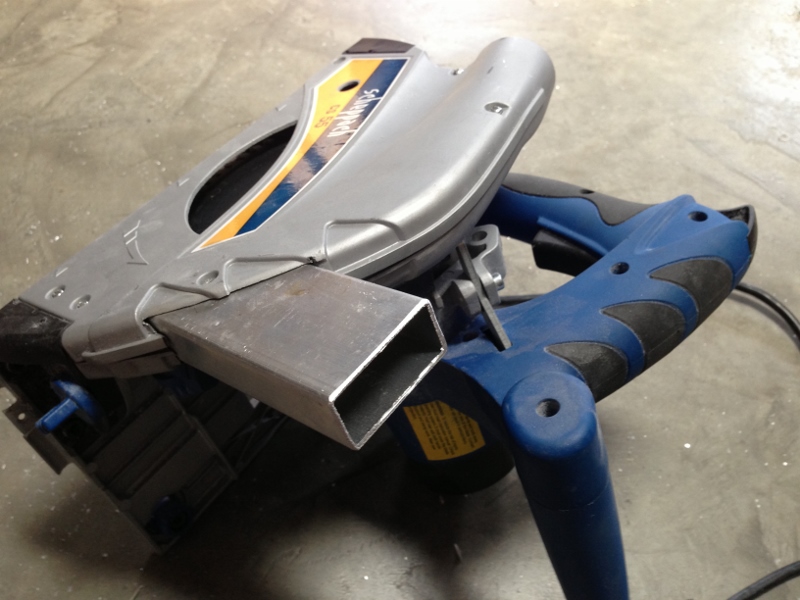

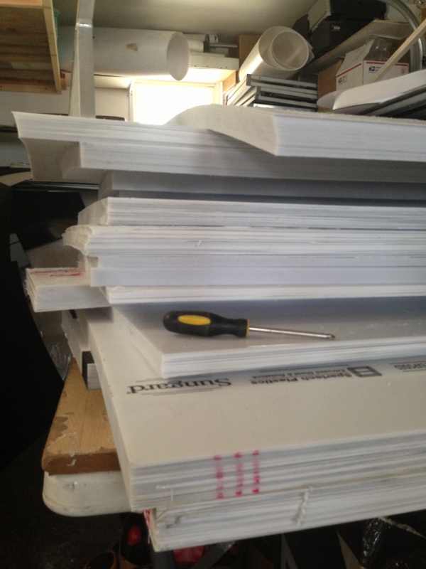

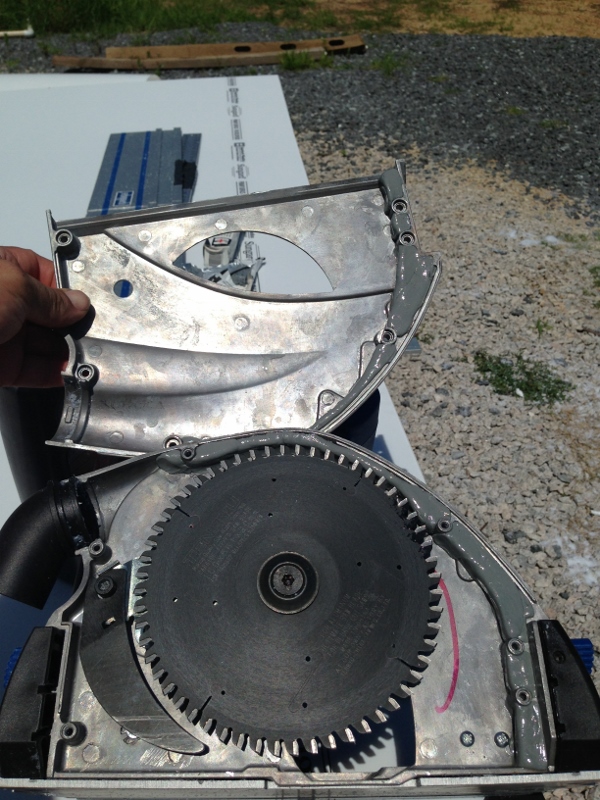

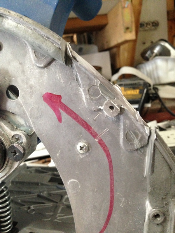

    IMG_1416 (600x800).jpg IMG_1417 (600x800).jpg IMG_1413 (600x800).jpg IMG_1414 (600x800).jpg IMG_1418 (600x800).jpg IMG_1421 (800x600).jpg
    First photo shows the material I was cutting
    2nd photo shows the damaged bushing. IN fairness I was cutting on a piece of warped plywood as a base with a piece of 2" styrofoam on top, the uneven surface was the #1 reason for the kick back and eventual failure of the $2 part which you can buy from grizzly part # 61 or #65 forget which one.
    4th picture shows acculated shavings when NOT using a vacuum.
    3rd picture shows epoxy putty put around perimeter edge in hopes of making flow of chips to back more effcient. It helped a littlle, but you still need a vacuum.
    5th picture shows an angle grinder cutting out a 1x2" area.
    Last photo shows 1x2 piece of aluminum which is the new better positined dust/chip removal port.
