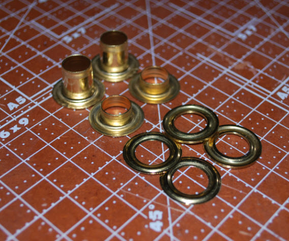

OK a little late for this discussion but...I have HIKER Grommet press using 3/16" flutes. Put a flute in the top and one on the bottom instead of the flat ring. Press a little more than 1/2 way down but through the coroplast and presto. You just need to take an exacto the the middle to pop out the coroplast in the hole. It took me a couple of practice holes to get it right but it works. I have done a couple of jobs this way and they have all lasted to date.
jiarby
uh...
so just buy some longer Hiker Grommets! Look on page 118 of the Ghetto Cowboy's catalog.

The longneck grommets from Hiker will work fine. The neck is 1/2 inch long, but some of that gets used up to curl under and secure the grommet washer. Hiker says the long neck is good up to 7/16th thick... should be perfect for 10mm coro (390mil)
