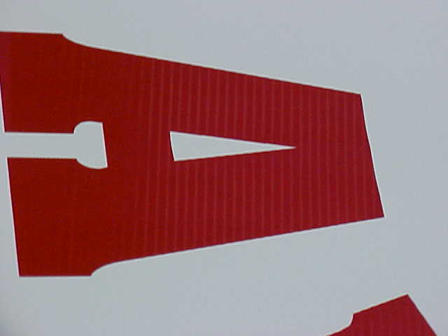

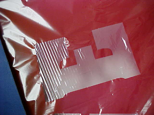

Of course in the middle of a rush job and the gerber II starts "stuttering".
Seems to do it with the RUBY RED foil and GCS-GREEN onto Oracal 651 white, as a solid fill. ran 5 other colors on the job and others are fine. Our foils are a mix of Apex and Gerber.
Any suggestions?
Thanks in advance.

Set your job to Edge 1 settings to slow it down if you haven't already. Some foils just won't lay down correctly at Edge 2 speeds. if that doesn't do it, switch the job to a Gerber material.
We've used Oracal 651 for a lot of Edge printing but have had to return to 3M-Gerber material for some combinations of foils ... even on our Edge 1.
