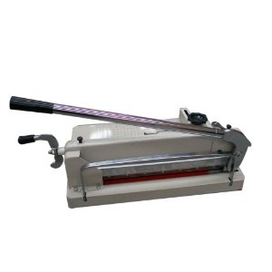

Does anyone use one of these- looks way better than a normal paper
cutter- I think the blade cuts parallel to the paper? I have an old hyd
paper cutter from the '40s or '50s that cuts like this (weighs about 1000#)
that works great for plastics etc but is s l o w. If it cuts parallel and you
could rig a laser I think it might be useful. About $130 on Amazon BTW.

You get what you pay for. A decent manual Guillotine cutter is $1000+. I have that exact same model as picture, bought off ebay for around the same price. It is cheap and I feel like I am going to break the handle. The handle is hollow. If you put a large stack of paper to cut, you need to clamp it down super tight. If not it will skew and cut crooked. The measurements and guide don't seem accurate and it is hard to get exact cuts. I would in no way attempt to cut plastic with it or any hard substrate. There isn't enough leverage. It works for me since we use it rarely to cut some prints down to full bleed.
And yes it cuts straight down.

these cutters are specifically designed for cutting stacks of paper to the millimeter...the manual cutters like the one you showed us are pretty much worthless, ive had several and have never been happy with them. the electric cutters however are very good at what they do. i have a triumph 18" electric cutter and it works excellent and cuts to the millimeter when the blade is sharp. i keep about 6 extra blades and they need replacement and sharpening about once or twice per month. i think for cutting decals a roll cutter is going to be more productive. it self sharpens, will cut to the millimeter also and is good for 1 sheet.

+1. Had a friend that went through (2) of these manual ebay/amazon cutters. It was difficult getting straight cuts with them, and the claps gave out easily. We have an electrical 20" triumph and bought it used for $1200. If you want a dependable manual cutter, I suggest a Triumph or Dahle. But if a perfect straight line doesn't matter, you can get away using the one you showed us for around 6 mos. - year before things start getting loose.
