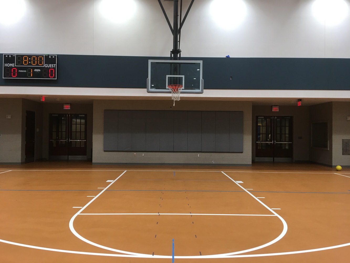

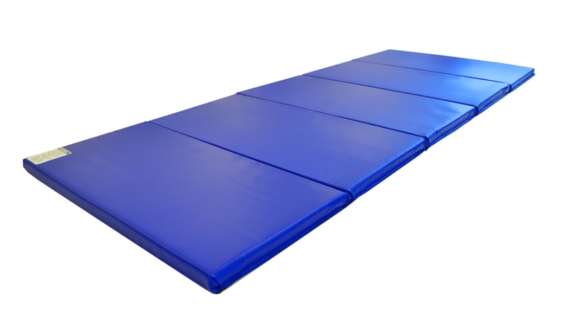

We are invited to bid on a job for a school.
They want us to apply their logo (two colors) on one of their padded gym walls (not floors).
What material would you use?
Thank you.

We have been approached to do a similar project.
they want the team photo paneled onto the portion of padded wall under the basketball goals.
the pads overall size is about 72"h x 144"w
we were planning on bidding using a high tack vinyl with lamination
Has anyone done this?
What adhesive vinyl / material did you use?
Any comments about installation?
What suggestions would you have
What do we need to look for and ask about prior to taking on the project?
