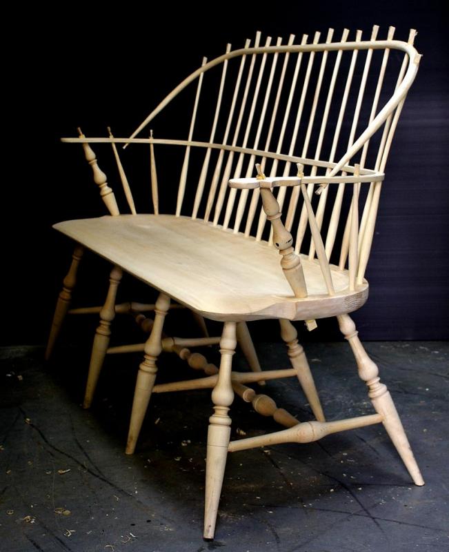

It's been a while but here is where I'm at. Now I have to trim off all the wedges that were used to lock all the spindle joints and paint the thing.

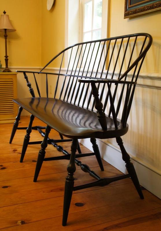

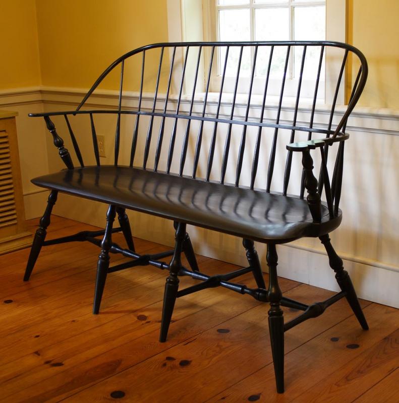

Here is the finished product. The finish is 3 coats of milk paint and a light coat of lacquer followed by paste wax. (with lots of buffing between each coat.) I couldn't be bothered to go get bees wax and turps so I just used some Butchers wax I had on hand. Normally I would mix up bees wax, turps and dash of linseed oil but where I'm only doing one of these I didn't really want a whole batch of the stuff sitting around. I've got quite enough clutter here as it is.
Kinda hate to call the customer.....this one looks quite good in my dining room. If anyone was wondering, I charged $1800 for it.
