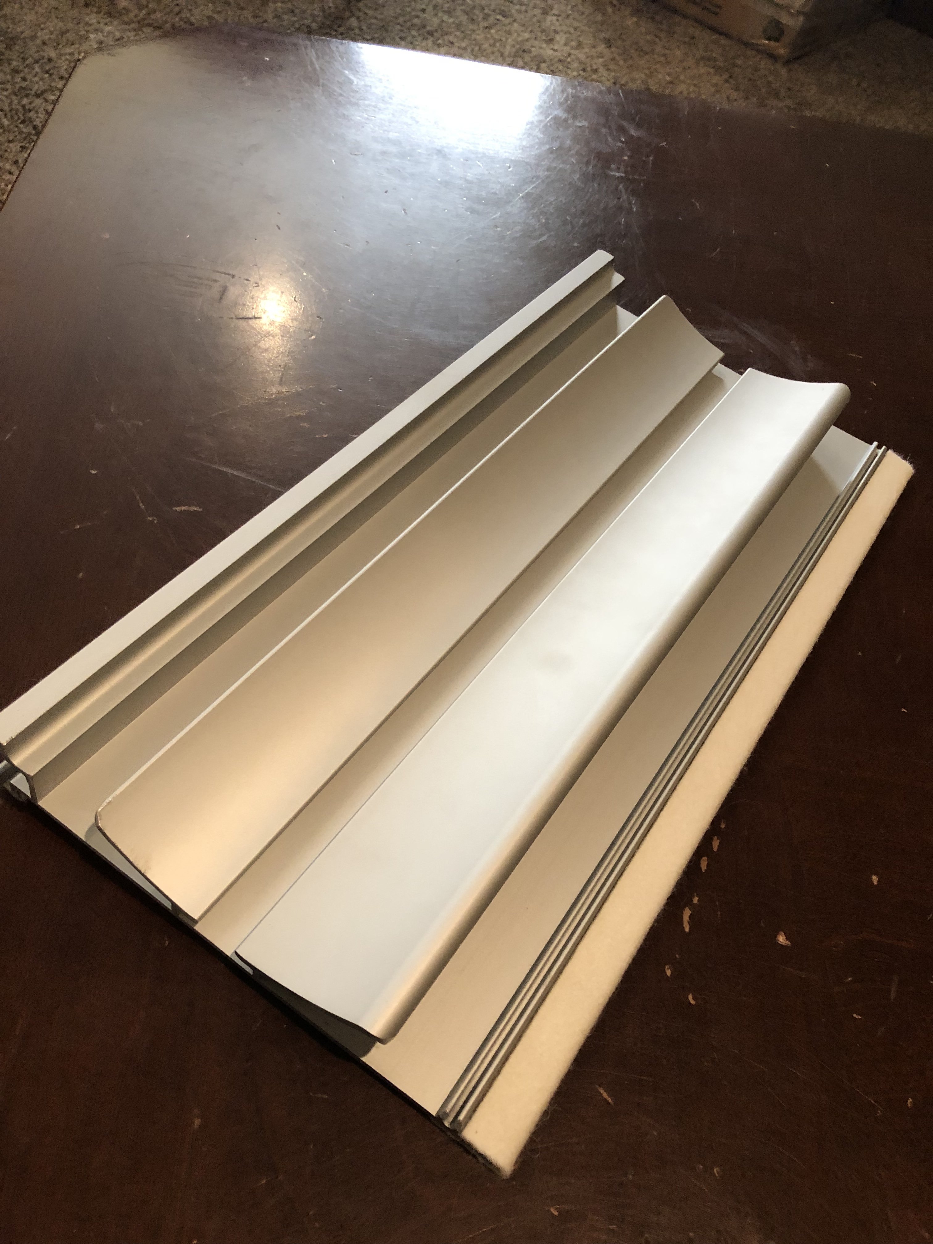

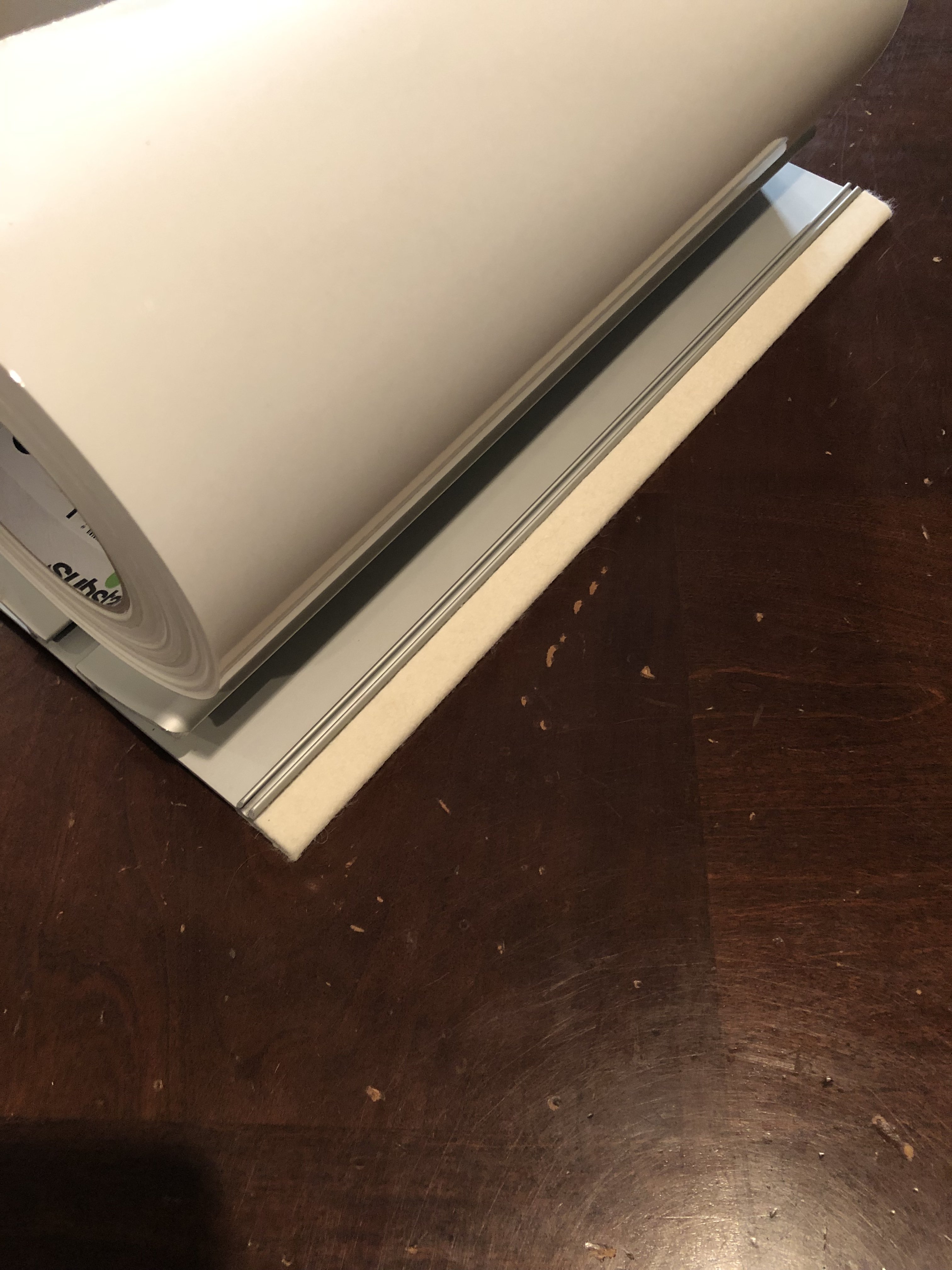

hi, I attached photos to help understand but I am having trouble laminating my vinyl and keeping the laminate on straight. I see people have the laminate on top of the squeegee, like the fist picture, but I do not know how to set that up. Can anyone help or does anyone have a link to a video to help me? Thank you

I use the bigsqueegee like you have daily to laminate small piece. Tape your vinyl on a perfectly flat table, layer your piece of laminate over the vinyl and tape the same edge. Then flip the laminate over the BS and remove the liner maybe 1/4 of a inch. Keep the BS at a 45 degree angle and push the laminate. With your other hand pull the liner at the same time so it don't go under the squeegee. It take some practice, but it is doable. I've never been very successful for piece over 30in wide tho. For that, you need to be 2 person. The main thing to have is a perfectly flat table.
This is exactly the technique I use:

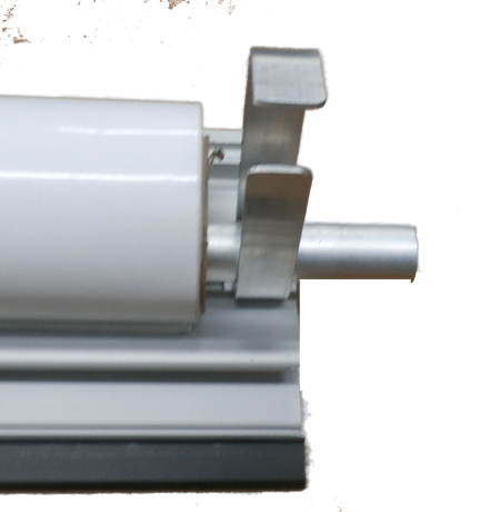

The Big Squeegee will work on this job. The one you show with the roll on top is to short to use a roll holder to hold it in place on the squeegee. However, once you get it started the roll can move down to the tip for application.
It is best to cut the laminate to the size of what you are applying it to so you don't have the roll issue. We are replacing the roll holders with a metal one. but have not got that in the website yet. If you want that set up give me a call or order and send me an email to tell me that you want the new style. I have posted a picture of it below. As you can see, it requires some space at the end of the tool to accommodate the roll holder.
