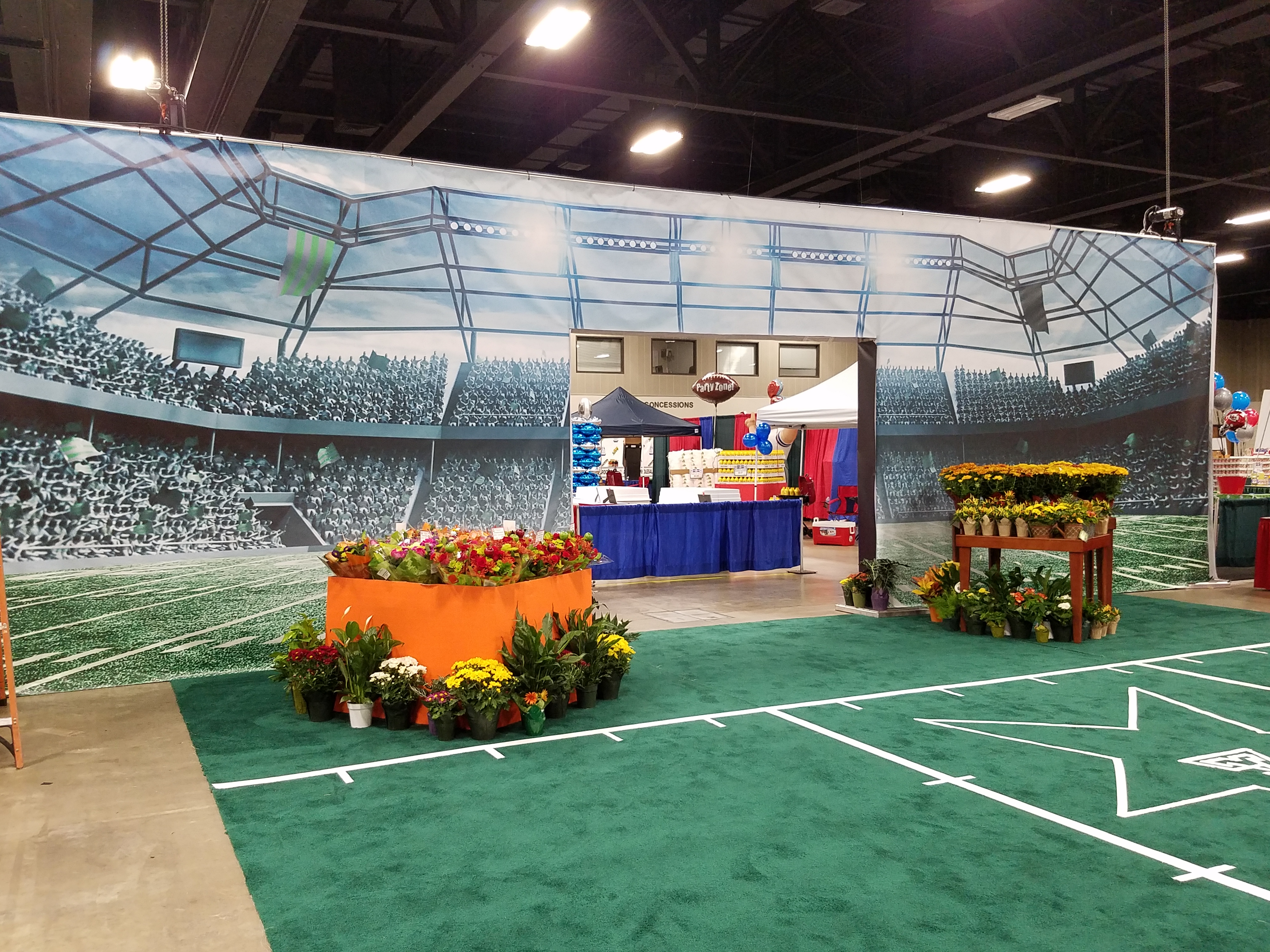

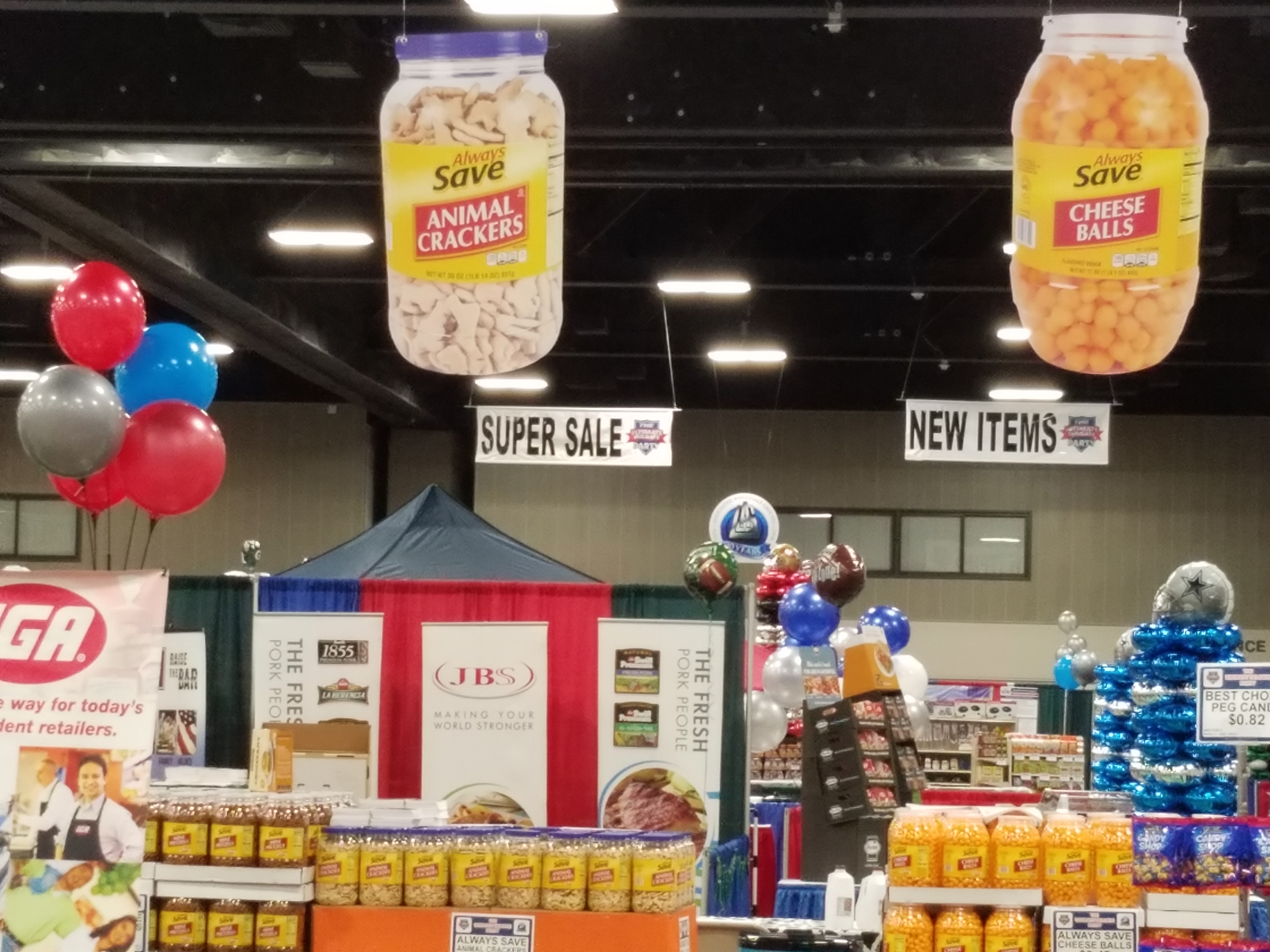

I've got these banners in that we did use 1.5" i.d. pvc pipe, but the majority of the banners use the 1in conduit. Now days we typically do like a double sided coro or foamboard sign so we don't do that pole pocket as much. For tradeshow backdrops we use the regular 8x10 telescoping stands, have it attached to the pipe and drape, or use a tradeshow display from a vendor.
Attached is a picture of a job from a few years ago. Larger banners get trussing like in the other picture.
