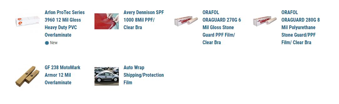

not sure how they will be with wrapping but these are lams made to protect the graphics/vehicle

No, I'm charging for the redo installs as it is no fault of the vinyl, just ultra rough handling. I would like to find a solution to offer customers like this if there is one though, currently it protects his paint at least but still a pain to have to keep redoing panels all the time. Do you have to cut the PPF film into smaller pieces and overlap for curves? I was under the impression it did not conform very well.
2B
hopefully, the damage is happening on flat, simple curves.
if so get a thick lamination
Arlon 3960 12 Mil Overlaminate

Sadly some of the damage is happening to the front of the dually fender wells, which have very complex curves. (Don't ask me how he managed to get rock chips up there) I'm looking at the 8 mil PPF by Orafol - Oraguard but it seems like it's all made for flat surfaces. I basically need the PPF equivalent of cast vinyl lol.
