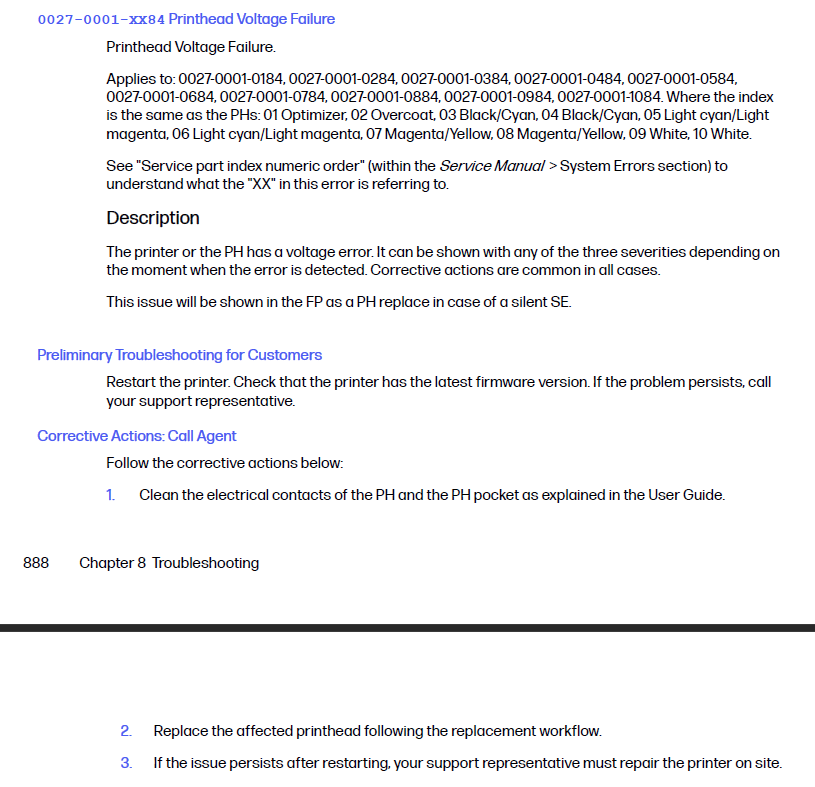

that could be a bad printhead, swap it out and see if the error goes away.... on the HP knowledgebase website people recommend cleaning the contacts to the printhead as well as the ribbon cable that supplies the printhead..... the error is also listed in the manuals that come with a new 700W

You need to look at the attachment in post #6 and do a search using 0027-0001-0184, 0027-0001-0284, 0027-0001-0384, etc until 0027-0001-1084
when a printhead burns out, usually there was a spark or something at the nozzle - checkout your bad printheads, almost all will have some sort of physical damage.... (I mean, it is not a software issue, something actually fails on the printheads, right??? most I have seen look like there was a pretty good explosion - granted I am viewing at 250X magnification

Is this screenshot from the service manual? If so, do you know where I can find a copy? Thx
You can ask your tech if they wanna share it.
