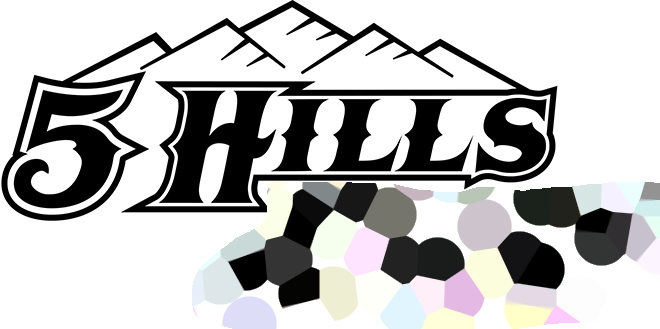

I have a customer who needs some hats embroidered, can anyone on here sell to me wholesale.
One color design on the front of the hats, see design below (the color splotches are only to cover the bottom word which is the same style as the top words) one color design.
I'm thinking black hats with the design in white, but they may what different color hats also.
PM me with pricing info if you are interested.

I have two local embroidery shops that will do the WHITE logo on black FlexFit caps for $9-$10 per cap, one charges a $25 setup fee the other does not, however they have a min. order of 24-25 caps.
Is this the going rate and min. quantity for wholesale t the trade?
