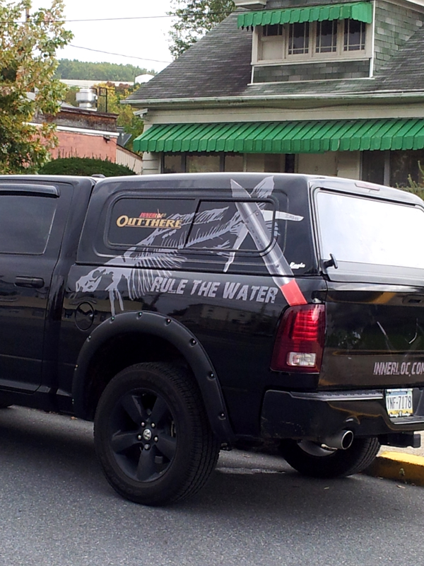

Whenever we do a project with gray in it we convert them to Grayscale before print. haven't really had an issue yet but we sure know when we forget to convert them! I attached a couple of the fleet wraps that we did using gray. We only use 3M IJ-18 CV3
