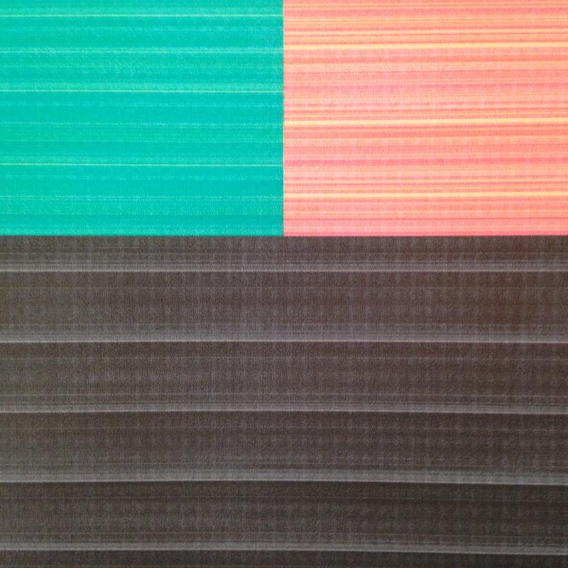

I believe we are finally ready for production print but have a few questions. We have an issue with nozzles being plugged. See the picture:
This is even with many head cleanings. With a suggestion of the seller they said to pull the ink after the pumps with syringe and we did. Next it printed nearly perfect with only 3 nozzles or so that weren't spraying. it looked great. So we ran a head cleaning and then it came back out just like before. Strange. Why would the this happen.

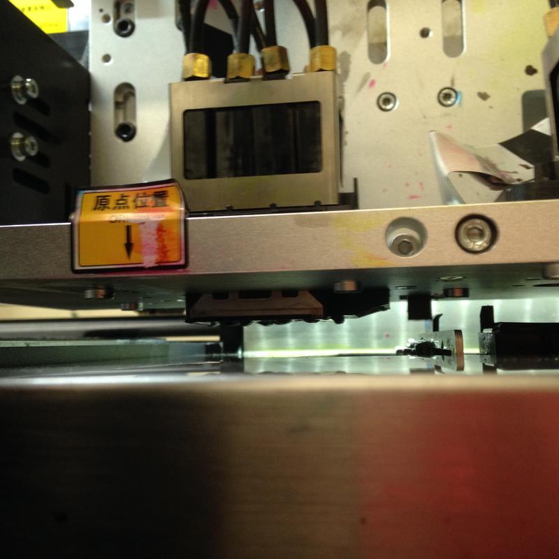

Anyway another thing is ink drips from the first head after several feet of printing. See picture:
What does that mean?

I'm beginning to think there is a vacuum leak and the ink is receding back in the line over night or at a cleaning. Then I start it up doesn't print but after a couple times it does start and gets better with each run.

Sounds like a problem with the capping station seal or a weak pump. Could also be leaking dampers, but I don't think so.

On our CET, when the ink drips during printing that means that the vacuum pressure in the heads is too low. It isn't holding the ink in the heads and it is leaking out. This also causes printing issues because there is too much ink in the nozzles, it gets in it's own way and the spray can't get past itself, so it looks like the nozzles aren't firing. Different printer, but the problems seem comparable. Check your vacuum hose lines and connections.
