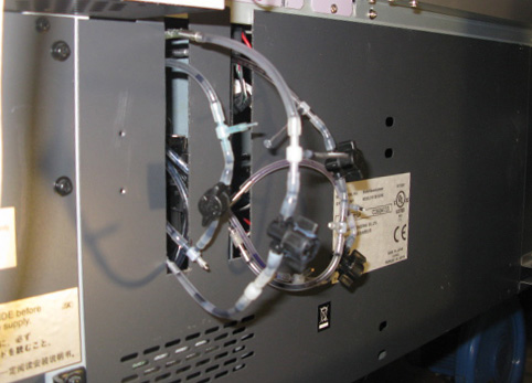

valves with t fittings above and below
this is a similar set up:
lengthened lines with valves and t's hanging permanently out of the machine. allows holding the cleaning fluid without realeasing it into the pump. also a valve with a t-fitting above and below lets you pull vacuum/ink into the head from the ink supply purging or searching for bubbles (that would diagnose bad capping seal) and also close off the pump side to see if you are getting a good vacuum in the closed position.

hi jet. i really appreciate you posting something so simple and yet so practical. i've been thinking of modifying a container just to soak the heads. but the simplicity of this just takes the cake.
you mentioned that i could attach a syringe to the drain hose for those stubborn clogs. my question is: how much force could i use to suck the ink out? i've read from other posts that too much pressure might damage the print head.
now, we don't have any way to measure pressure here, but when you pull - about how many ml/cc of do you target immediately? or do you just slowly suck ink out?
thanks!
