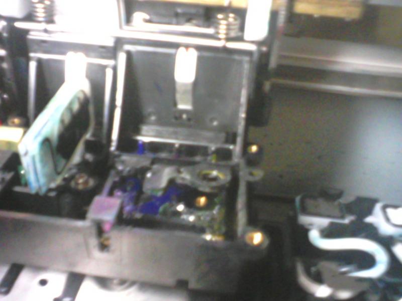

Got the new head today, cant get the old one out, I have loose but cant get it rotated out, any suggestions? here is a pic...

I have read the Maintenance Man. too, It got me this far, but guess I may have missed a step maybe...
artbot
if they are much like roland dx2, you of course have to take out the little screw. but after that the back portion rocks up and forward, if i remember correctly (as if a hing is on the front of the head). they can be very hard to get back in too. you will either get it right on the first try or bang the poor thing around forever swearing the new one doesn't fit.

this machine has put millions of new gray hairs in my head since april and im only 30!...Screws are out and it have it up, just cant get the darn thing moved out..like its not up quite far enough...
