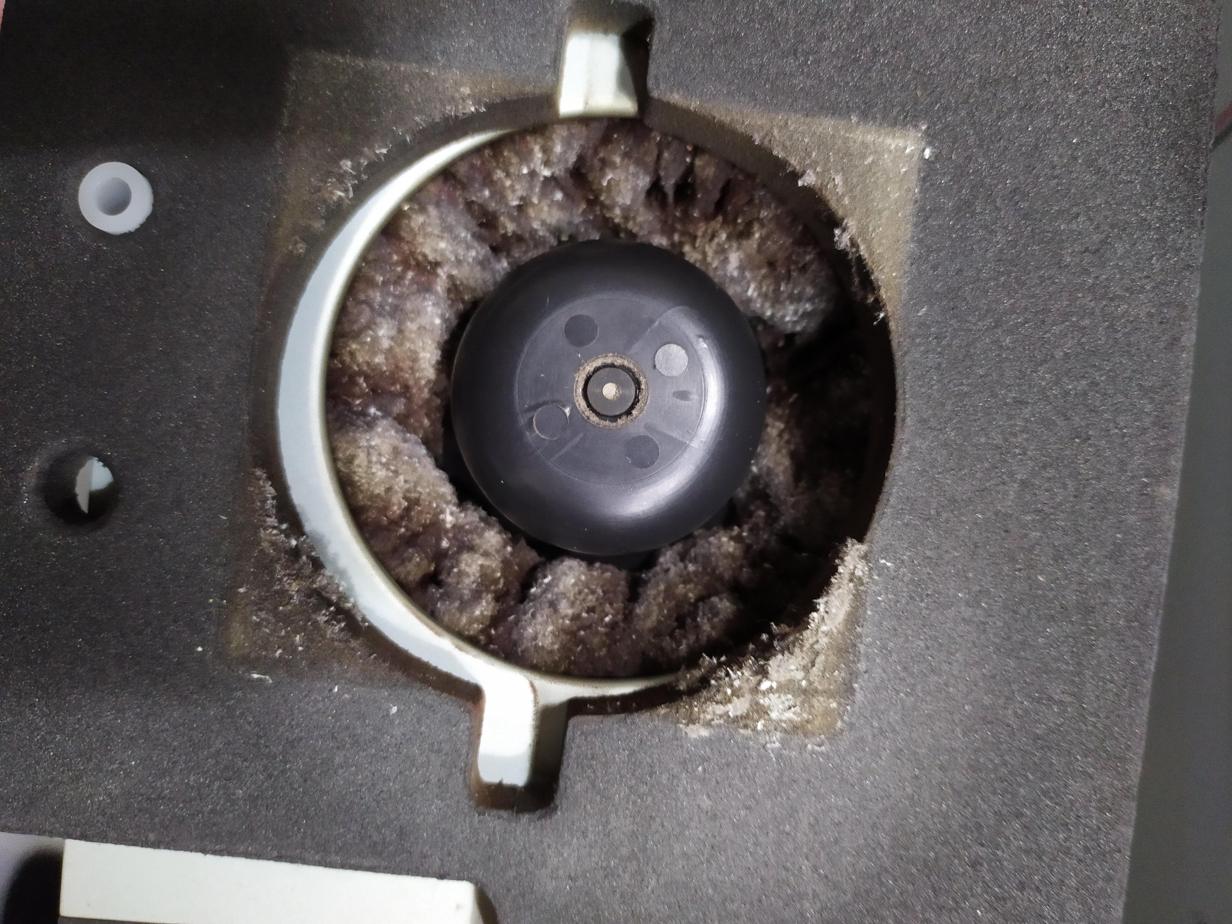

You need to clean the vacume fans. They get clogged with dust and don't work correctly.
