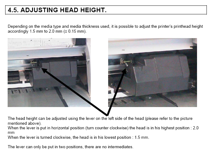

what machine do you have ? i have the 1204...and on the side of the head is a orange handle all ya have to do is move it to the top position .
Graphics2u
Here's the lever. It's only going to raise it .5 mm. Hard to tell it moved or not.

I have that machine.. Raise the lever up, lower the heat, and extend the media out more. Your prob. starting to print too close. just had to lower the heat today also..
