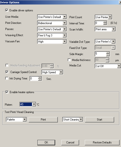

thanks for the replys..trying to figure out where to change the heat and coming up short.... I seem to only have 1 option to change in 2 places...but not sure which one is the one thats dictates what it should be... also i see people talk about pre/platen/post and i only seem to be able to adjust the platen not pre/post
any help is greatly appreciated!
maybe there is another place i'm supposed to do this in?
***EDIT*** looks like there is only 1 control for all 3 heaters...so what should i set it at do you think?
Media Drying System 3 heater zones: pre-heater, platen heater and afterheater. Single control : off, 30-45 °C
1st screen shot of Flexi 12 clicking the rip and print button > advanced > driver options screen
2nd screenshot is of the remote panel for the printer driver i think?

couldnt edit again...so its currently at 45C for the platen, I guess I should try bringing that down to 40? or should i go lower?
