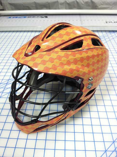

    Here's a picture of one of the proto-types. The print color & pattern was selected randomly. I believe this one was done with a 2 mil vinyl and a 2 mil laminate just for initial testing. We'll be upgrading to a thicker laminate when we actually go into production.

    No need to take the helmet apart. This was just one of a handful of templates that we created. Each brand/model of helmet requires a unique template based on the shape of the actual helmet (shell). We don't do any one-offs, just team orders.
