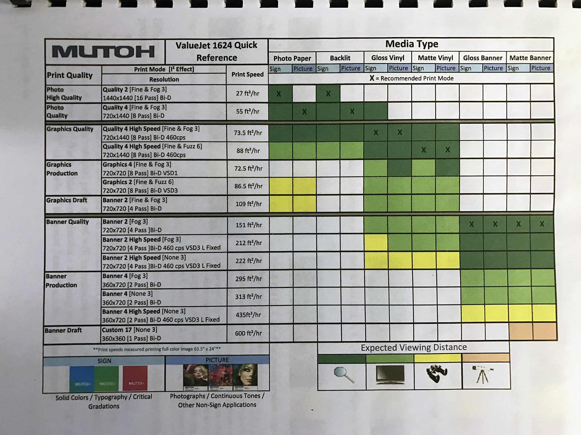

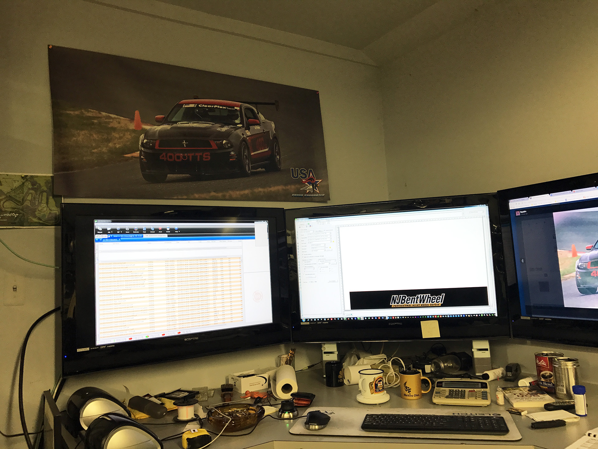

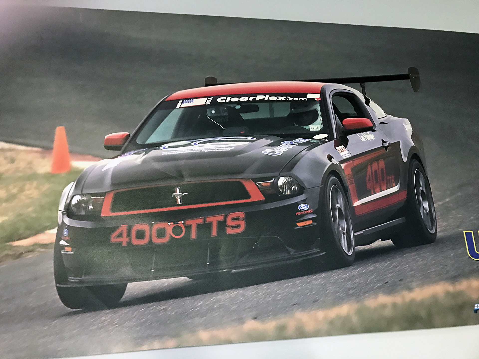

Thought about it & took a look at some print settings here.
Here is what I found:
1440 x 720 + fine & fog 3 + 300 dpi file
- no over saturation no ink flooding on vinyl media:
1440 x 1440 + fine & fog 3 + 300 dpi file
- no over saturation no ink flooding on paper media:
So, 1440x1440 or 1440x730 (media selection) seems ok on the 1624 here.
This is with VJ1624_FLX_Orajet3551G_ULTRA_720 profiles for preset output & media.
((yes, I did overdrive the print head settings)) :)
Actual print size is about 51 x 25 inch:
More settings:
