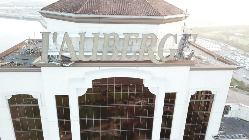

    Hey All!
    Would anyone be able to identify this font used for these large channel letters??
    Thank you in advance!

    If these letters are old enough, it is likely they were not based on any known typestyle.
    Back in the day, the first step in fabricating channel letters was to draw the letters on paper with pencil or charcoal. These paper drawings served as patterns for cutting the plastic faces with a jig saw, sabre saw, or band saw. Occasionally, we copied a printer's typestyle, usually when a logo was being duplicated or when an architect specified a typeface. But, generally, we did not try to slavishly copy printer's typefaces—that usually required using the projector and added unnecessary time to the job.
    Also, many typestyles did not fabricate well into channel letters (many romans, for example).
    Learning to draw letters, and later, to create letters by brush without actually drawing them, was a skill that took years to acquire. And, of course, some sign makers were better than others. The letters in the above picture look a little squirrely, so my guess is they were drawn by hand rather than generated from a computer. I could be wrong, of course. My knowledge of typestyles is not extensive.

    Thank you for your input Brad, very informative.
    I do believe these were hand formed and loosely based on a typestyle. There are many different curves and thickness' going on which leads to believe that. I am mostly looking for a similar typestyle that one could use as a baseline to build a more closer representation of these letters. This set was installed about 2005, being 15' high letters, very well could have been ALL done by hand.

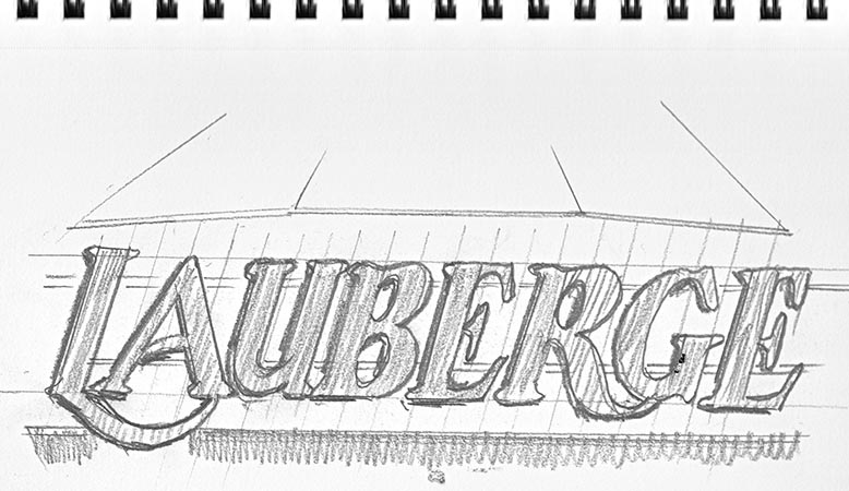

    l'auberge.jpg Would not take much to reproduce if you don't find the font.

    I like the bottom one...................................

    Nice sketch Johnny! I started to have one of my designers re-create the letters, he should have it completed today. Then the fun can begin!

    It looks to me like it was inspired or based on BT Arrus - the font!
    (I've drawn and painted it enough times to recognise those uneven top serifs...)

    In case it's helpful, in past situations like this we have auto-vectored from things like your photo, then cleaned up by hand in order to make new artwork that can be output. Time consuming but sometimes its the only way...

    In Your Font book (Adobe First) the A is the quick identifier.
    The move onto the B, but the L is a better Identifier.
    The rest of the lettering is similar to a zillion other fonts.
    But if you find a hit on the A and can not conclude, Break out
    Your Font Haus Master Volumes, Find the Adobe Font and then look at the secondary suggestions (Eyeball icon looks like).
    If this is an old font Font Haus would have it, and Old fonts are some times
    LetraSet.
    I just redraw the lettering for the sake of time in research.
