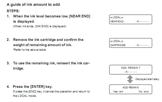

in the jv3 manual there's an explanation about how to tell your printer that you've "weighed" the cartridge and want to show 20-40 more ml's of ink or something ...??? i'd figure the jv33 would have the same.
