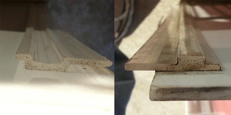

    Hey guys. We are doing a lighted sign panel replacement and we are looking for some acrylic "clips" similar to the ones shown in the photo. This is the first time we have run into a job requiring us to use these to stabilize the gap between back-lit panels. Anybody have any idea...
    A) What are these called?
    B) Where can I buy a couple sticks?
    Thanks in advance for the help.

    ZIP-CHANGE track. Midwest Sign has it and the glue or push rivets to attach it. If you use the glue make sure the door is open. woooooooooo

    Same stuff used for Marquee Letters.
    Gemini has them.
    About $1.33 per foot per track.

    AKA Gemini Pronto Track? I thought they looked familiar. We have samples of them right here in our shop and I don't know why I didn't make the connection.

    That would be it.
    How much do you need?
    I've got 1 about 8' long with holes drilled in it and them a bunch of 2' scrap pieces.
    You can have them, just pay for shipping. Havn't used them in at least a year, figure someone might as well use them.
    EDIT: They are polycarbonate.

    we just make them using 3/16 and 1/4" clear acrylic

    We always got it straight from Wagner. Keep in mind there's a top track, middle track, and bottom track.

    Yep. Wagner-Zip is who I use.
