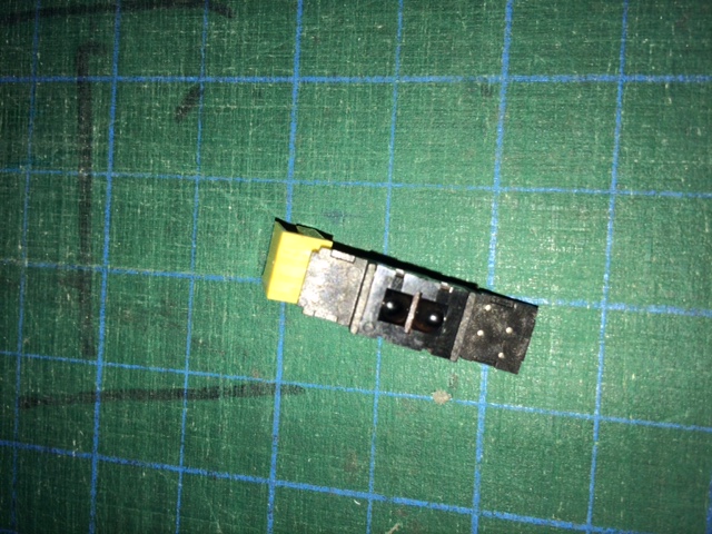

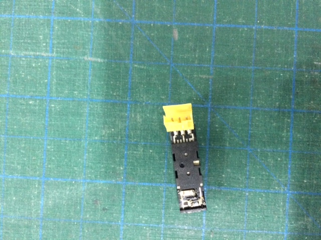

Friends need urgent help i think this is sensor. it was removed by self when head struck on vinyl due Loose of clamp.
Tell me how to install it again

Anas
you should be able to plug it back in if the socket is still there.
I dont know where i can plug it back. but i have a socket with me as you seen in attached. machine stopped now by the error called ( PINCHROLL ERROR INVALID POSTION )

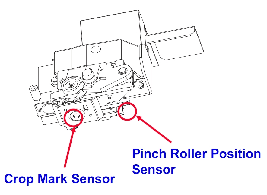

Terry01
Is possibly the one from under the cutter head or printhead. It will be the one that detects material width.
Which model 640 is it??

yes Versacamm 640. thank you for your support. by the help of attached photo i just plug the Pinch roller sensor. its under the cutter head on its back. now the machine is running..
but again the left clamp struck on cutter head

Terry01
Also make sure the correct screws are in the plate above the dampers as if wrong ones fitted, it pushes the carriage out of alignment
