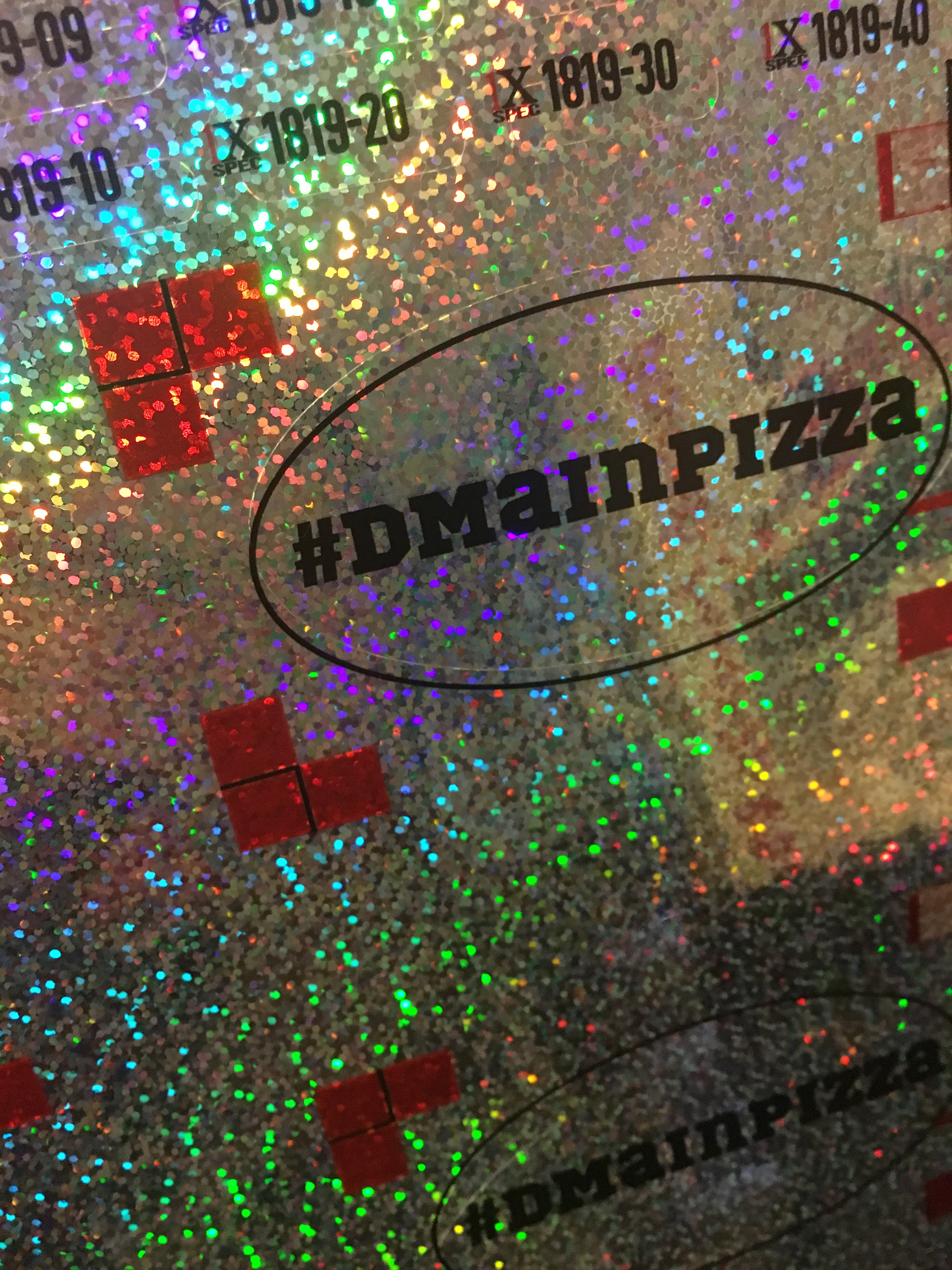

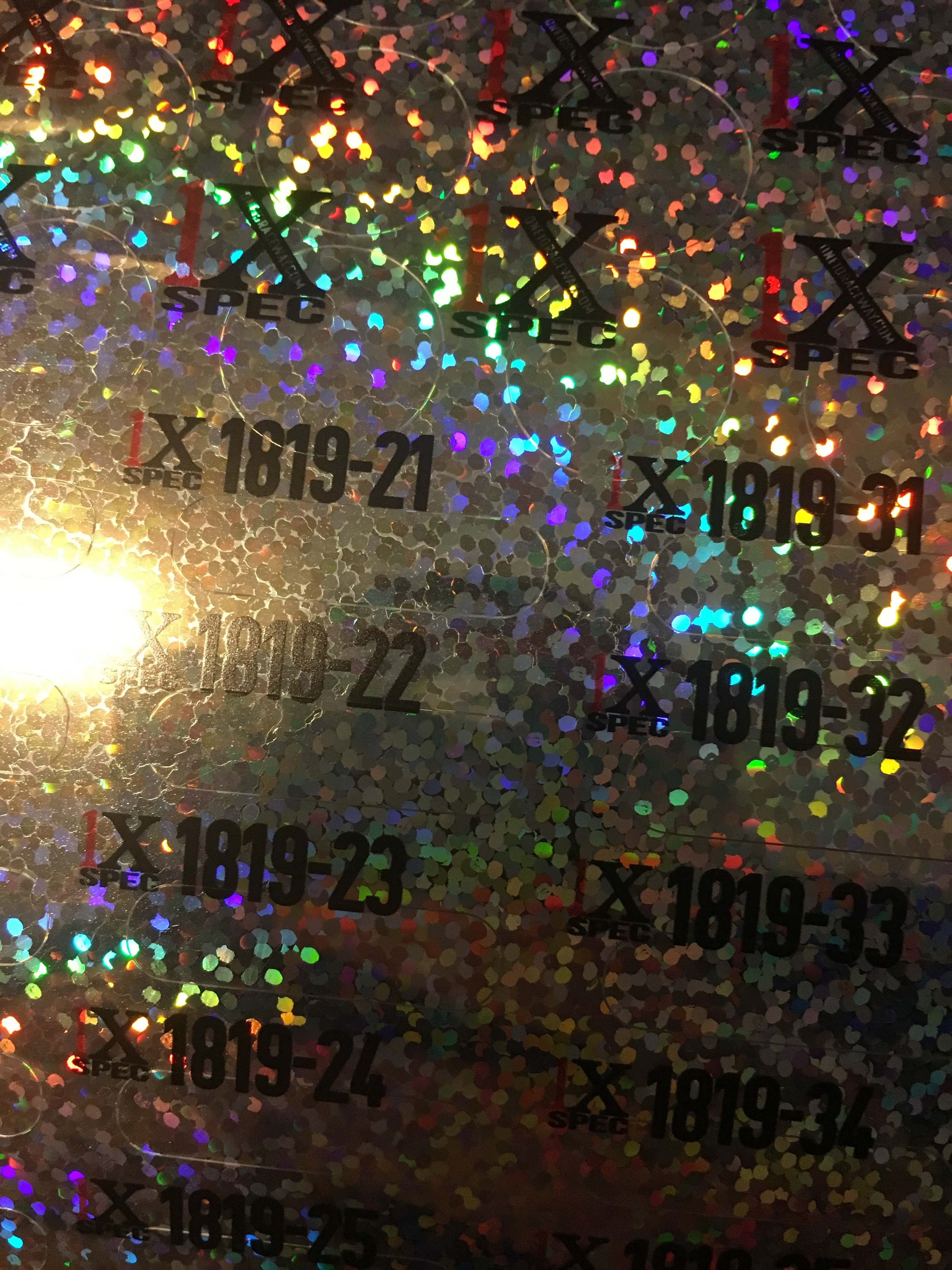

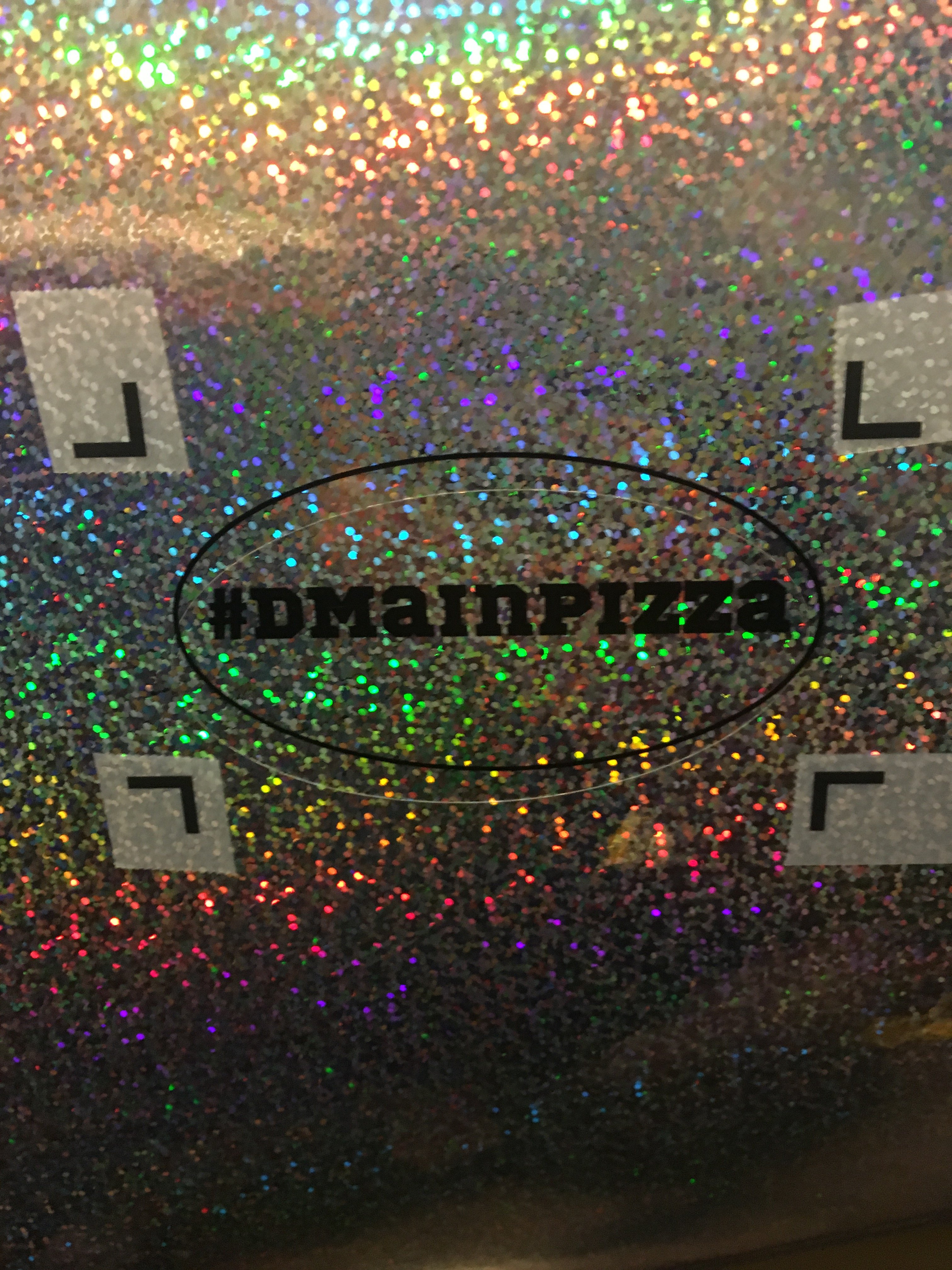

    Hi everyone, I hope someone can point me in the right direction.
    I have never been able to get my mimaki to cut accurately. its always off and never in the same spot twice when just repeating the job using the same registration marks.
    The media doesn't matter, calibrations don't work consistently. I managed to get it to cut once and a while but then the next job will be out to lunch. This has been going on since new (3 years) I've spent a couple thousand in service calls with the mimaki technician and it still will not work properly.
    Right now im trying to cut RTape reflective media and its the same crap im going through with white media. Ive been at this about 10 hours today and seem to be going nowhere. Ive attached some images from today, hopefully someone can make sense of this all. so far I've tried calibrations, PR pressure, cut pressure changes, resetting the media all with no success.
    Please help :(
    Joe

    WOW. that is miles off! I was never satisfied with my cjv30 cutting accuracy but it was way better than that!
    If a tech came out and couldn't fix that accuracy I wouldn't pay them a damn cent...…….

    You probably won't get a perfect consistent cut on that shiny mosaic vinyl. The sensor that reads the crop marks is an optical sensor so any abnormality in the light bouncing back will throw it off. If the problem still happens on white vinyl, then there is probably an issue. Have you tried just printing and cutting without crop marks?

    Thanks guys. I figured a work around for the mosaic vinyl, its very tedious but seemed to work. I printed the job twice, one on white first then the mosaic. I added registration "Boxes" to the print that I just out of the white as a template and cut the graphic area out of the white. I placed the white over top of the mosaic for the mark to read properly. seemed to work.
