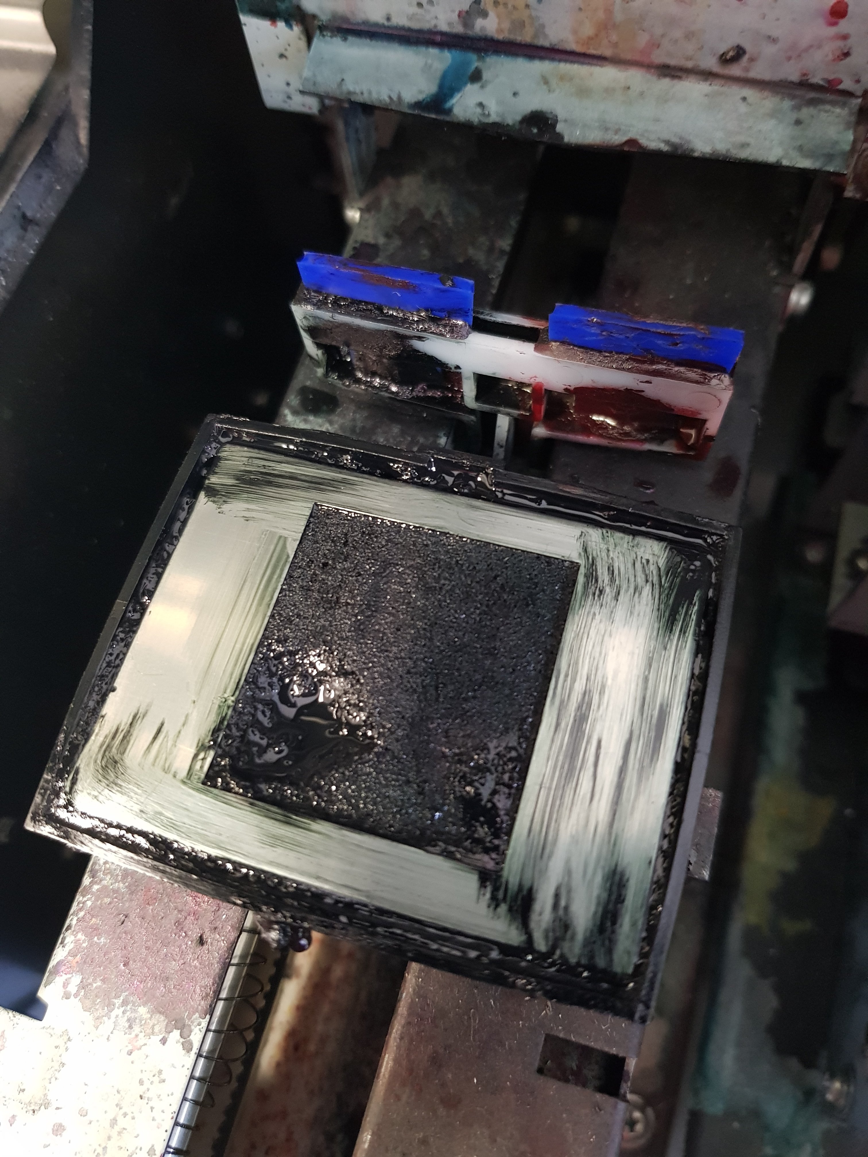

    Also, please see attached pic of my sponge, I'm assuming this needs replaced? What is this part called? I only just seen this when cleaning. Why would this have a hole like this? Many thanks!
