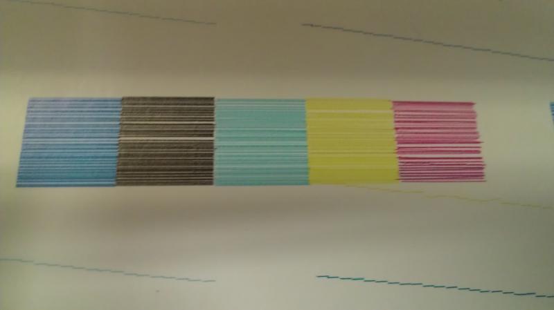

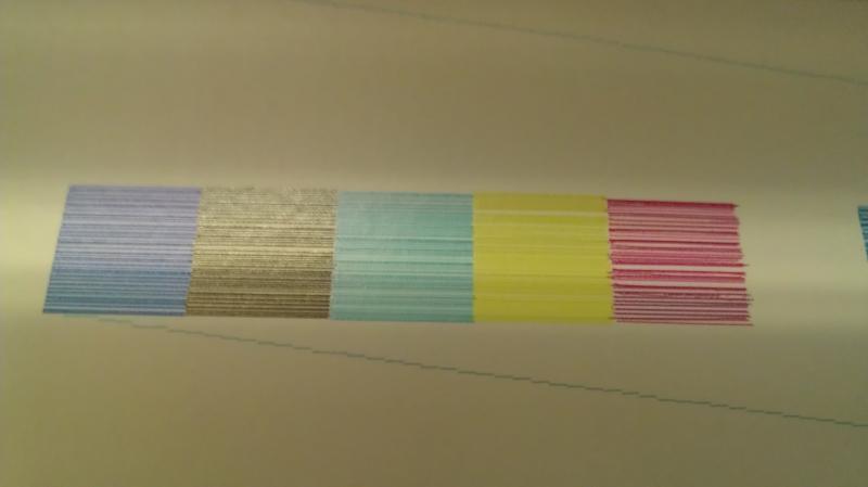

I just purchased new print heads, capping station, dampers, and print head cables for my Falcon outdoor 62" replaced everything except the cables. Did power clean as soon as i replaced it all. Attached are photos of what the nozzle check looks like. PLEASE HELP

randya
I would try a few small cleans, then start head soak.
A lot of deflected nozzles, hopefully you didnt damage the head during install.
Ghost Prophet
That looks pretty good for a FO 62, but you are missing a nozzle. Try head soaks and pulling the ink through the capping station via the waste ink lines.
