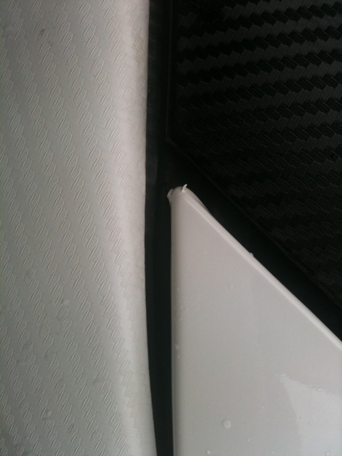

Hi all, this question doesnt just refer to the edge of the wing but to the edge of many parts on a vehicle.
The question is how would you wrap the part of the wing of a vehicle.
I know other parts like the lower edge of the door you can just cut right up against the door eliminating this problem.
Although the problem with doing that with this part is you will see the origional colour of the vehicle.
So how would you deal with this without getting the 'fingers'
Thanks,

The only other thing I can think of is apply the graphics over the edge and then push the vinyl down and around the edge (as pictured) with a squeegee and then to cut.
Sorry if that doesn't make sense.
thanks,
put a few relief cuts just to the outside of the edge so the vinyl can overlap itself slightly on the other side of the area you are wrapping. this alleviates those folds and you can't see the cuts on the backside.
4R Graphics
As visual concepts said you make a couple of relief cuts then tuck and fold when the wing is installed you will never see it and the edge will be clean since you tucked under and relief cut it to get rid of the bunching.
MikePro
two relief-cuts, like a "V" on the two sides of the point where the straight line hits the radius.
-pull the middle "tab" of vinyl over the top of the point and wrap on the backside
-then wrap the two sides around so the 3 parts overlap eachother on the backside to keep each other secure.

forgot to mention, that, when I do the cuts... i double those cuts to "notch-out" some of the excess vinyl that won't be tucked away. little heat, and a slight stretch before tucking to the backside helps hide any remaining excess from the "fold".
simpson246
Thanks, so I guess after completing the little relief cuts, stretch the vinyl over the edge of the corner with heat and then pressure against the underside of the part.
I guess this should result in a clean finish with no 'fingers' as pictured.
