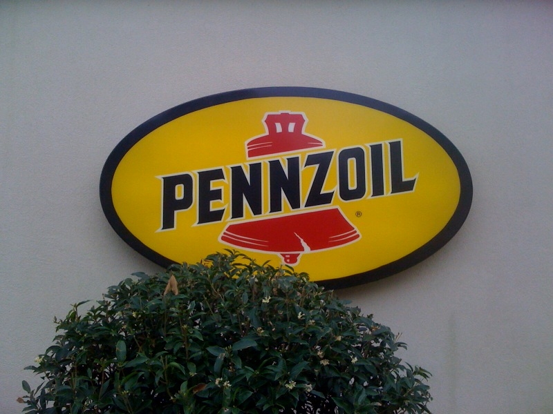

I am unsure how to go about this. I have a client that no longer uses Penziol, went to mobile one. The attached picture is a molded, reverse painted acrylic pan - the edges of the face go around the sides, if you will. What type of remover/stripper could I reasonably use to get the paint off the acrylic without damage?

I've found "Brake Fluid" works great,,,
put it in a spray btl,, wet it down,,
soak for a bit,, scrub brush to loosen,,
rinse with water,, reapply where needed,,
wipe the finished face with alcohol,,,
good to go,, well,, it works here anyway,,,
Good Luck on it !!!

If it were me, I would get a rubbing, send it to Faces and just have a new face made.
sar bossier
What im wanting to do is remove the paint,clean and print new Mobile 1 logo. Is this the proper way to go about this or should i just order a new face and start over?
