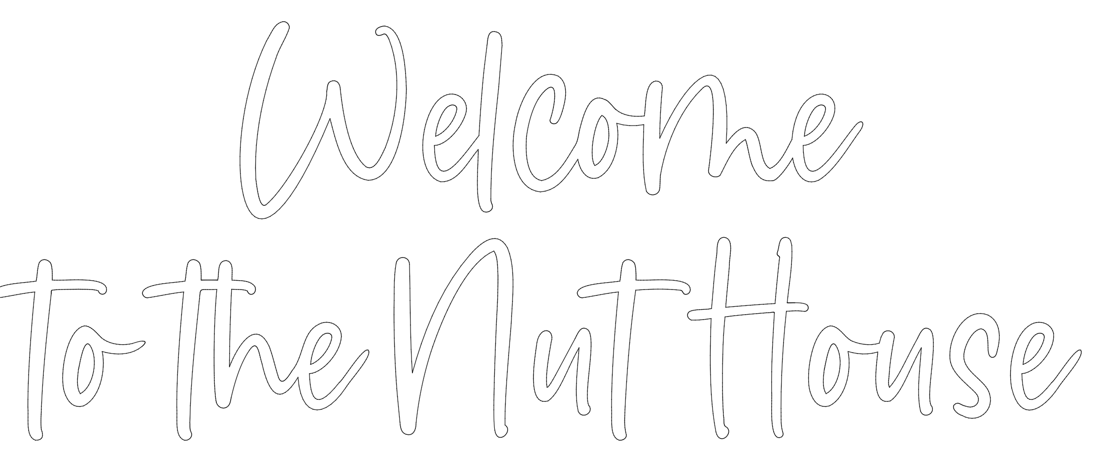

Im drawing up some files in illustrator, but I need to make the thickness of the text 6mm all round. See photo attached is this do-able at all. Advice on how to would be greatly appreciated. Thanks in advance. Maxie

Are you wanting them to be a consistent 6mm everywhere? Since none of the letters are the same width you really need to redraw them from scratch. I would do this by drawing every stroke as 6mm using the stroke tool and once you are happy with the results you can then convert to a shape

Hi yes I require it to be a 6mm consistent everywhere as to act like a chanel. Could you point me to any guides or videos for your method please.

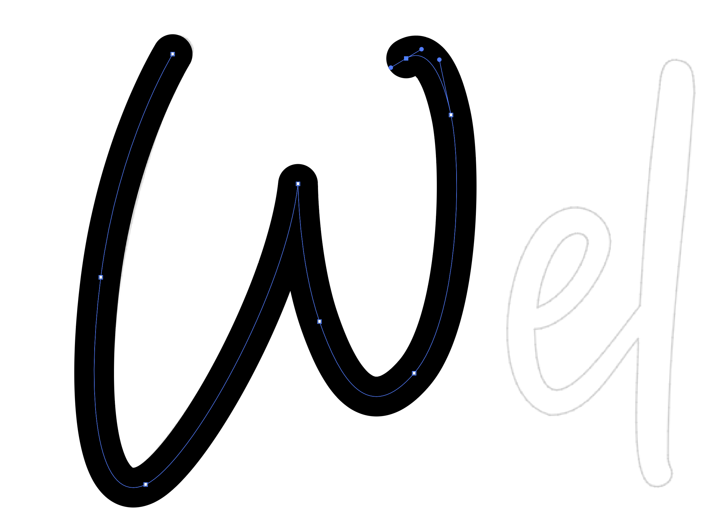

redraw the letters using a 6mm stroke. Use your original as a watermarked template in the background. That is all i did. Once you are done convert the stroke line into a shape. Not sure of the function name in corel
Object>path>outline stroke is the function in Illustrator

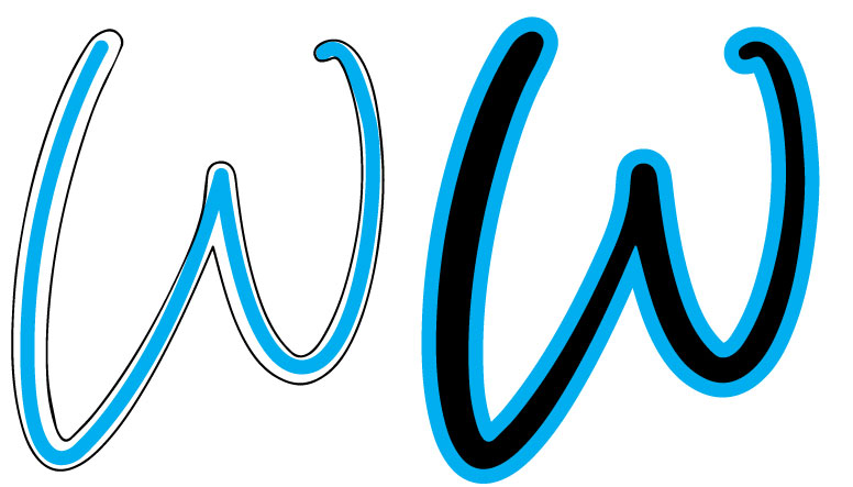

I'm on the confused team with vector doctor. The way the op was worded, it sounded like you needed the body of the letters to be a uniform 6mm, i.e. no portion of the letter being wider or narrower than 6mm. Like the W in ops post, the "wing tip" on the left of the is wider than the "wing tip" on the right. In the Vector Dr.'s sample below that the "wing tips" are a uniform width. After a few posts it seems OP might want to simply add a uniform 6mm around the existing lettering as it is.
In either case, the good Doctor is 100% correct in how to proceed.
If his first interpretation is correct, you would want to redraw each letter with a single stroke in the middle at 6mm and round the caps. This will give you the uniform width letter body like my sample on the left
If it was the latter, then his instructions to offset the path would give you results like my example on the right.
