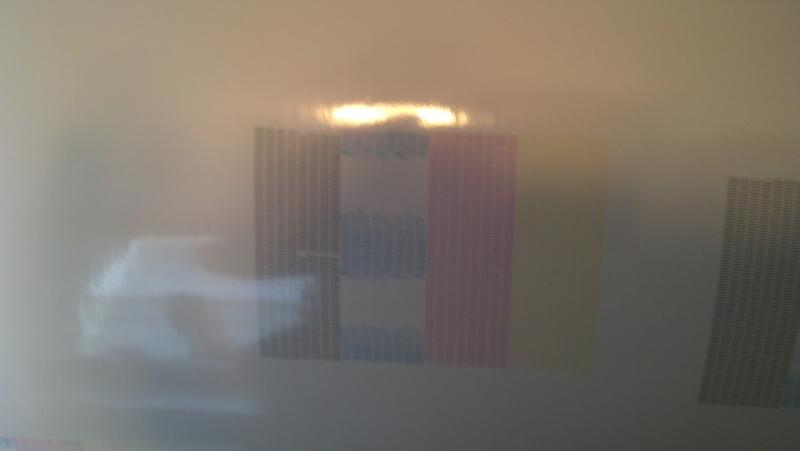

    Did a manual cleaning yesterday and I was super careful at least I thought so but I go to do an after test print and this is what it looks like. Please anyone know why its doing this? Did i screw my head up badly?

    Hi there. Do a medium clean and try again.

    Make sure the captop is clean and in place correctly, not pushed to one side or twisted
