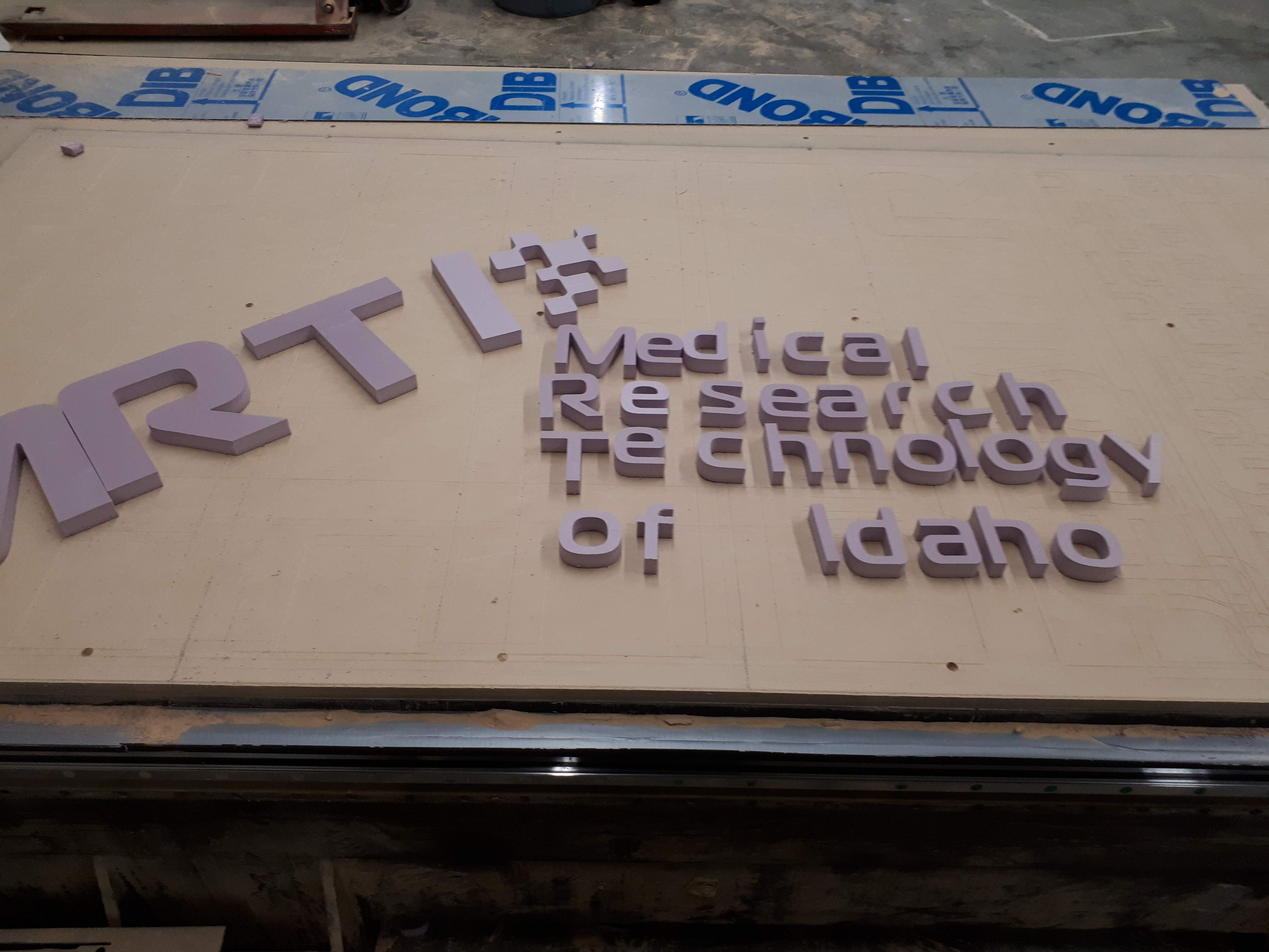

Currently work in a shop running 3 candy rock mountain Chinese routers. You can get away with a cheapo E-bay router and cut your acrylic/polycarb faces and sintra or composite backs all day long without any issues with uplift . So long you get a good vacuum pump which is about $10,000 new. Auto tool changer and auto tool height sensor will save you a lot of time. Minimum 8 tools and I don't recommend the linear tool changer. The dust from everywhere will end up gathering on the toolholders and over time cake up the inside of your spindle with tool changes. Axyz offers a carousel style tool changer that keeps tool holders away from all the dust and crud. Also has a built in tool height sensor the loves getting freaked out if you leave a 10+ hour job running and metal chips pile up on it.
Cut 1/32" or 1mm PETG today with the smallest part being about 2" by 2" and it stayed down just fine. Mind you I got a Becker pump for a 5x10 so the 4x8 variety might be a bit cheaper.

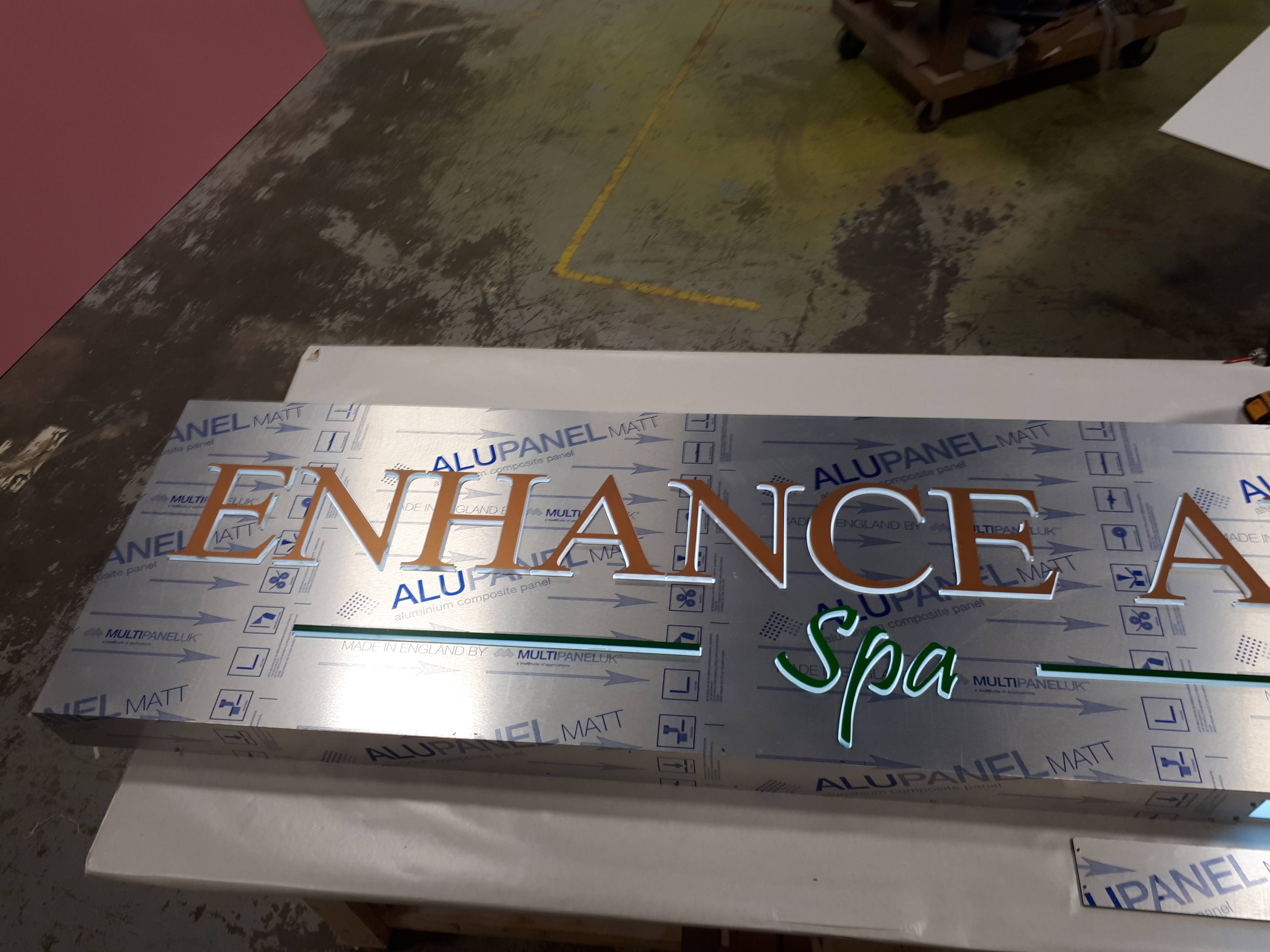

Included in the picture is a 1/2" acrylic letter and some acm numbers. The tape roll is to scale. No tabs or skin holding parts down. All cut on the same 5' x 10' table. No work done to them besides a quick hosedown with the air. Cutting polycarb is quite easy especially if you're doing bigger letters.

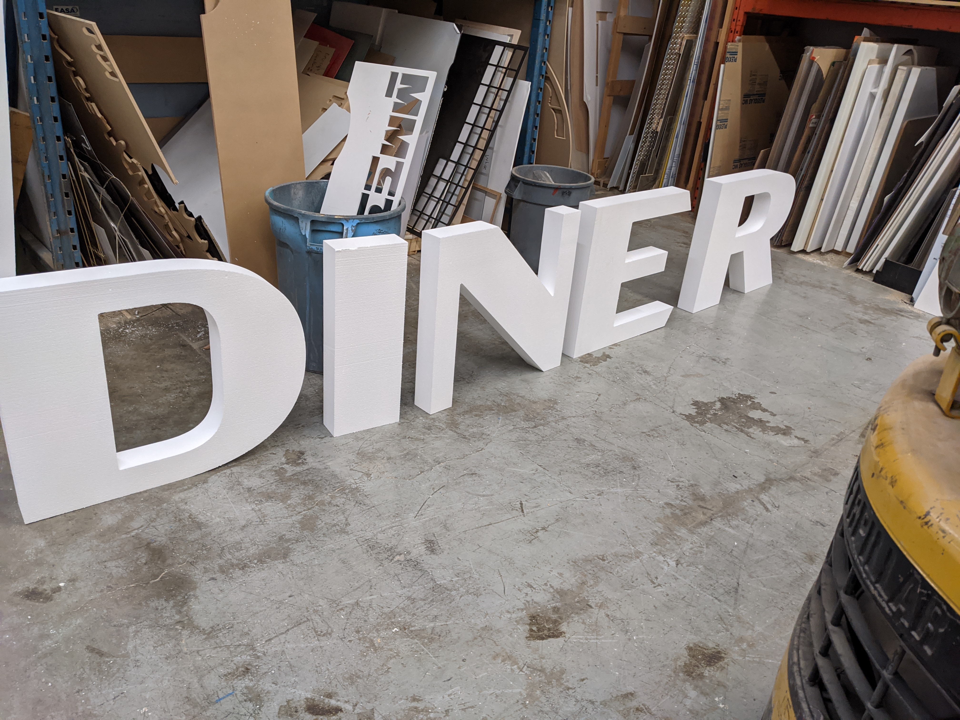

Another thing a lot of sign shops here do is cut the xps foam insulation into letters for cost-effective cheap building lettering. Again, you can go pretty small with the letters but they tend to be on the larger size, like 18"+. The pink foam is the most common variety in the Homeless depot nearby. 1" thick but you can cut 2" easy as well. Added a photo of cut 4" styrofoam letters, it's some next level dusty cancer causing stuff for sure so wear your respirators on your respirators. Cuts all that with a single pass at about 150 ipm. I cut all my foam at the same speed because it just works every time.
There's also a photo of a push through folded acm lightbox. Cheap, fast and somewhat good looking solution for a lot of customers nowadays.
