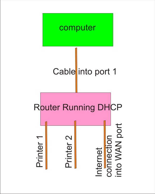

Bob, can you just do a couple of checks for me and post them here.
1st, go to your start button, then run, then type "cmd" then open. Once you've done that, type "ipconfig /all" in the blackbox that comes up and then press enter, post what it lists for IP's including subnet masks.
2nd, please post the IP address of the Print Server, including subnet mask.
3rd, Do you have windows xp service pack 2 installed?
4th, Why the print server? do you have other printers hooked up on your network? If not, you can just plug the printer straight into the network card and give it a static IP address.
Working with 2 nics in one machine can be a headache sometimes, thats why most people just run a regular router externally and have 1 nic with all the printers coming off of the one router.
Just on a quick side note. If the ethernet card has always been DHCP, is your print server a router as well to be able to assign DHCP?????
Whats the make and model number of your print server, we'll get to the bottom of this so you don't have to take the long walk with the rope.
See attached config on most networks, rough drawing and layout.
