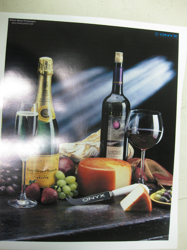

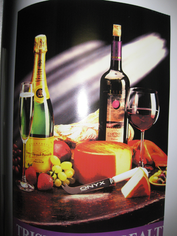

    It kind ok looks like it is printing too layers but its not. The software is not set to do so and watching the machine print it is only making one pass. The prints are noticably darker to the point the colors are off, not just a little darker than the monitor.
    I've attached some pictures below. One is a sample file that came with Postershop. You'll see a picture of my printout and how the colors are off.
    EDITLooking at these thumbnails here it really looks like it is printing too much blue/cyan. That would coincide with the others files I've tried printing. I have a file that should be light purple and its coming out dark blue. Another file is light blue and its printing navy. I dont know if I need to change the cyan ink restriction?

    Either that profile is corrupt or you don't seem to be getting any color management being applied to the image.
    That's waaaay off.

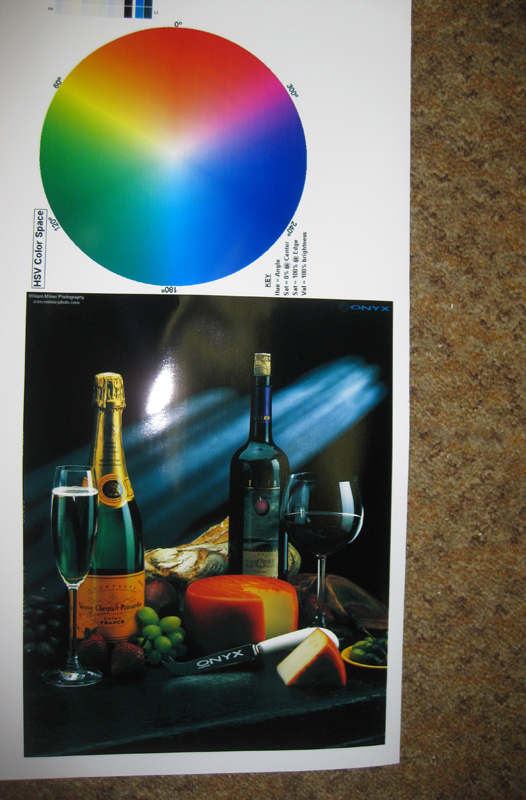

    Can someone explain to me what I should be running under Media Configuration Name? The options I have be fault are Hi-Pass CMYKcm, Mid-Pass 1x4, Mid-Pass 1x4 MD, Mid-Pass CMYKcm, Mid-Pass CMYKcm, MD. I dont really understand what they are and which I should be using. I also have a disc here that came from Advantage Sign Supply and that allows me to have a Media Name of ASSI SS2X4. That is what I always used in the past.
    I decided to reload Postershop and have a fresh start. I ran that wine bottle print under the default, Hi-Pass CMYKcm with a Avery MPI 2010 selected for the media. The only change I made was the resolution. As you will see in a picture I'll attach very shortly the color seems much closer. Maybe I'm on the right track?

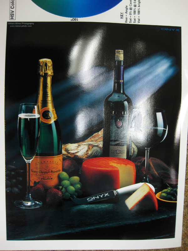

    Here's the latest. Printing Mid-Pass 1x4 netted me the best result I've gotten so far(see below). The media selected was Controltac210 at 720dpi. It was printed on Oracal 3651 gloss white.
    I tried loading the SS2 3651 profile from Oracal again and again I got a deep blue shift. I tried loading the ASSI SS2 Profiles I have always used and they too have the blue shift. I just dont understand what the problem.
    So I'm getting decent color from the wine bottle sample using the first setup described. I'm not having very good luck printing some other artwork. I have a background with some solid purple and the color seems way off.
