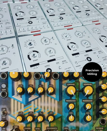

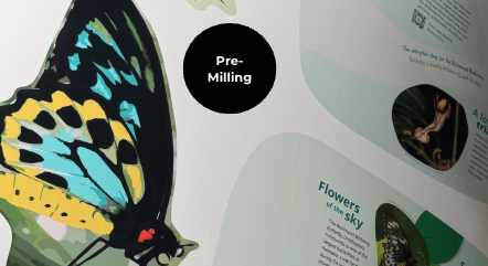

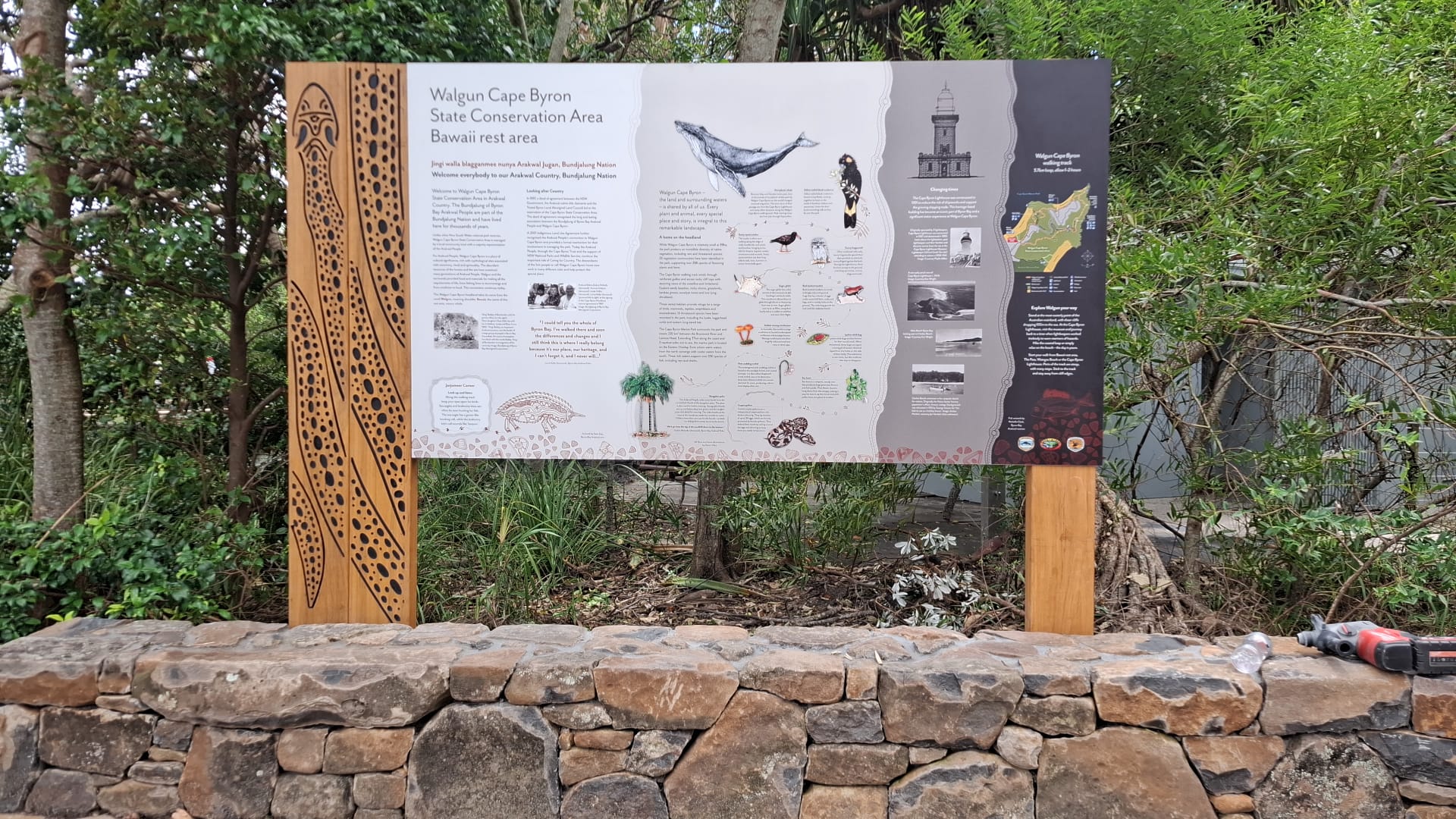

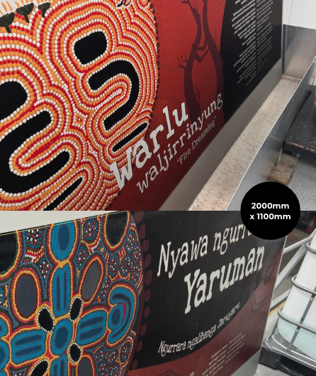

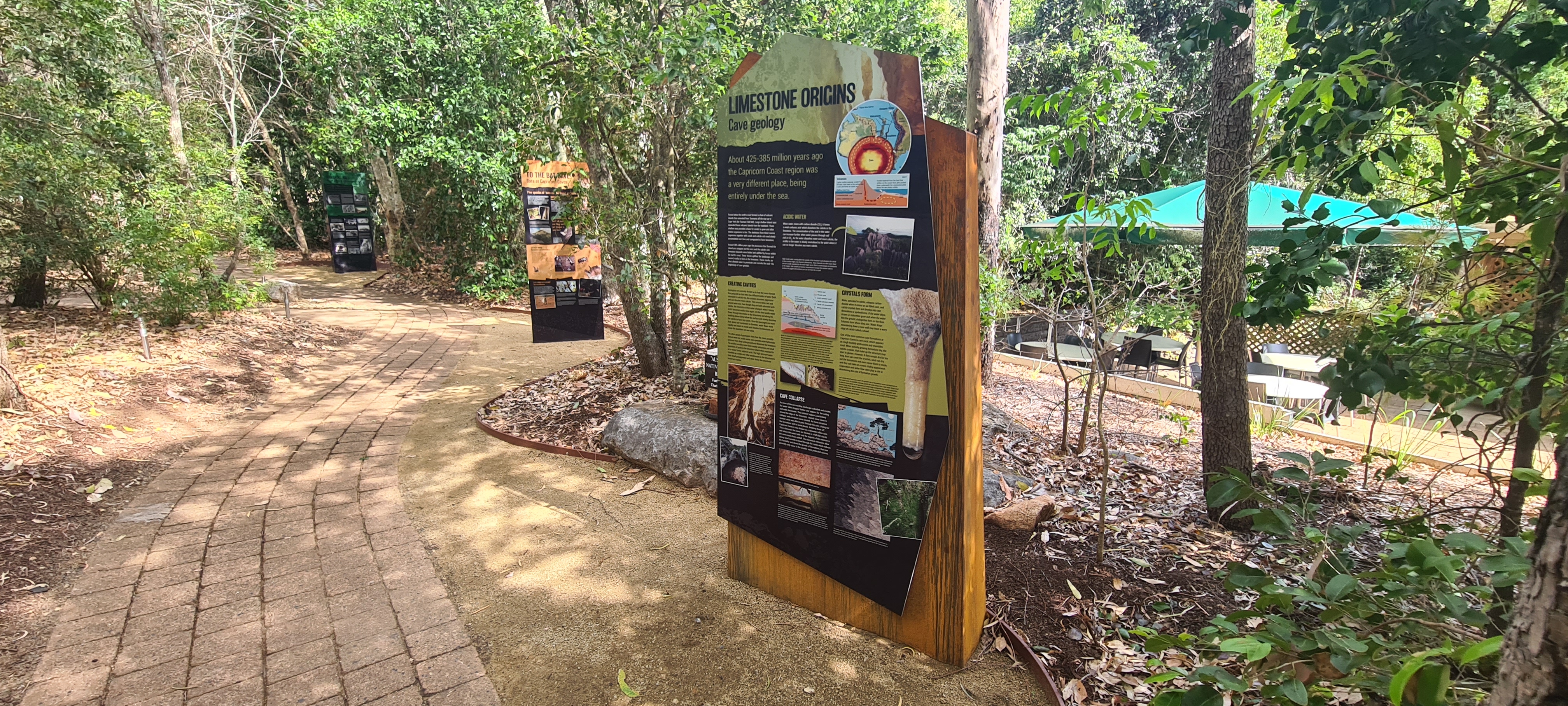

Hi all. We direct print into the open pores of anodized aluminum. ALMG1/5005. Then seal it naturally. It’s ultra high resolution and has very high resistance to all the things that cause trouble. Graffiti, solvents, up, salt heat fire people snow ice etc
It’s an engineered process and is NOT screen printed or dye sublimated. Outlasts other equivalent types and looks incredible. Smooth lustre and rich colours indoor or outdoor.
Thought you’d be interested. From micro (say 20mm x 10mm milled) up to large format. Say 2150mm x 1140mm. Perfect for signage.
Anyways. I’ll leave this here. Happy to answer questions of cop some heat from you legends.
