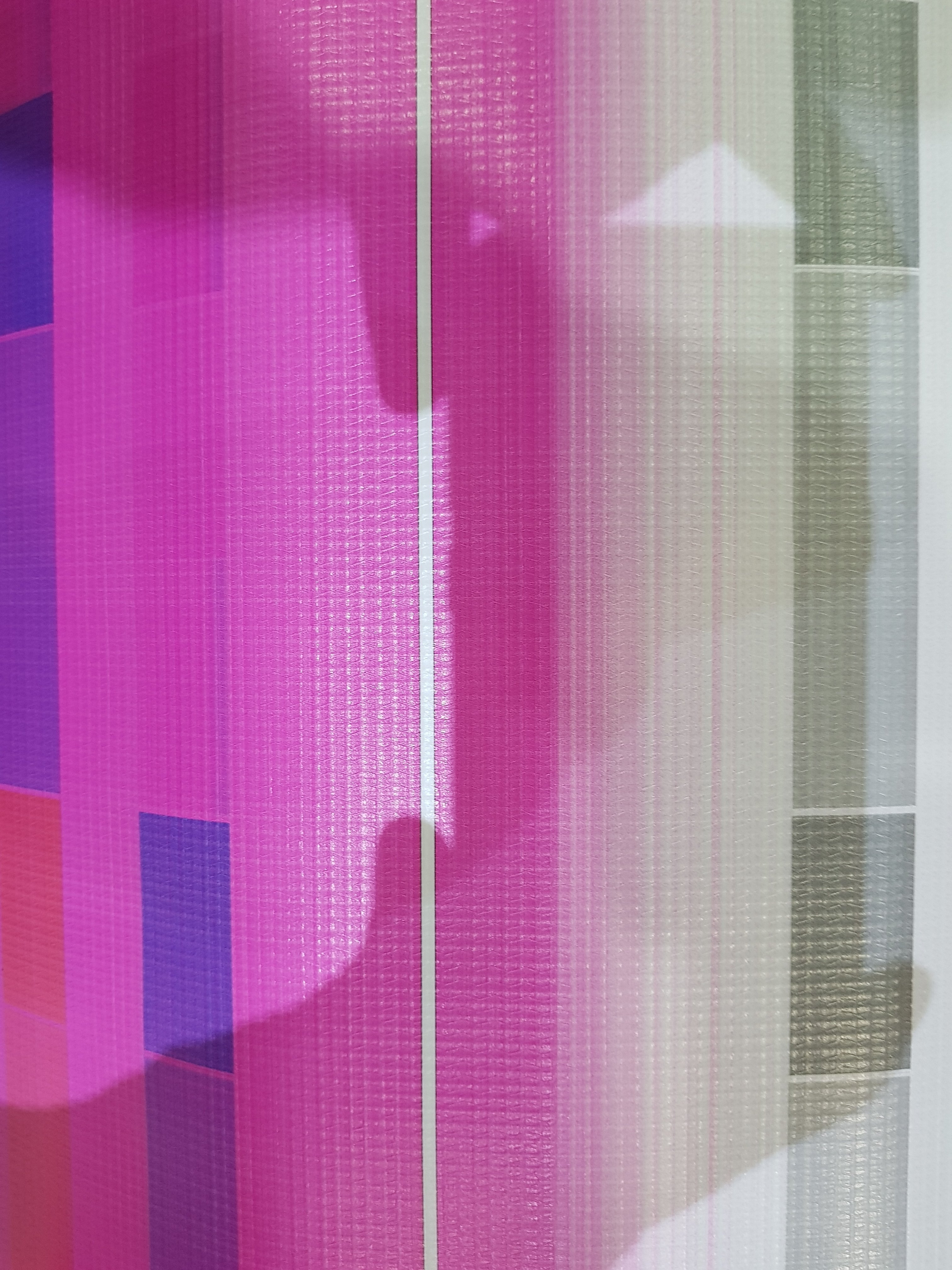

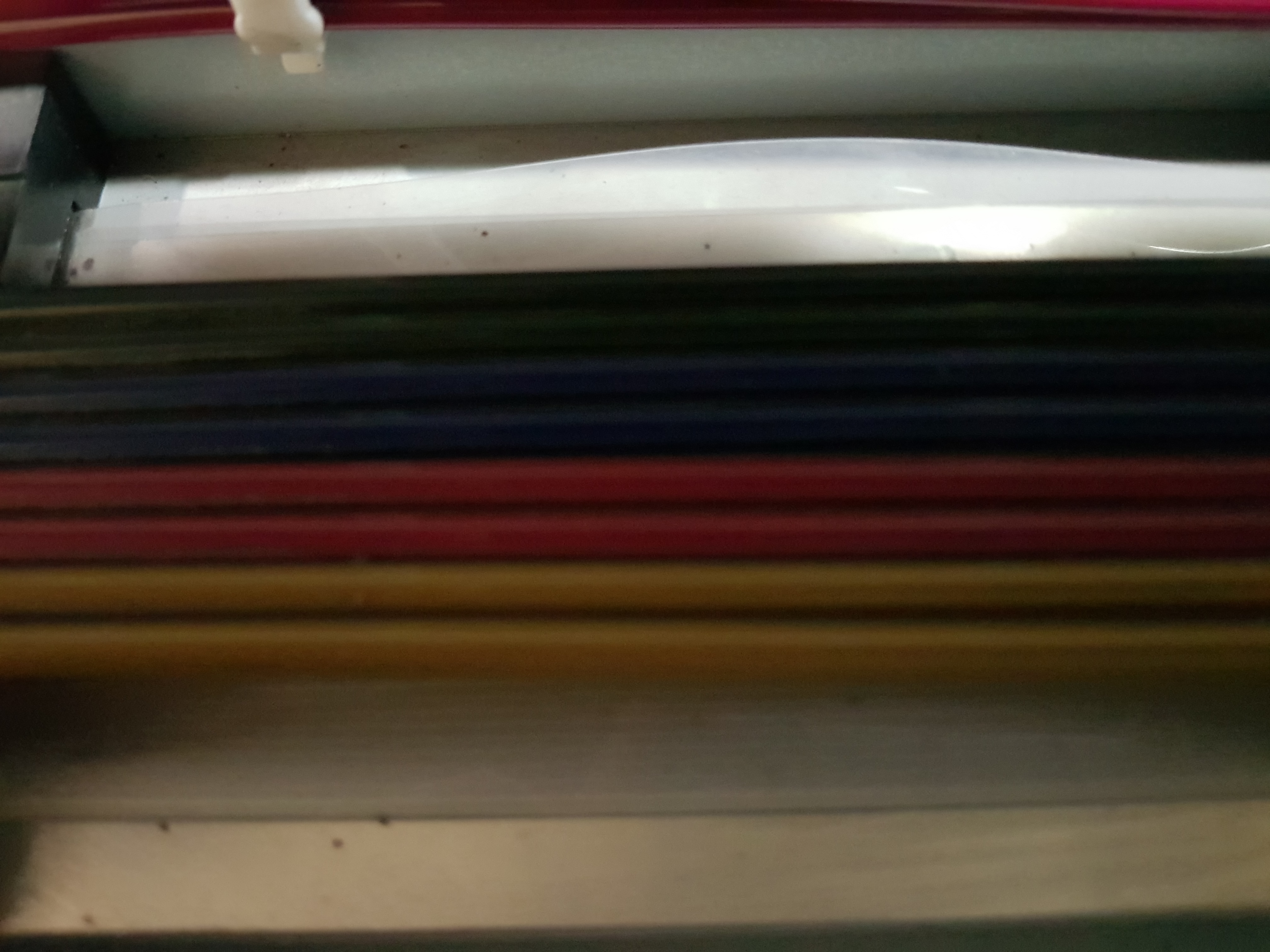

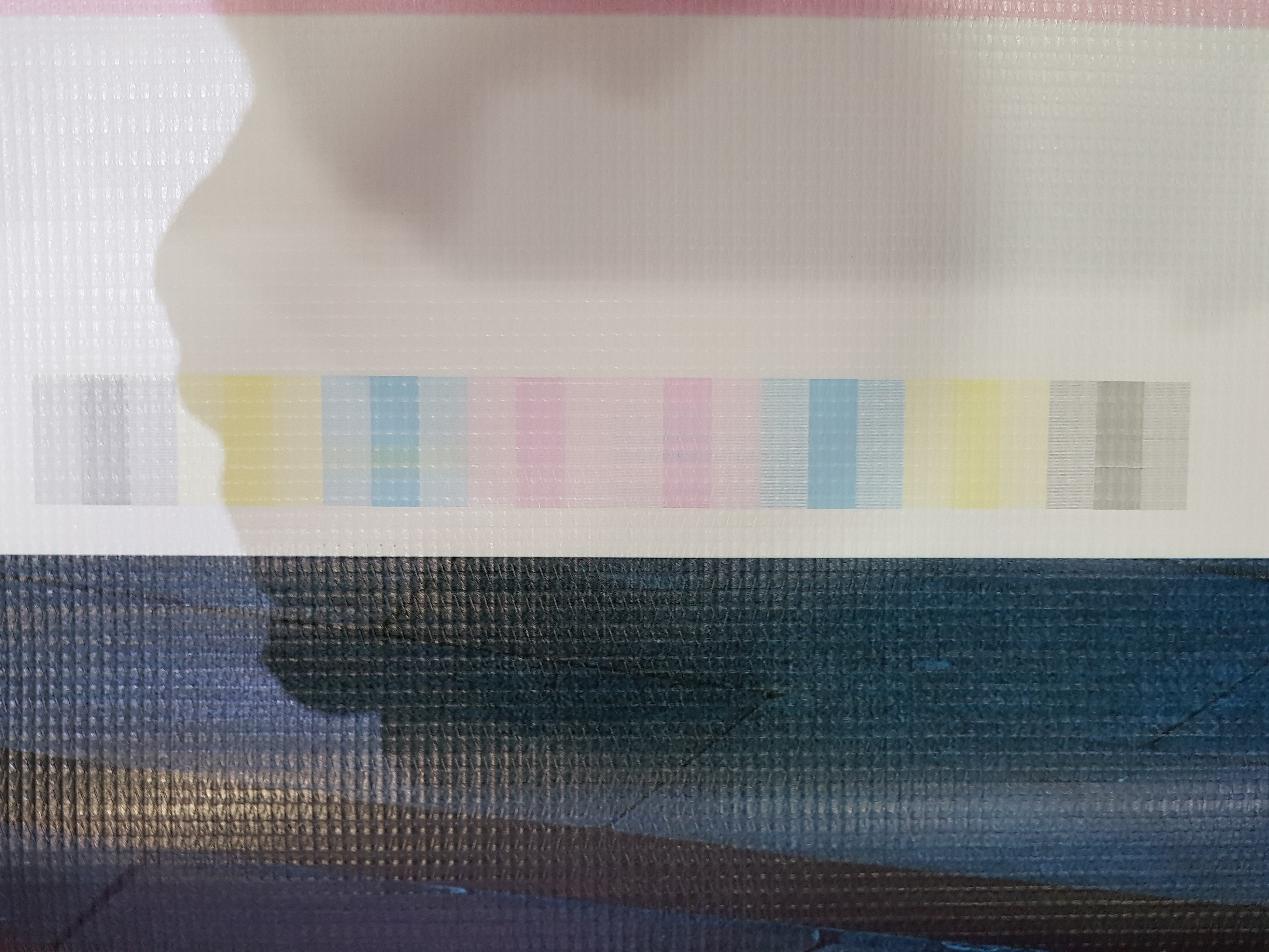

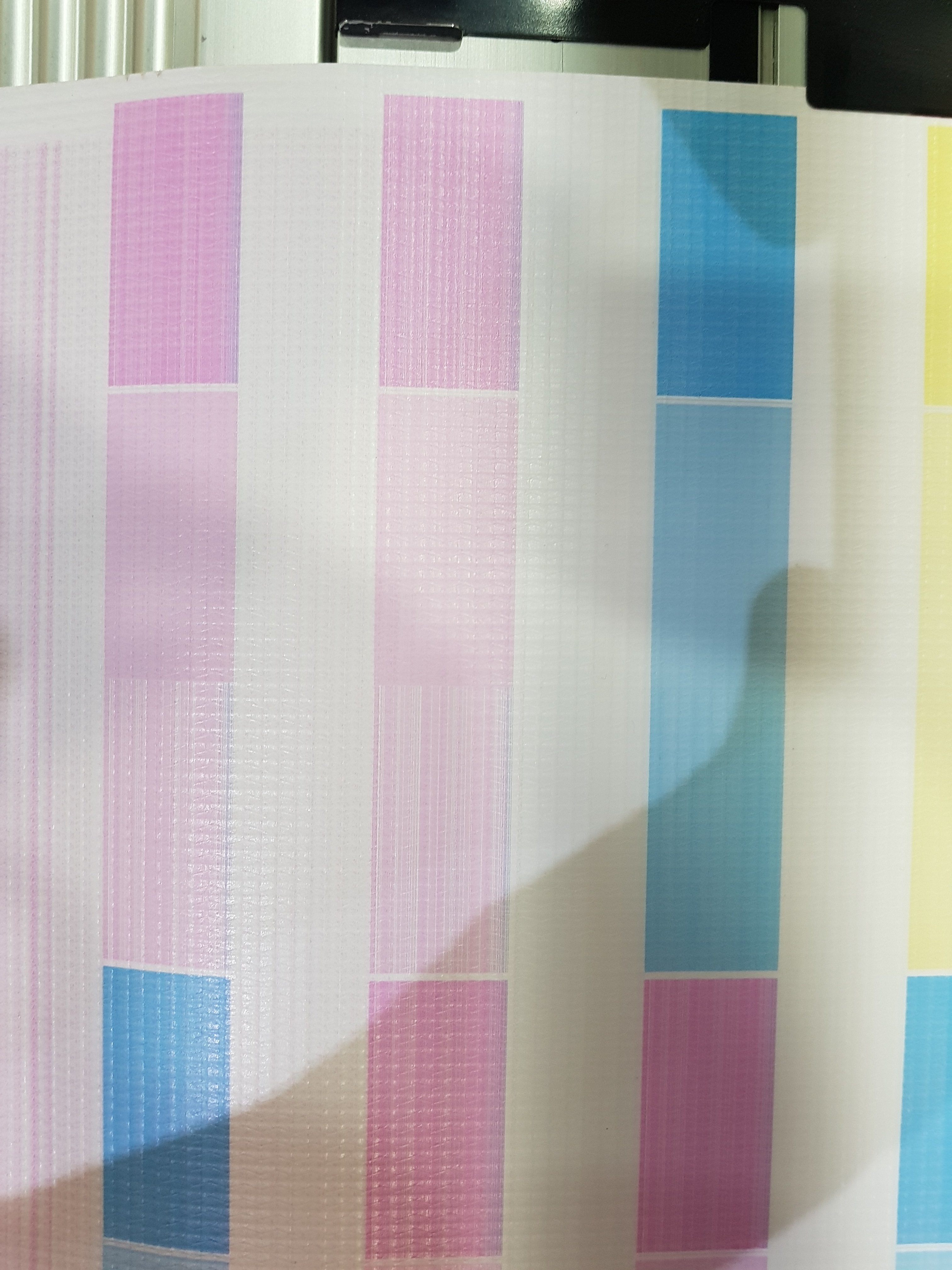

I have 3 months with the problem of loss of magenta, when doing a litle charge the nozzle check is great, but when printing something magenta begins to lose the tonality. I make the nozzle check and I see that up to 90% of magenta ink was lost. I changed the head to the other 1638 valuejet machine and it worked perfect.

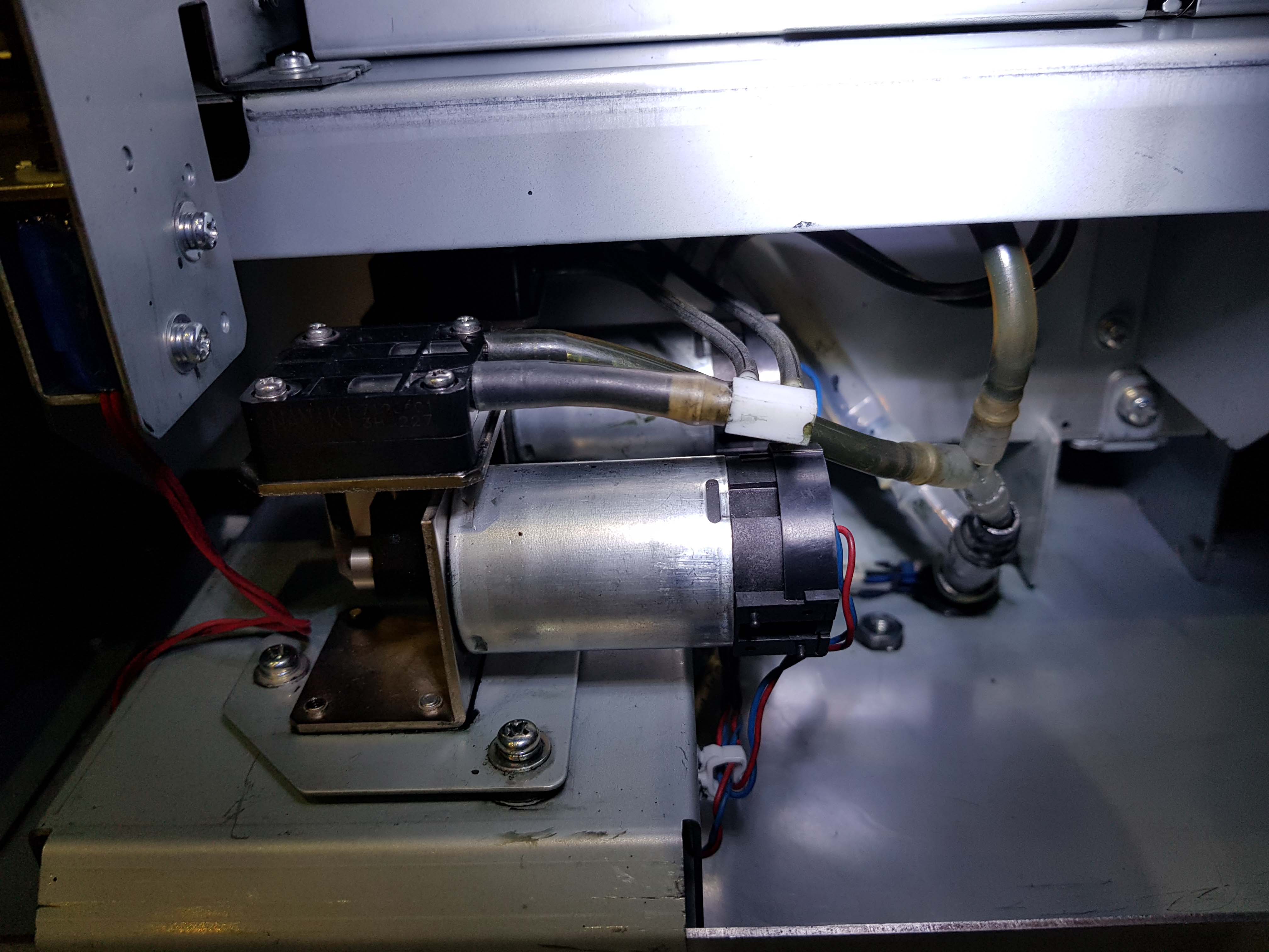

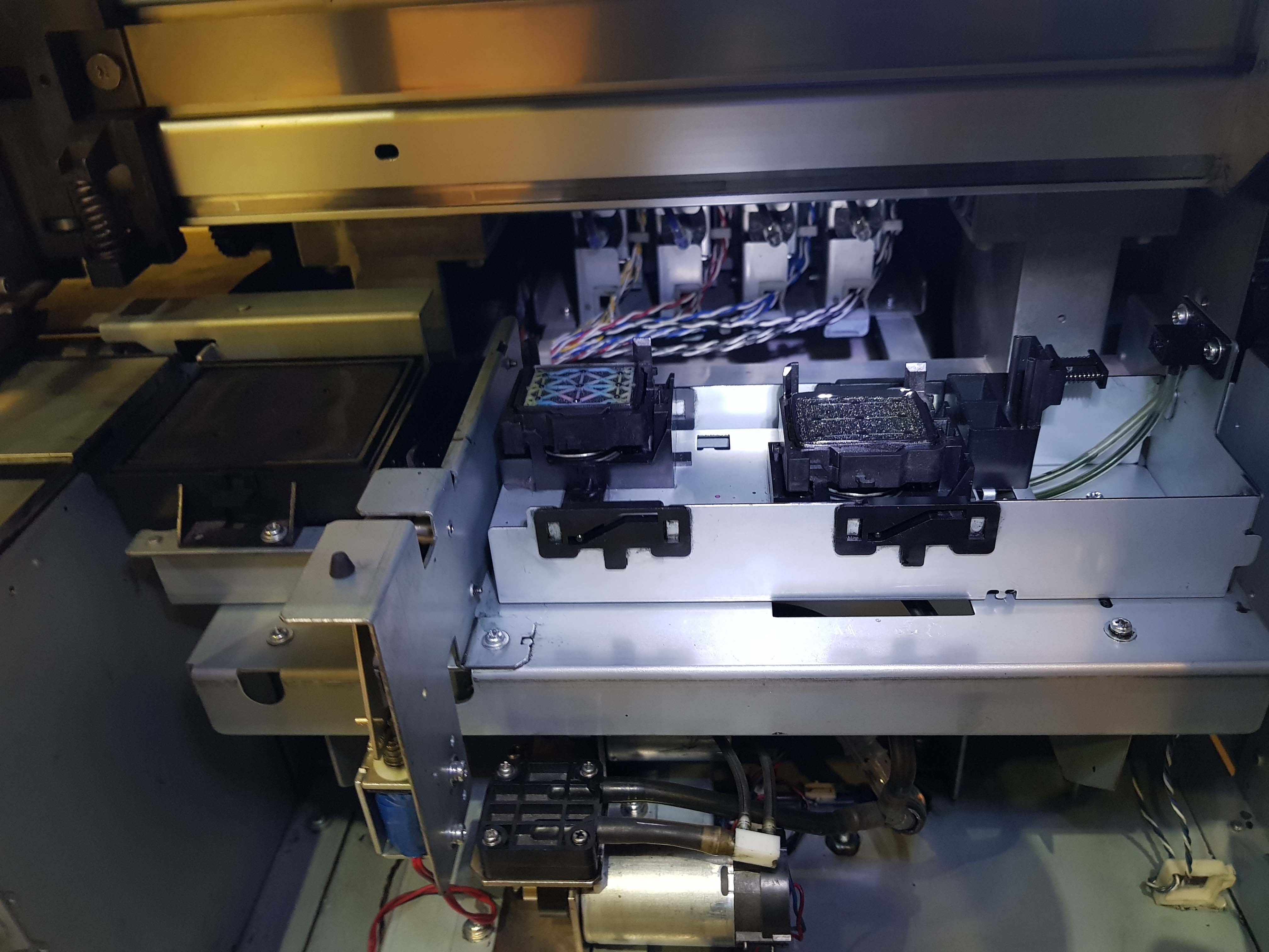

Change the maintenance station DG-43329 or pump hoses could be plugged.

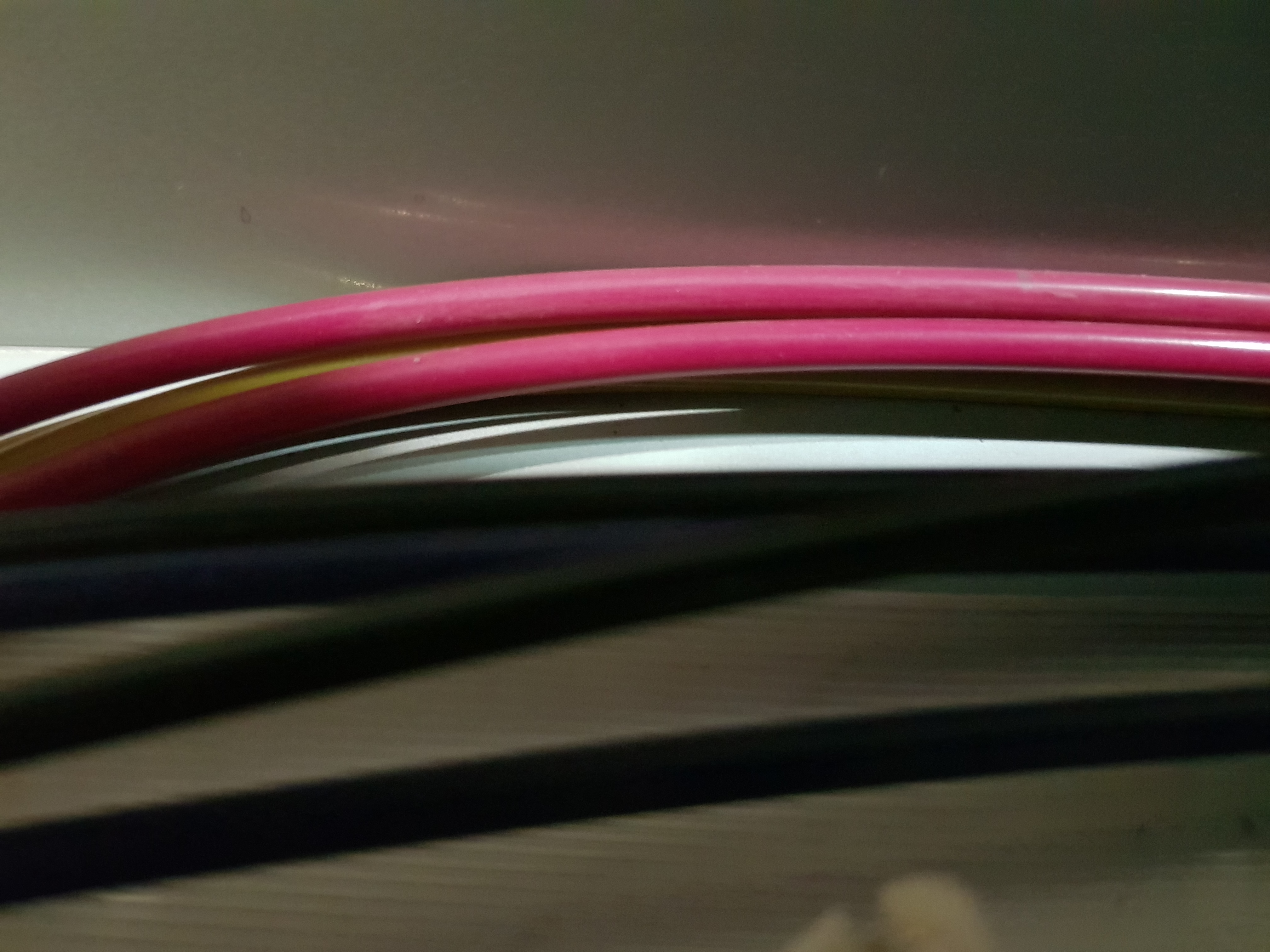

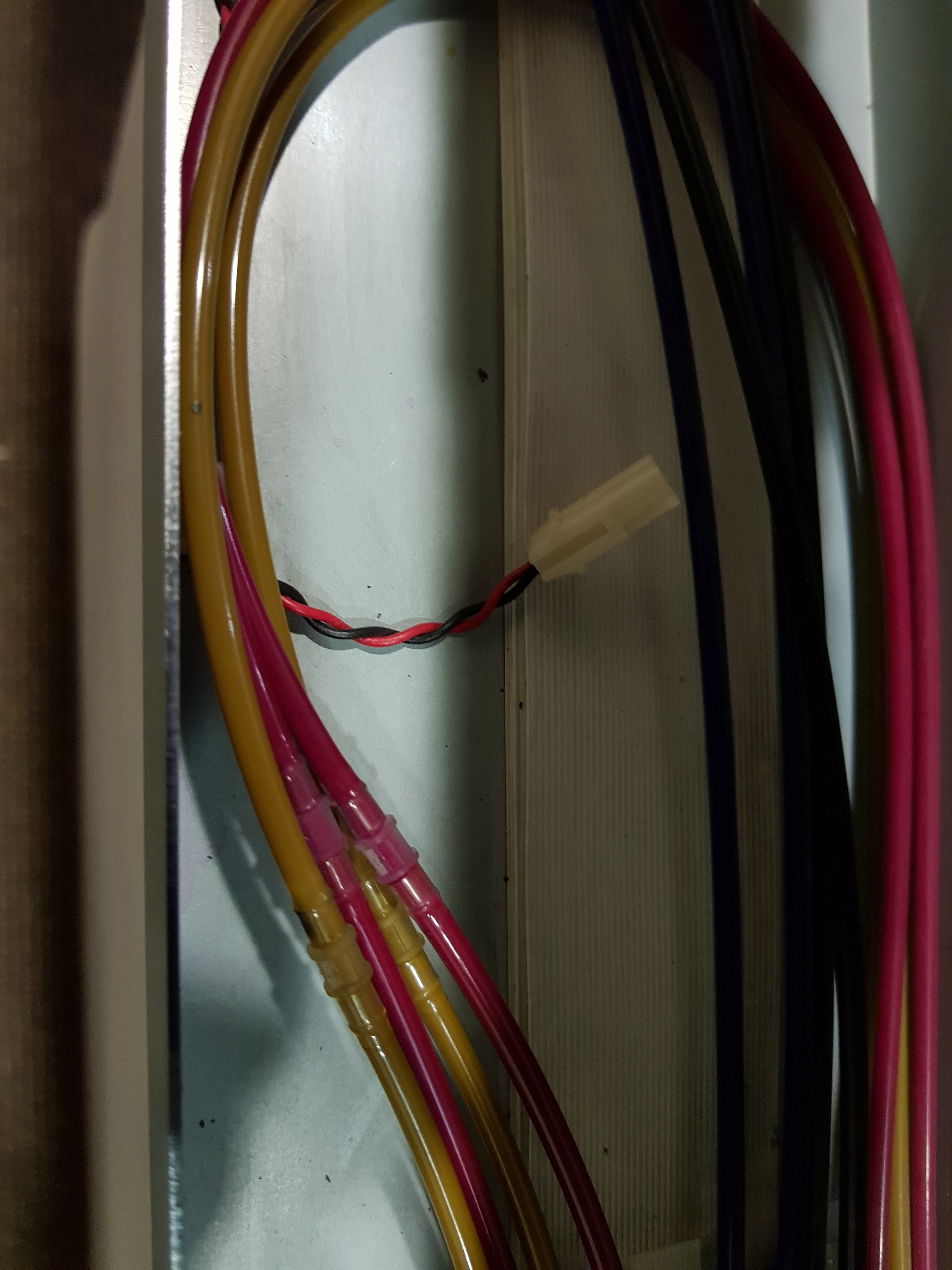

The only other issue I can think of is you are getting air in the magenta ink line. Replace O-rings. With ink valve closed pull on magenta ink line with a syringe. You should not be able to pull it with out it going back.

I tell you that I like to maintain the service station, such as cleaning hoses, obstructions, changing caps, I have three years with the machine and I do not change the service station only the caps, I read that it has to change every year, but it had not caused me problems.
I am very interested in proving that the magenta line does not leak air. but I did not understand (With ink valve closed) how is it closed? .
What I did was the back where the union of the hoses, remove the magenta ink because they think that it may be the quality of the ink and the part that comes from the heads I could only withdraw very little since it was generated empty and the syringe was returning..
