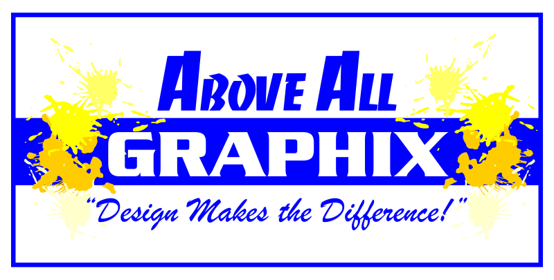

Help with this sign layout

These guys beat on this poor boy so much. A few people have given good constructive criticism. Honestly, before jumping into things, I would do some reading on logo types and other stuff as well. I see a lot of people on here that call themselves "designers." A few things that I do know. The human brain responds to serif text better than sans serif, because you grow up reading it in books all the time and seeing it everywhere. It helps with making out letters. Jills design is nice, however keep in mind, people also prefer to read dark/black text on white, not inverted. It's just not natural. The sizing of the text, you want it big, but you need the negative space around to make it stand out and be legible. Keep spacing between things that are different, like your slogan. If this is a sign, you only have a couple seconds to catch their attention...ditch the "and stuff" What is that? How is it relevant to your customer? Like someone else posted, don't do different messaging on both sides. As your company, your marketing materials should be consistant, otherwise you kill your brand. You appear scattered and you lose mind space with your customer. Colors/graphics should be put below text, just natural in the way a human reads, if you put lines and graphics above the text, by the time you get to that portion of text the persons eye is lost and starts to wondering. For height to width ratio when it comes to logo type, I would probably ditch the slogan all together. The most important thing when starting a logo... Design in black and white. If it works in black and white, it will work in color. Once you get a version nailed down in black and white, pick a color swatch that works with what you are going for. Blue being trustworthy - orange being fun - etc. That way the feeling and emotions can be drawn out in your logo. Really put some thought into it... Also, I know a lot of people are dogging on the name, and to me, I think it should maybe be re-thought. Think of a person that doesn't know your business driving by, they see the sign, when you think graphics people think design. A sign shop does signs, so when someone sees that and needs shirts, they may go straight to a screen printer to find out about getting shirts made, even before coming to you.
Just some things that went through my head when I saw your sign. If you want to design a logo, think of what your company is going to represent and try to illustrate that in a mark (this is what most people consider a "logo") that will become synonymous with your business.
What?
I have always been taught that light letters on a dark background are more legible, that's why I put GRAPHICS in a panel.

When looking at your design, thumbnail and large, what stands out is "all above" not the graphics portion, that kind of blends into the bar. It's just how the brain works. There's a lot of research documents that talk about this and what makes effective advertising. It's just when you are taught to read, it's always black on white, even on this website dark text on a light background. Websites, Print Ads, Billboards etc. have a lower success rate when they are black whit white text, even though you can't get more contrasty. I used to think the same thing, but, the research and studies show the opposite.

The study I read years ago did not specifically find that a reverse is more legible. It found that it appears 25% larger to the eye. But it also found that reading speed is 33% lower. Which makes a reverse good for things like phone numbers, single words and creating separation, but not so good for comprehension ... especially for drive by viewers and on vehicles.

How about something more like this
That's a pretty solid route. It would good for the OP to see that.
To the OP: Have you found anything that has caught your eye yet today? What works and what doesn't for you?
Also, in regards to the slogan, it might just be me, but I'm not crazy about places that advertise having "stuff". It is rather synonymous with junk, or at least something that will not appeal to me, if described more specifically. Is there a better word to describe what else you want to produce? What are other people's thoughts on that detail of services?

Gino, your points are valid, but in the examples of street signs, or ADA signs, it's based off the shapes and colors. These are more elementary than reading text. A stop sign is a big red octagon, yes it has text, but it's the shape/color combo that makes it what it is. A fire truck is a big red truck, now try reading the text on the truck of which fire department it came from. These things are like marks. Like I said before a mark will work, design in black and white, then add color to add that feeling of emotion and what it is about.
Back to signs with text, capital letters do not aid in the reading of text, it actually hinders the effectiveness of what you are trying to read and get across. Plus the jumping up and down in sizes if using caps and no caps creates a wander of the eye thus not fully paying attention or retaining the information.

I will also suggest to check out Graphic D-Signs' work. Their stuff is really clean, minimal with the info you need right there. Look at the fonts Dan uses, his color pallets and look how they work really well together.
I mainly wanted to give the OP things to think about other than just saying it sucks, start over and just throwing designs as to no reasoning why other than I think it looks better than his.

why? why put this out there when you admit you are no designer and are working with a real designer to develope a logo? why? did you think maybe it was great and we would tell you to forget the real designer? these kinds of posts just make me wonder
I put this on here BECAUSE I know I am not a designer. I wanted to see how far i was off. Sorry if I upset the balance of your day.

Seriously, how in the bloody hell can you, with a straight face, call yourself "Above All" with a tag line that reads "Design makes the Difference" when you cannot live up to those claims even when designing your own logo?
Hey, I may be "Sign Pro Plus" but my partner and myself have about 30 plus years of experience. What make you "Above All"?
First of all the name has a double meaning....I did mean for it to imply "above average" quality but also to refer to my Lord and Savior who came from "above." I never said I was better than you. I am quite sure I am not. But are you so insecure that you must blast somebody trying to market themselves?
Should I be forced to pass some litmus test in order to "prove" I am worthy of using those words in my business name?
Secondly...I've been in business long enough to know that design is what makes the difference. The materials that go into making a sign are basically all the same no matter where you buy your sign. But a good design versus a bad design makes all the difference in the world. I know the value of good designs...that is why I posted a "work in progress" in order to make a bad design into a good one.

Thank you for your kind comments. I am using two taglines because this would have been a double sided sign on a highway. I wanted to catch people going both ways with different messages.
Then at this point you guys lose me with the talk about background colors, reverse panels and such.....

The "stuff" in my tagline is supposed to refer to promotional items such as business cards, ink pens and other imprintable stuff like that. I feel that using promotional items is a touch wieldy for a sign.
