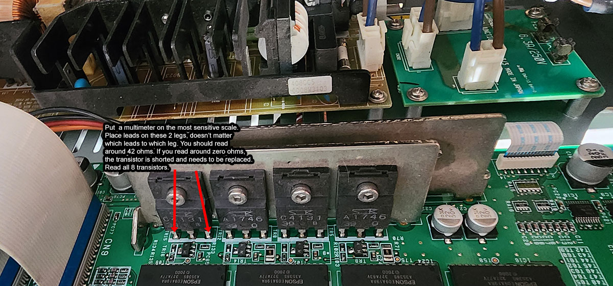

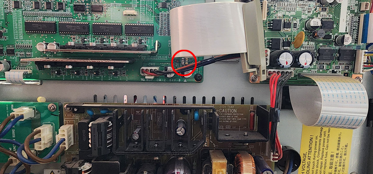

Did you check the correct fuse? It is the small one mounted on the mainboard, not the ones to the main power supply. If this is ok, also test the transistors. It could also be a bad head carriage board. When you do a head cleaning are you getting black ink coming out into the waste bottle?

These might help... The multimeter needs to be on the ohms section.

Jim Hancock, I just got back from traveling, thank you for your tip. I checked my fuse with my multimeter and the f3 fuse is bad. I will attempt to put an inline glass fuse on the existing fuse. I hope that works, I have not found a video of someone doing that as of yet.

Hello damonCA21, I found that my f3 fuse is bad. I did test all of the transistors and they are all good. Thank you for your tip.

Another option is to solder the correct new fuse on top of the old one without removing it. Removing and replacing the old fuse is difficult to access without accidently touching the hot iron to surrounding components, especially the connectors.

You can solder it onto the old fuse but it is a bit of a bodge. It is also quite hard to do this as the area you are soldering onto is very small and quite hard to access with the old fuse sill in place. It is possible though if you have an iron with a very small tip and are very careful
You also need to make sure that when the old fuse blew it didn't damage any of the tracks from the fuse pads, otherwise it won't make a connection to the rest of the board.
Removing the old fuse gives you a nice large pad to solder the wires for the fuse holder onto.

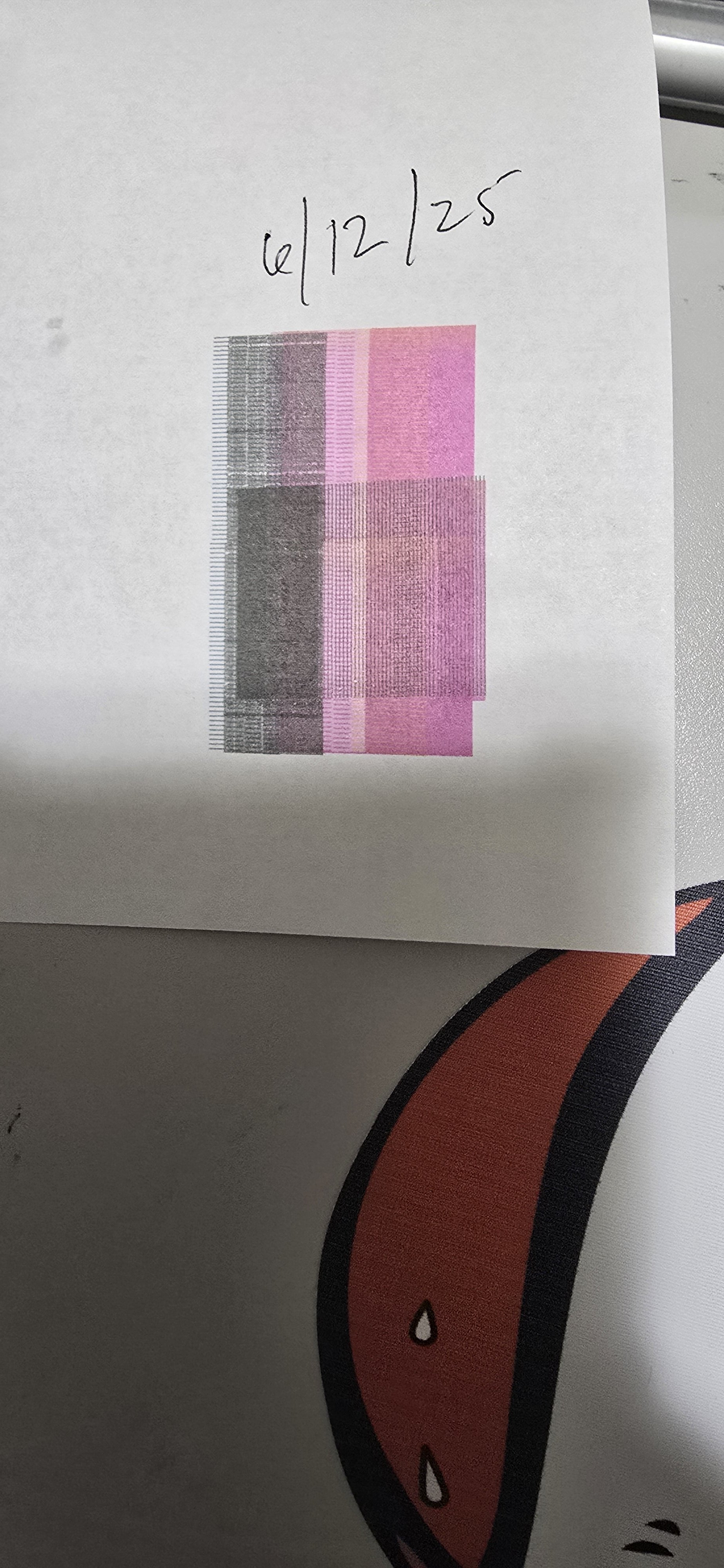

Hello everyone, Thank you for the tip on soldering the 1.6a fuse on top of the f3 fuse on my Roland versacamm sp-300v. I successfully done that and now have color coming back. However, this pic below is how my test print came out. I've done a few cleanings, don't know what to do next. Can someone please advise, I greatly appreciate it.

There doesn't appear to be a photo. Could you repost please?
