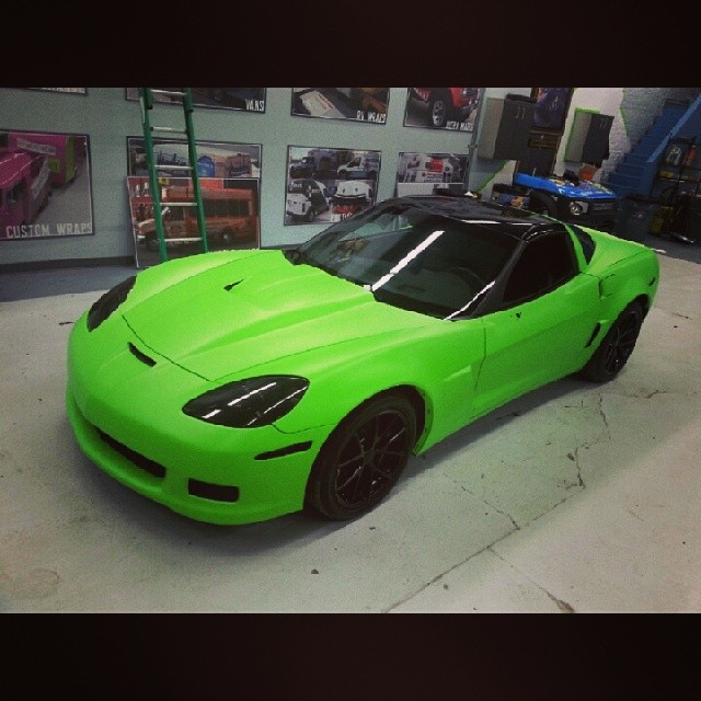

I recently wrapped a Corvette in their HX30000 matte green. I'd never used Hexis, but the customer liked their color best (yes, I told him I couldn't personally vouch for their product from experience).
Impressions:
CONS:
The HX30000 matte is thick- like bullet-proof thick, stiff, rigid. (they apparently do make the matte colors in HX20000 which is a more normal 3-mil). It takes a lot of heat to do anything with it. The material really "fights back", but it will ultimately conform.
The adhesive is aggressive. Really. This is not "pressure activated", there is no "slideability"- it sticks on contact, like regular cast vinyl. It is repositionable, but you really have to rip it back up violently, even if no pressure has been applied.
It does have very effective air egress properties, which good installers typically barely need- but you will need it with this stuff. Again, it really sticks NOW.
I found that installing this stuff took me back to the bad-old-days of inexperience- carefully working little sections at a time, using lots of heat, relying on air egress to remove bubbles, constantly pulling the film back up, etc. Forget about just peeling a whole 48" x 60" panel flopping it down, pulling it tight and being 90% there.
PROS:
Looks great. Very even finish - no stress marks, no little adhesive lines under the film, perfect color consistency even in areas that push the envelope for stretch. I imagine that's the advantage of a super-thick film- there was truly no detectable fade (neon green film, clear adhesive, black car) when stretched. Thick, even, clean look- better than paint.
Great technical support. I struggled a bit to figure-out how to manage the top corners of the back bumper (Corvettes make a hard three-way transition) with such a stiff film without overstretching (I had it down, but I could just tell I'd pushed it too far to hold-up over time). Their technical guy was totally familiar with the exact bumper, acknowledged that this material would require a less stretch intensive approach, and had a perfectly workable solution. Thanks Albert.
Overall, it made the job a lot harder and more time-consuming, but it does look really good, and the customer was thrilled.

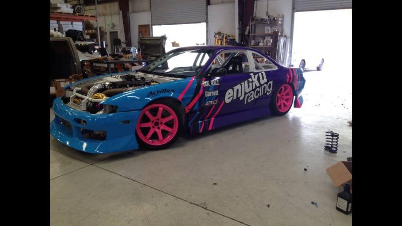

I just finished wrapping a car in Hexis Amazon Purple hx3000 series, absolutely hated it. I've used a lot of the 2000 series and it has been a hit or miss relationship for me. their Red + Emerald green + Blacks have laid down fantastic, Pull up really well as well. Durability and life were great.Their hx2000 white I HATED it was like wrapping with a walmart grocery bag.
The issue I had with the 30 series is it would not stay put even in body lines that were minimal EVEN with bridging. The vehicle we wrapped was a pro drift 240sx car with aero and all that nonsense. The door on the s14 240sx has a hard line that goes horizontally. Its a tiny little dip, But I've made it habit to always work it into the lip and then continue on takes equal time as bridging does.....well it kept coming loose, so I pulled up the door figured maybe it had some oils or something on the back, re did the door same thing (yes i post heated in both situations let it cool / set moved on to other parts of the car kept coming back and it'd never stay). Ended up making a score on the upper side of the lip so you could not see this cut and that allowed it to lay down easier.
The materials LOOK amazing, They install pretty well... it is tackier than 3m/avery like you said but doesn't bother me any more after using it several times.Oh almost forgot, The top laminate they use in their 3layer system blows. Just the friction from a geekwraps squeegee can break the top coat....even without heat... I talked to my Jax rep about it but ended up not really combating it because I don't plan on using hx3000 series at all anymore unless the client MUST have it.
Hx3000 purple + Avery Light blue / Avery Matte black + FL. Pink
Kids 18 years old....1 year of experience and already on a pro level for drifting. 768 whp 900lbs of torque on 8lbs of boost turbo ls3

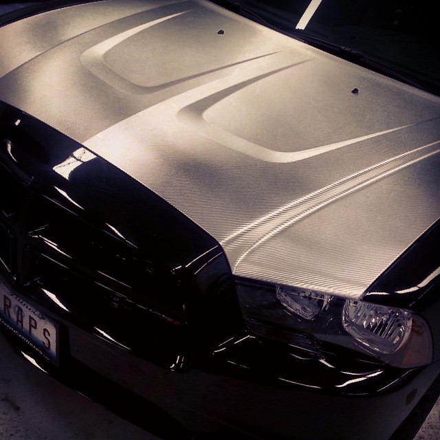

I did another job in Hexis 30000 today- silver metallic carbon fiber hood on a Dodge Charger. The material looks great. It was somewhat difficult to work with, but about what you might expect for a textured metallic.
