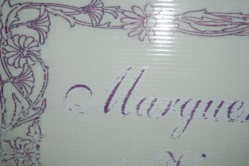

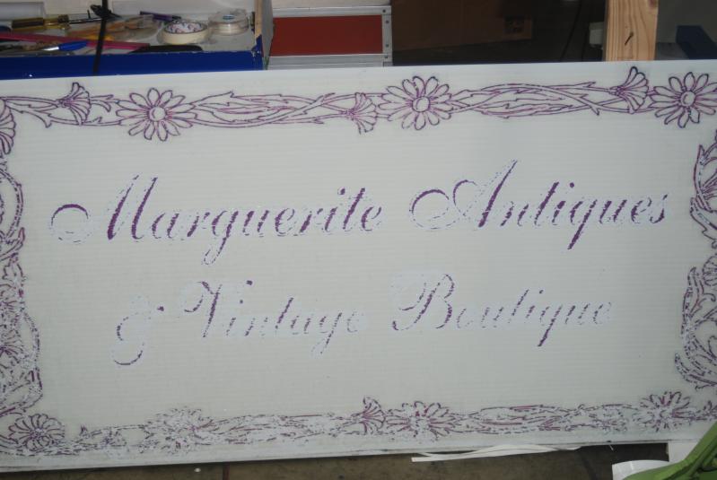

Hey why is this sign falling apart?
I believe it is only 2 years old...we had to sub it out before I came here and got the solvent printer.
I'm guessing its UV printed...we were thinking about getting a UV flatbed but this is making us second guess that decision. But then again I hear UV inks are getting better and some inks were just crap.
It is flaking off.
Please disregard the terrible graphic.

This was before I got here..so there's not too much I know about it other than it was sent out...It looks like there is a clear coat over it...My first thought was frog juice but then thought about that varnish option printers have these days.
So if this was on aluma-core or something it wouldn't be flaking like this?

can you pull up the records on this to see what was quoted. in the quote there should be details of how they made this. I sub out to a company that has printed our alumalite and dibond. it has a UV clear coat and we have stuff out there that's been outside for many years and still looks great. not sure with any of the coroplast as it is short term use and I haven't seen anyone use it for long term.
omgsideburns
What the hell was sprayed over it? That might have eaten it away.. I've never seen anything like that with the UV machine I run. Maybe it wasn't cured properly?
Who knows these guys we used before were not the highest quality by a wide margin...For all I know the customer thought it would be a good idea to coat it with something.
Looking closer at it..all the screw holes don't have the varnish around where a head of a screw would go...I think customer screwed up..slathered it with some crap after mounting it.

This is one of the weakness of UV ink. The ink just sit on top of the media and is not flexible as the coroplast which is very sensitive to temperature if place outside. When shopping for a UV printer you have to do a scratched test (see 3M site for how-to). As far as I know Agfa has the ink that the work very well with coroplast but you will trade off with low gammut color.

I have found that coro printed on our flatbed starts to go to crap after two years, but on polymetal it holds up very well with UV clear on top. I don't consider coro worth the extra cost of using a clear. Coro by it's very nature is intended as a cheap, short term solution. If the client wants long term durability then they need to pony up and pay for better materials.
