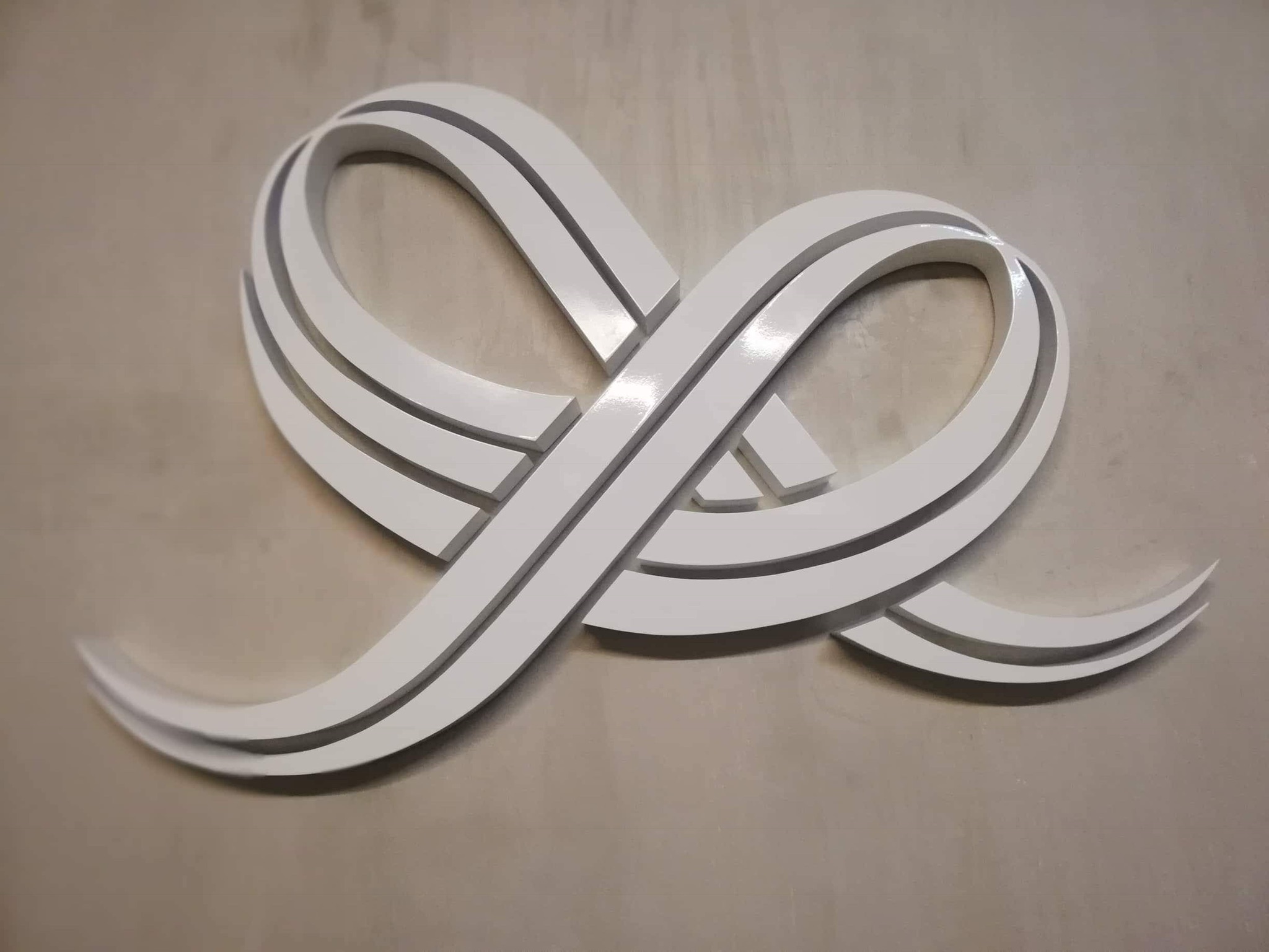

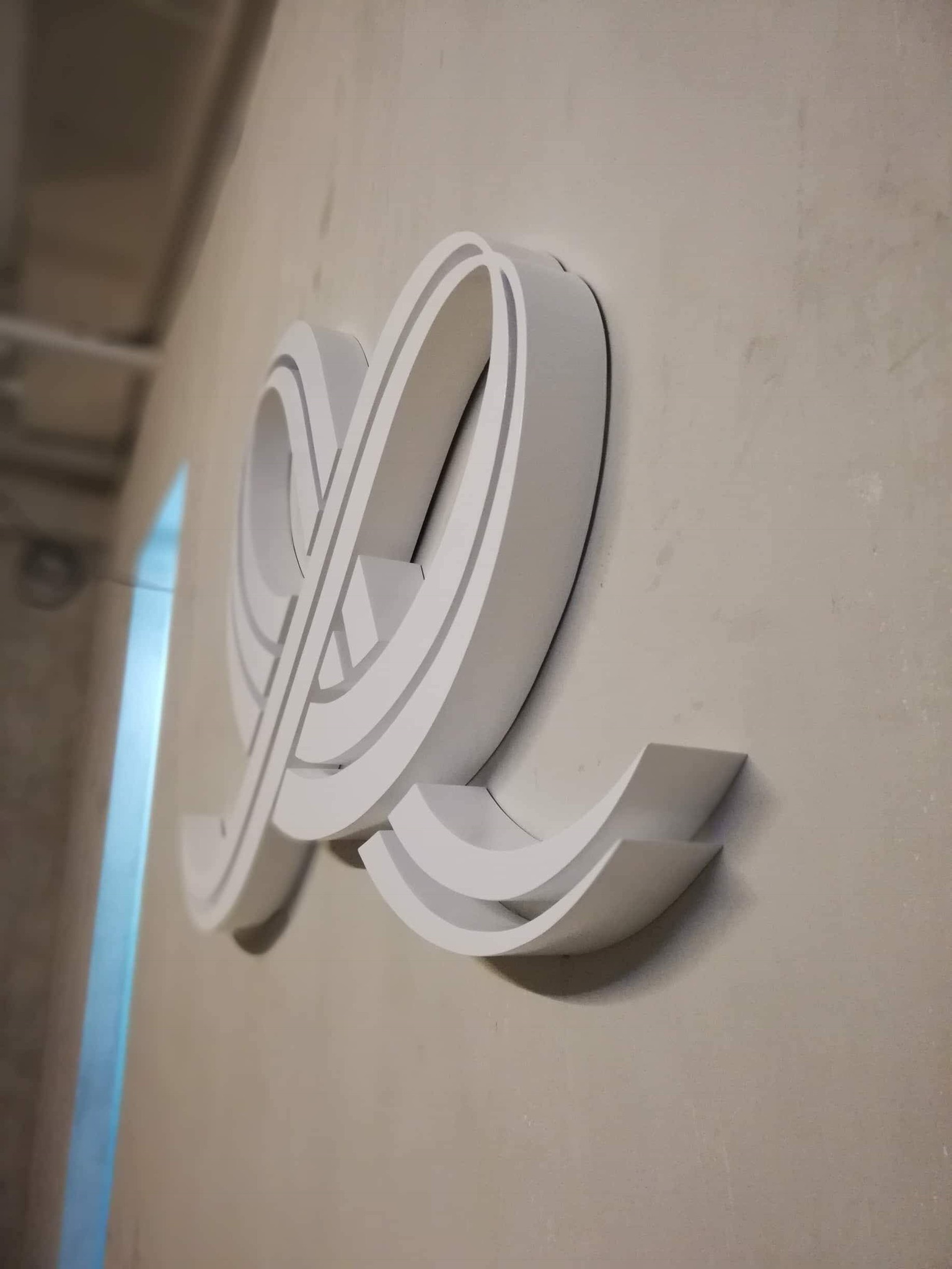

player - I guess the sign trick I can share is regarding non-lighted signage build up, We always use painted G.I. sheet as our main choice of material instead of wood, the result of finish painted G.I. sheet is really good and it is budget friendly. Please see attached sample of our works, (@admin - hopefully it is ok to post some of our works) The soldering works is done by manually placing nikolite leads on the edges with the help of our custom made soldering iron. For the software, We use AI and Autocad for the design and shop drawing. Btw, as a short background, I was a Technical Drafter from an Industrial Company before here in the Philippines, so jumping to signage design is quite a breeze since I have the experience using CAD program (2D/3D drawings) which I always find useful. Shop draw is always helpful to us. For the printers, As of now We outsource our plotting and decal needs, since we are just a startup company, but we are considering getting a mimaki cutter plottter and a decent large format printer soon. For our laser cutting needs is also outsource but hopefully one day We can afford to get all the sign making tools available for us. Regards from the Philippines. Cheers

It just happens that whenever we have clients looking for non lighted build up We normally recommend
painted G.I. sheet because we find it very straight forward working with G.I. sheet either manually jigsaw
or via laser cut (outsource) and the durability is great. For other signs, We usually work with the most common material which is acrylic & sintra boards but still in the end its still the clients specs / requirements to meet.
