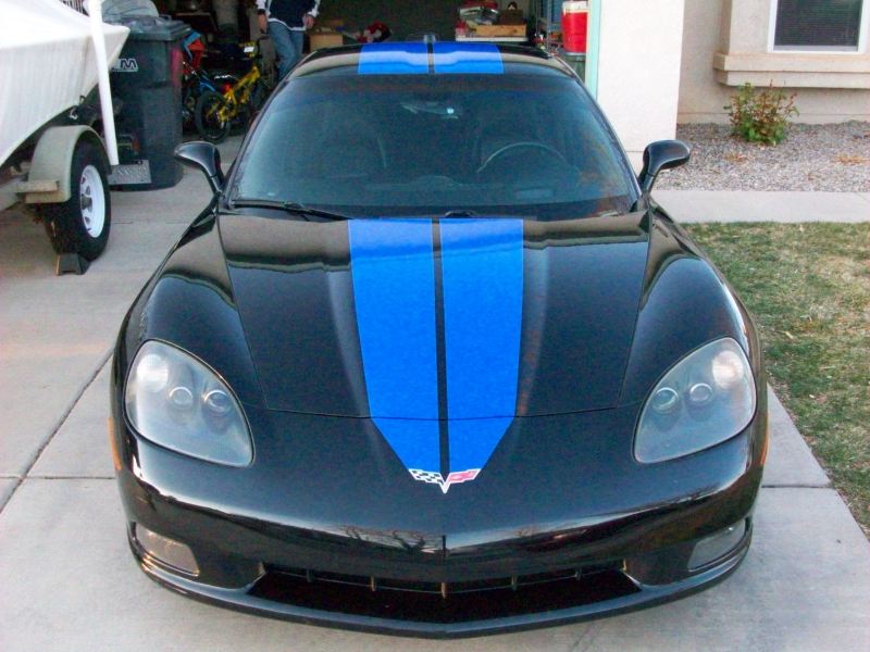

if you are talking about custom designs or stripes on the hood using knifeless tape, then yes. some are doing them. not necessarily using 3m 1080 though. as for pricing, i just price things as i normally would and add cost + markup for the knifeless tape.
here is a vette i just did with knifeless tape.
another hood design i did with knifeless tape.

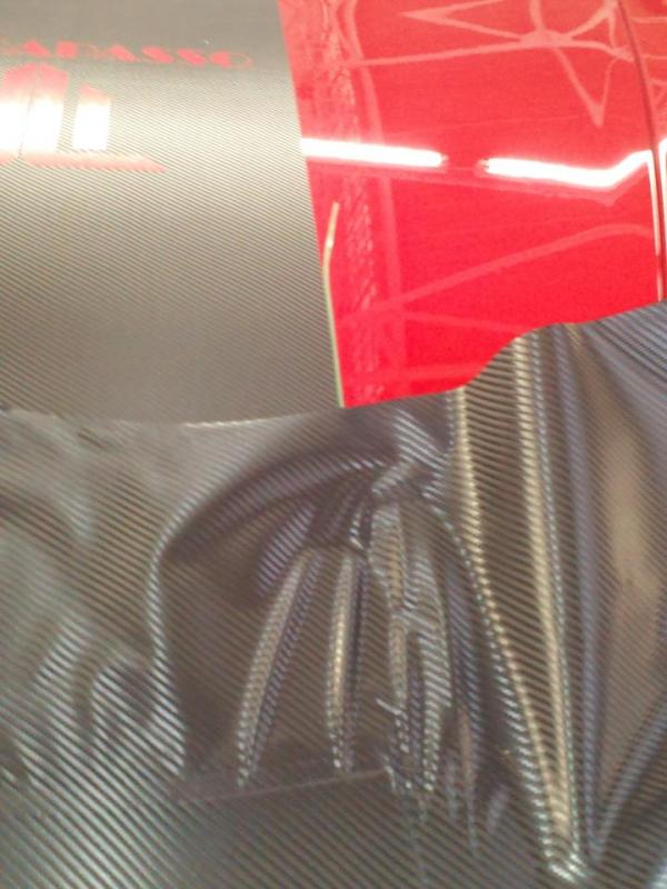

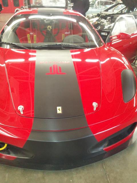

Knifeless tape is an awsome product.Bit of a small learning curve but when you get the hang of it works wonders.
Here are two images of us using the product and the after results. We are featured on their website http://www.knifelesstechsystems.com/Home.aspx
love knife less tape its great def a trick to it just mess with it a few times on some scrap find the right speed and angle to cut down on the sawtoothing but once you figure it out it can really help you out...good luck!

We used the 1080 Carbon Fiber as you see in the pic.The price was substantially higher than what you mentioned in your post.I would say that you are definitely on the cheap side there.
