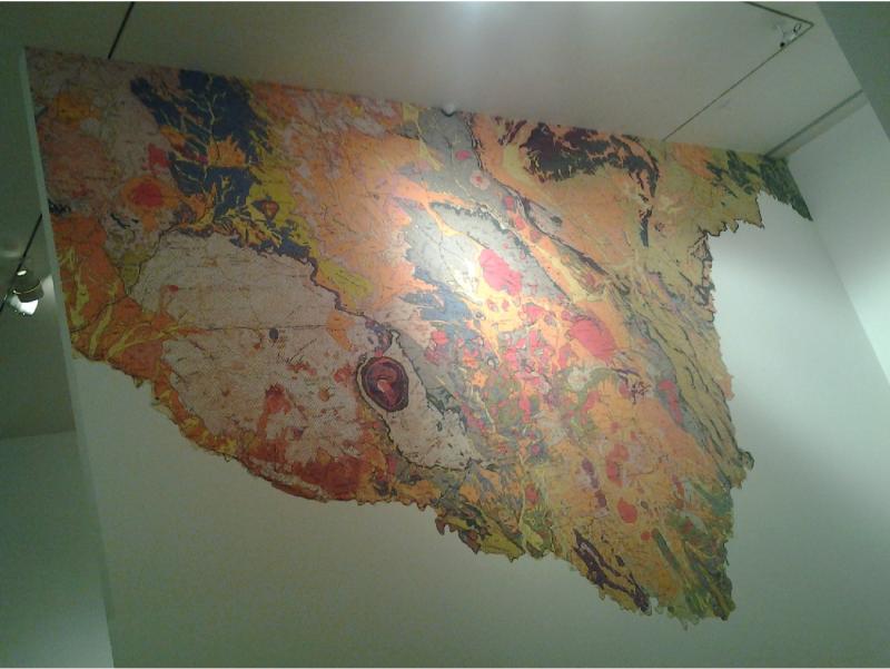

awesome advice i put to work on this 17' x 26' photo tex print & install.
thanks for your help insignia!
