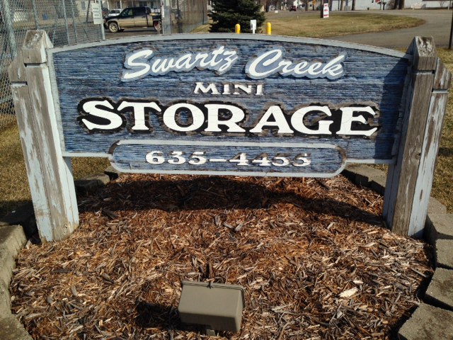

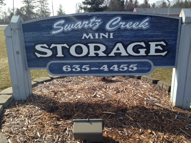

Hello everyone, I will be restoring an 18 yr old redwood carved sign this spring. The sign is painted. Some of the text is vinyl applied over the paint. I am trying to figure out how to duplicate the existing layout so that I can cut the replacement vinyl. Isnt there a way to import a picture along with some measurements and CorelDraw x4 will scale the text and layout for me? Could someone give me directions on how to do this or point me in the right direction? Thanks in advance for your help.

I appreciate the input from everyone. I may end up hand painting the text, but I am going to TRY to scale the vinyl properly first. The text on the sign has a painted background with smaller text made of vinyl applied to the painted background. Again, thanks for taking the time to help out us newbies
