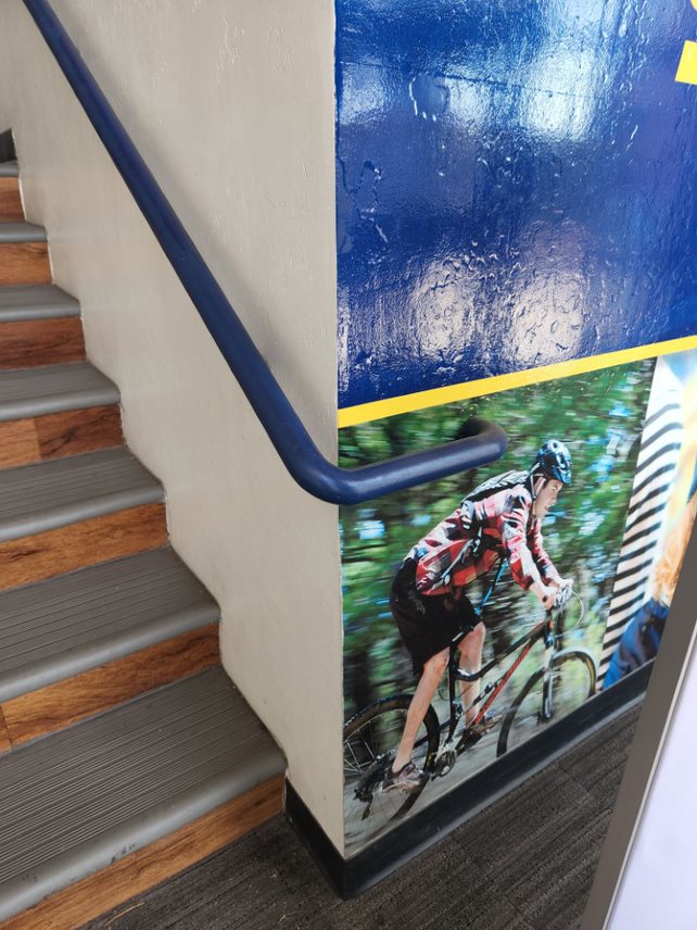

Can anyone give me any insight into how I would go about wrapping graphics on this wall? I haven't run into this situation before, so I'm curious if anyone else has installed in a similar space, and if you can give me any tips/tricks/pointers. it would be greatly appreciated! Thanks in advance!
to clarify, we're re-wrapping the blue wall, not the wall that goes up the stairs, so it's just the bottom of the railing where it wraps around the corner that I'm concerned about

Could slit it horizontally so the seam is behind the rail. The only one who will see it is you, and us here if you post the finished wall. With it so near the top of the graphic, a short vertical seam would be just as good.

I was going to say the same thing. Cut it at the rail and have a horizontal seam. Tell the customer there will be a seam there so they don't nit pick.
