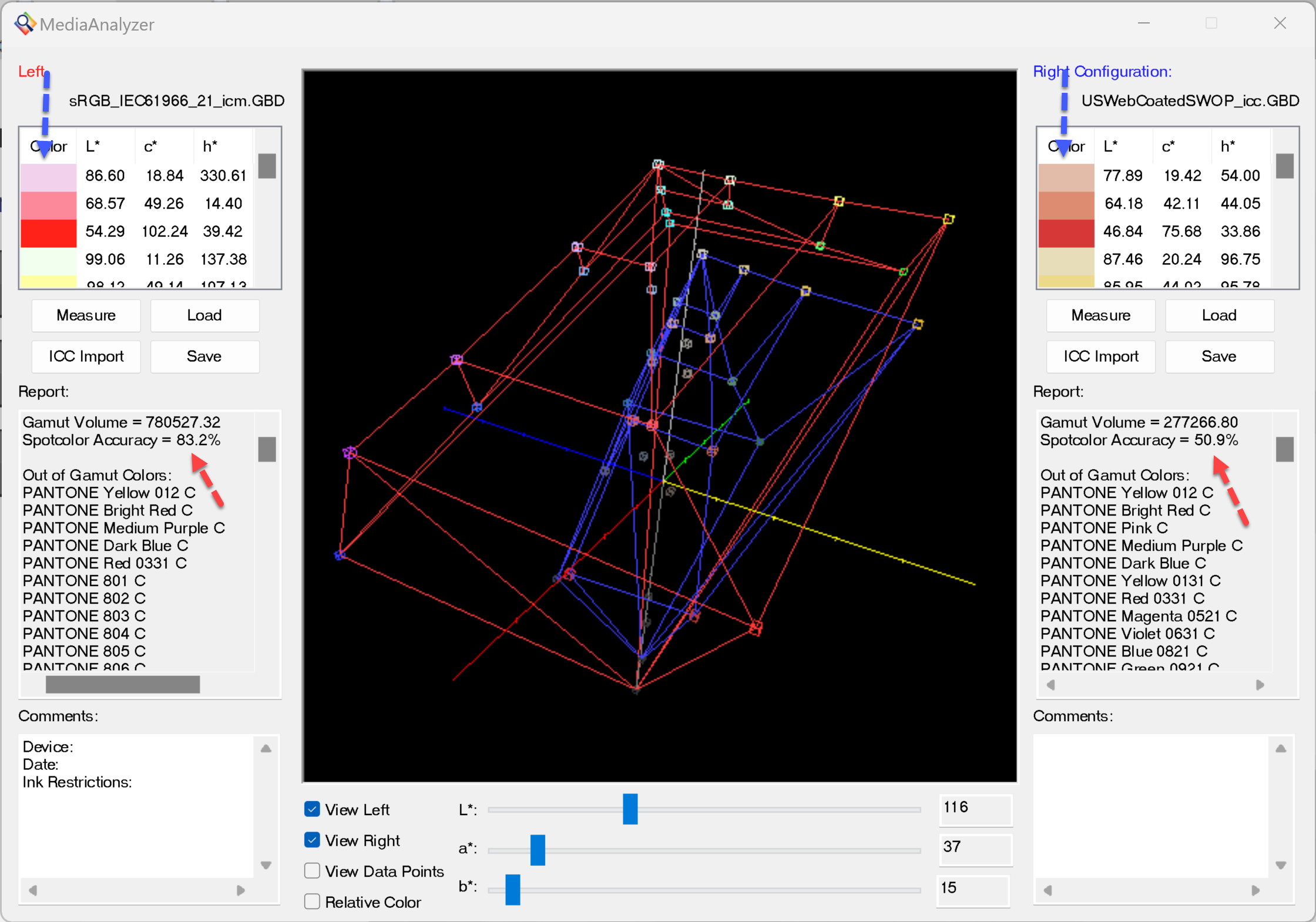

ONYXtechtips
Here is Gracol2013 compared with USWebCoated

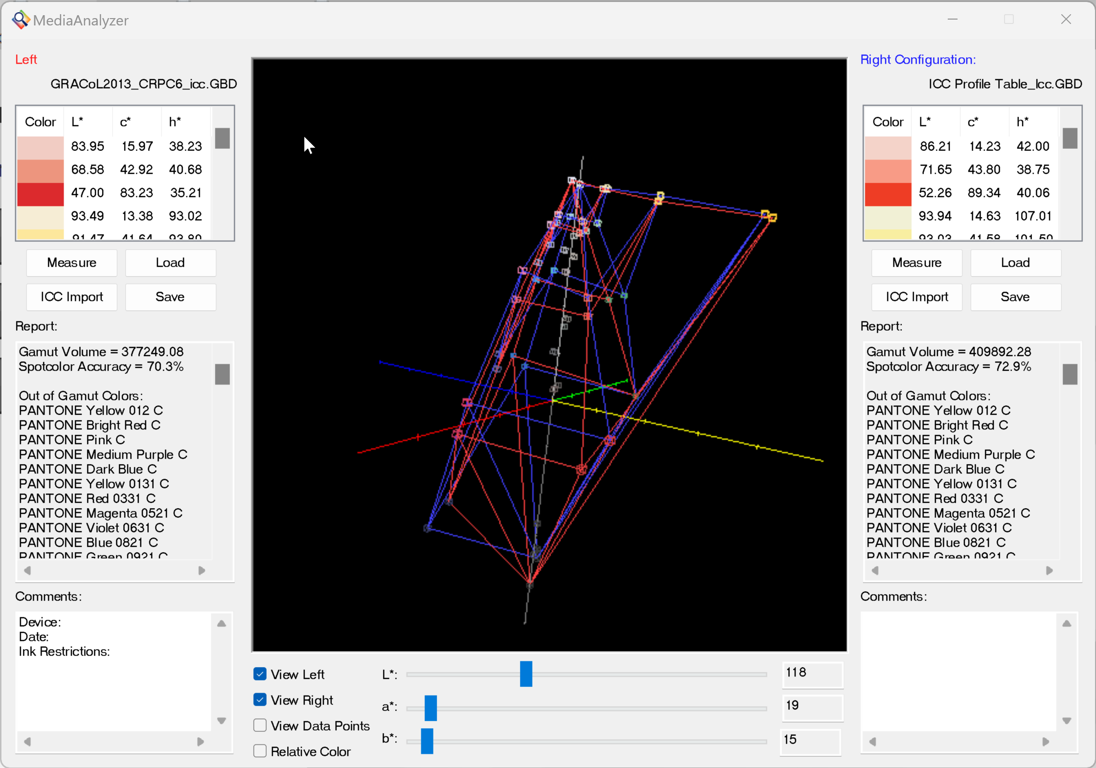

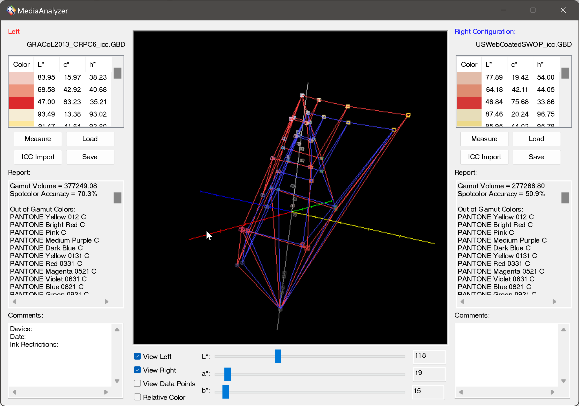

ONYXtechtips
Last one, I promise. Just geeking out a little. Here is a comparison of Gracol2013 to a standard middle range mode CMYK printing device. Notice how close they are to each other. This will reduce the possibilities of error, but may not deliver the specific saturation or vibrancy you are looking for. We have a variety of tools to help with that but that is for another time.

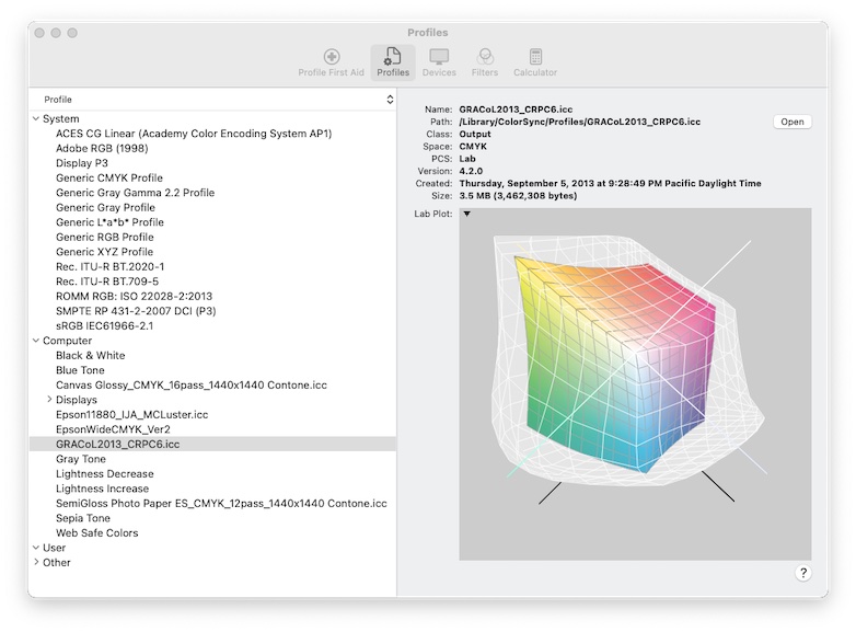

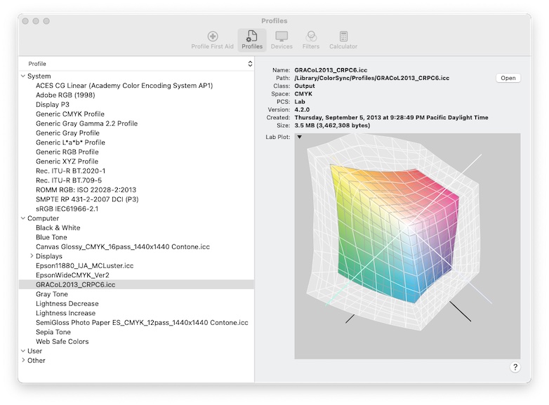

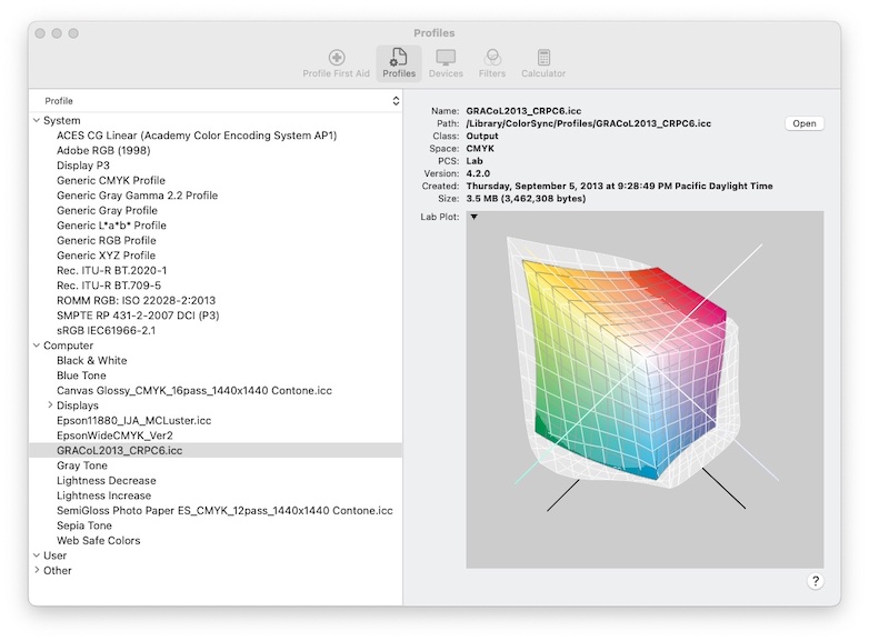

Some more examples...
... 1) GRACoL2013 inside an Epson CMYK ink set machine, 2) GRACoL2013 inside an Epson 11880 ink set, 3) GRACoL2013 inside the EpsonWideCMYK_Ver2 working color space.
What I'm getting at is, regardless of any very small or very significant differences in color spaces AND rendering intents, neutrals especially should not change. Why would they? A neutral is supposed to be just that; neutral. Color spaces (well made) and rendering intents mostly effect the edges of the spectrum. Much like language translation changing words or pronunciation to result in the same meaning, number values provided by ICC profiles are meant to be interpreted by the color engine to result in a color match or to be as close as possible for the process to allow.

:) Well, the renderings I've posted above are from Apple's ColorSync utility software installed on Macs since the late 1990s, if I recall.
As far as what you two are discussing, it's all greek to me
No worries.
In the renderings, the GRACoL_2013 color shape represents the color gamut of many well behaved 4 color printing presses around the world. It's basically a standard, targeted goal. Using certain CMYK values, especially for gray scales and edge colors, one can rely upon getting the colors and tonality they expect if all things are aligned. In other words, input values will match output expectations.
The larger gray wireframe shapes from their corresponding printer profiles represent their specific printer / ink / media combination color gamut. The shapes merely show more vivid colors are available beyond that of the typical GRACoL CMYK printing press. The main contributor for this happens to be the ink set in these machines.
Something to note by attention to the 6 outermost color points of the renders. 100% of, say, yellow ink using the GRACoL space, will not be as vivid as 100% of yellow ink using the Epson 11880 printer / ink / media combination. Many times these effects go unnoticed, but again oftentimes, they are noticed but the remedy should not be so mysterious and elusive as they usually are.
