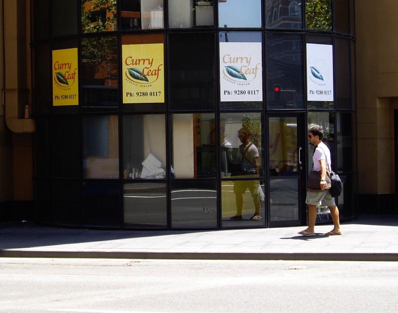

I used this pic on my site to explain the effects of UV light on digital prints.
All printed at the same time I guess, the ones to the right copped more sunlight than the others.

That is great pic for that! Can I steal it? (But what does it have to do with the vinyl question?)
I would like to know if YOU know for sure if this photo has been tampered with, because there are a lot of discrepancies here.
Generally red/magenta will fade or shift color first. In your sample here the pictures receiving the least amount of sun seem to be the ones that have shifted the least while those getting the most sun have changed dramatically. However, since the redness left the lettering portion…. why do you suppose the yellow is what is not lasting on the sunniest prints ?? Not to mention, if the yellow faded out of the last two prints…. how is it the yellow remained in the copy, but not the background ?? Oh yeah, and the yellow remained in the green leaf. How do you think that happened ?? I don’t know about ‘Down Under’ but around here color shift generally means that a color will be sucked out at the same rate across an entire print. When comparing that to paint or die cut vinyl, it will shift at various rates due to the nature of different elements comprising the different mediums.
That print looks mighty suspicious to me. :noway:

II Jake - sure use it if you want.
Gino - I took the photo myself. Went past that shop every day for a couple of years and only took the pic a month before they finally reprinted the signs. It is what it is despite your suspicions. Nice theory though.
A post in another thread had yellow problems on trash can decals that faded to nothing. Any idea on the tme frame that those signs were up, to when the color faded?
