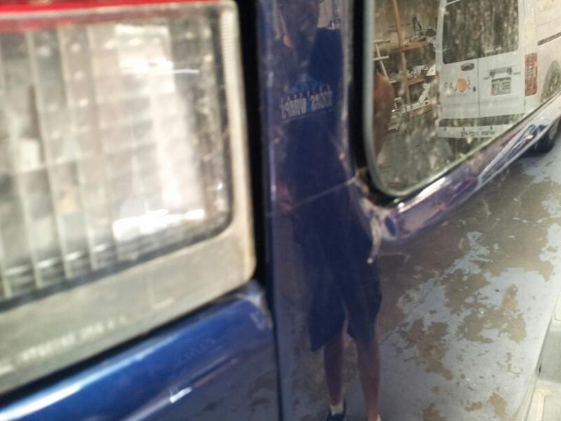

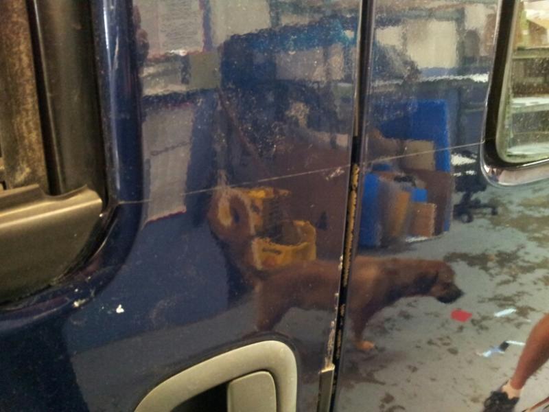

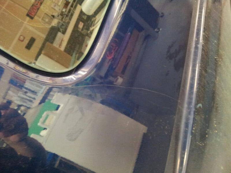

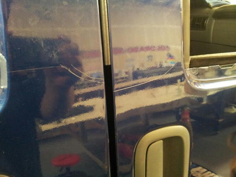

We're redoing quit a few wraps for a company that wasn't happy with the previous company they were using. We removed the original wrap on the first vehicle which showed some pretty deep cut marks from where they trimmed. It seems to be a rising problem in this area. Every time we remove a wrap another shop does, we run across this. So from 1 professional to the another.. avoid this, and avoid a very angry customer.

Holy crap! I though that was the wrap at first, then I realized it's the freaking paint. I love all the noob shops who think they can just buy a printer and start selling wraps.

Yup the paint.

no kidding. They're deep.. i mean, one needs to be filled it's so deep.

Becareful when filling it in. You are probably going to come across the tip of the blades!
