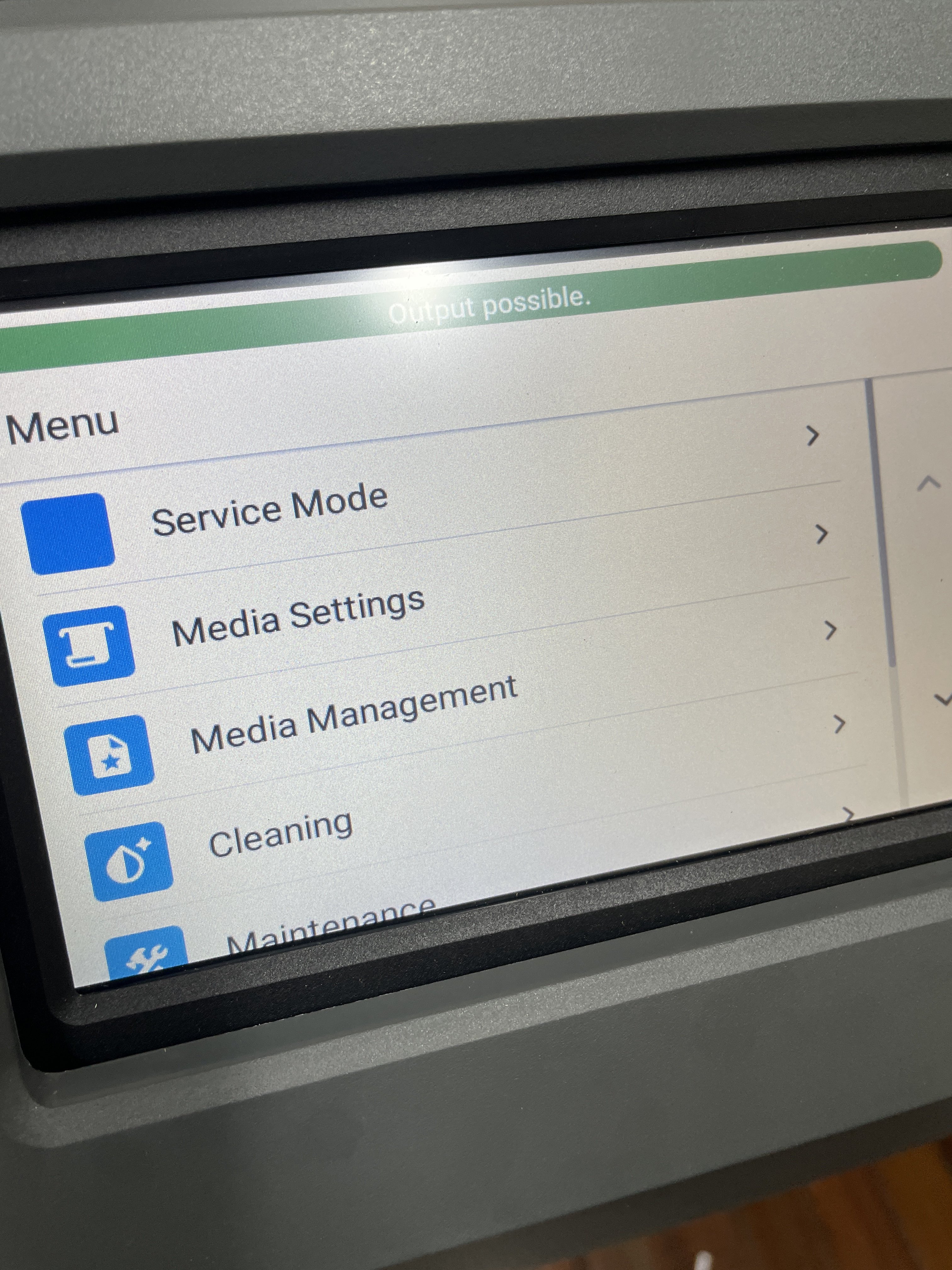

Recently Roland LG Truevis installed by my tech, but it is stuck in service mode. Can anyone assist with exiting service mode? Power on and off with switch doesn't work.

I’d take that as a blessing, unless modern service mode causes features to go away.

Suggest turning the printer off with both power switches and unplug for 15 minutes. Restatrt and see if that does the trick...

Update from the tech is that the machine always has SERVICE MODE available. The auto-maintenance / cleaning on the LG640 is quite regular also - every time you power on there is a cleaning and you should shake white ink daily.
Power on and off clears service mode.
